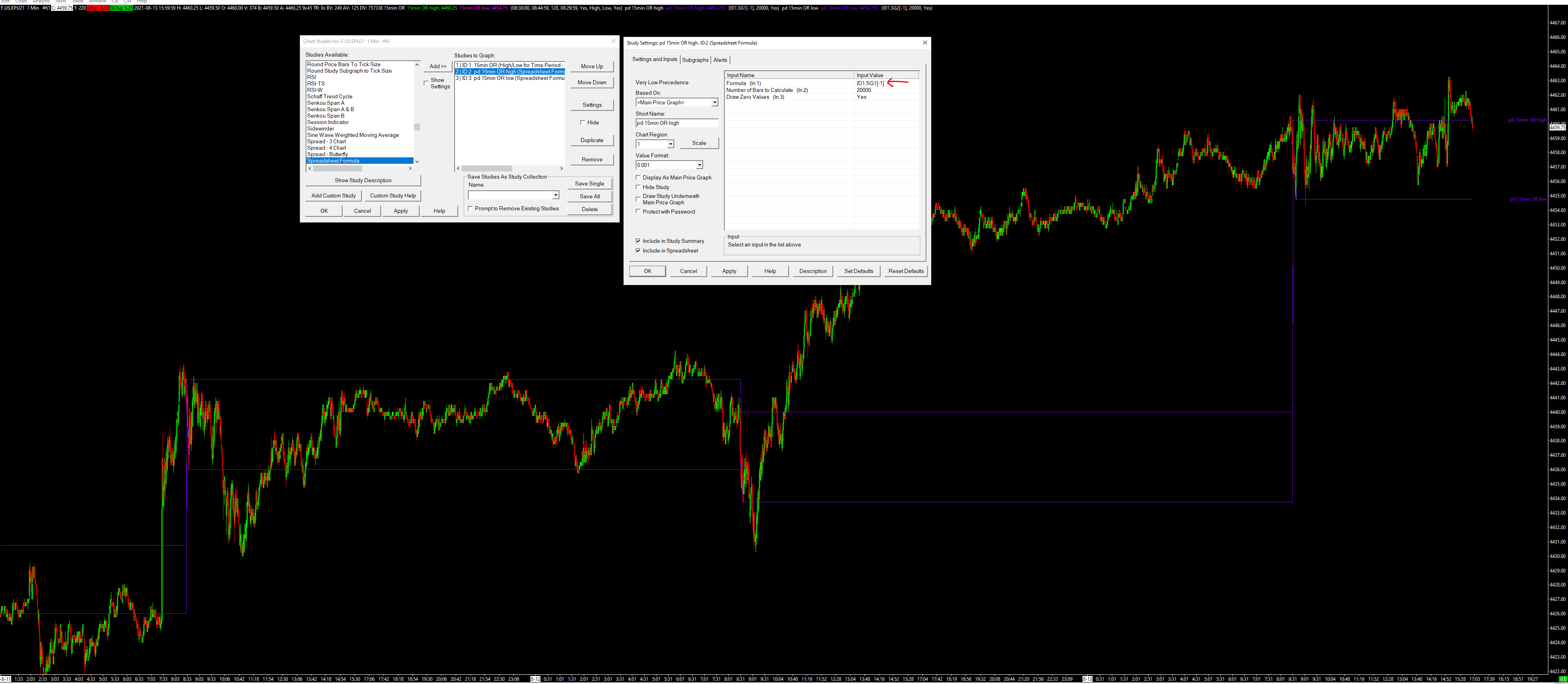

User811622 - Posts: 38
I tried using spreadsheet formula indicator to plot previous day's 15min Opening Range onto current day, but doesn't seem to work. I have attached picture of my settings.
My the setup, I use High/Low for time period extended indicator. 15min Opening Range is ID1 with high being ID1.SG1 and ID1.SG2 as low. For previous day's level, I added in two spreadsheet formula indicator. The first spreadsheet formula I entered in ID1.SG1[-1] for previous day 15min OR high. The 2nd spreadsheet formula I entered in ID1.SG2[-1] for previous day 15min OR low. This plot but it plots on the current day's 15min OR. Please advice.

[2021-08-16 15:56:00]
John - SC Support - Posts: 48434
You can do it the way you are, but you need to set the offset to a value that moves you into the previous day. Since you are using 1 minute bars, this would mean that the number between the square brackets should be at least -1440. So your formula would be ID1.SG1[-1440].
1440 is the number of minutes in one day. As long as you are not showing the Developing High/Low, then you should be fine using this number even though there may not be a full 24 hours of trading information.
We are not really sure where the 15 minutes comes into play, as you are using 1 minute bars, but if this were a 15 minute chart then the offset would be -96 (24 * 4).
