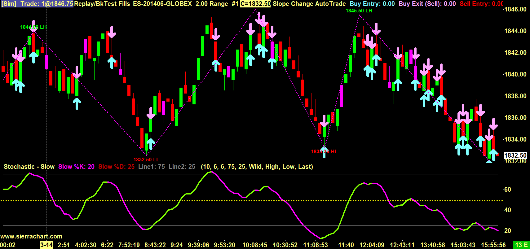

[2014-03-15 12:04:30]
Litz - Posts: 135
Well, it does generate buys but immediate exits
http://www.sierrachart.com/image.php?l=139488572784.png
BTW, appreciate your input, website, and you dedication to SC
Date Time Of Last Edit: 2014-03-15 12:15:52
[2014-03-15 14:16:32]
Sawtooth - Posts: 4354
I would use a formula like this for signals at changes in the direction of slope:
K3:
=AND(AB5>AB4,AB3>AB4)
M3:
=AND(AB5<AB4,AB3<AB4)
If you want to always be in a position, leave L3 and N3 blank and set Support Reversals to Yes. However, this is not likely to be profitable so the conditions will need to be more sophisticated.

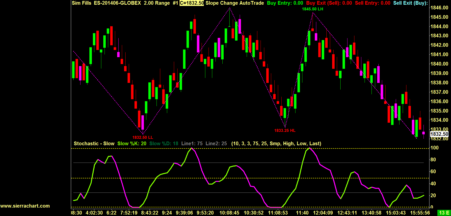

[2014-03-15 15:06:43]
Litz - Posts: 135
Yes. Trying that results in too many trades due to minor changes in slope creating many losing trades. One would have to limit trades to only large slope changes.
I see that you have worked on zigzag reversal alerts. Can these alerts be incorporated into Spreadsheet System for trading?

[2014-03-15 19:09:05]
Litz - Posts: 135
That seems to work on a short time frame. Have not tested it longer term. Adjusting the length of the %K to smooth it out and the size of the range bars seems to make a large difference in profitability although drawdowns are large.

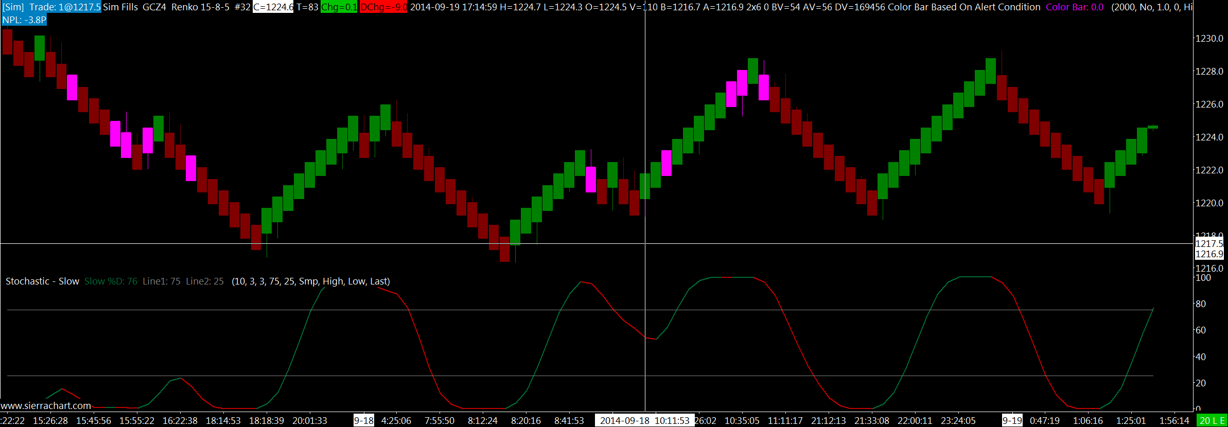

[2014-09-20 18:21:12]
User75277 - Posts: 33
Hi - I am using the attached study alert to paint bars on change of slope of the slow Stochastic. The study consists of the Stochastic and a Color Bar Based On Alert Condition:
(ID1.SG2 - ID1.SG2[-1]) * (ID1.SG2[-1] - ID1.SG2[-2]) < 0
This seems to work for Volume based bar charts but not for Range or Renko-Flex (does not seem to work at all for tick based charts but I do not use those).
My objective: is to (1) fix this so it can detect slope change all the time and (2) pass the two kinds of slop change (turn up and turn down) to another range chart (my Main price chart) so I can have a graphic display on my Main price chart.
Any help is appreciated. Thanks in advance. :)
attachmentSlopeChange.StdyCollct - Attached On 2014-09-20 18:19:57 UTC - Size: 18.68 KB - 857 views
imageCHART OF SLOPE CHANGE STUDY COLLECTION WHICH DOES NOT WORK O.png / V - Attached On 2014-09-20 18:20:28 UTC - Size: 74.98 KB - 766 views
[2014-09-21 03:25:05]
I think the formula is not considering equal slopes.
OR(AND(ID1.SG2[-2]>ID1.SG2[-1],ID1.SG2>ID1.SG2[-1]),
AND(ID1.SG2[-2]<ID1.SG2[-1],ID1.SG2<ID1.SG2[-1]),
AND(ID1.SG2[-2]=ID1.SG2[-1],ID1.SG2>ID1.SG2[-1]),
AND(ID1.SG2[-2]=ID1.SG2[-1],ID1.SG2<ID1.SG2[-1]))
This can be shortened to:
OR(AND(ID1.SG2[-2]>=ID1.SG2[-1],ID1.SG2>ID1.SG2[-1]),
AND(ID1.SG2[-2]<=ID1.SG2[-1],ID1.SG2<ID1.SG2[-1]))
This will alert at every change in direction (up to down, down to up, equal to up, equal to down), and it should work for any bar type.
