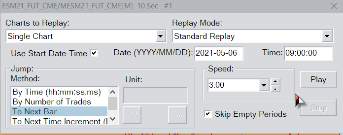

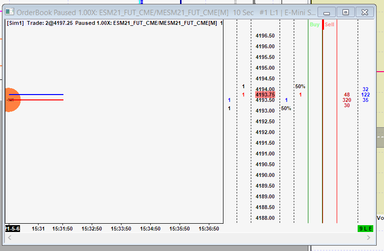

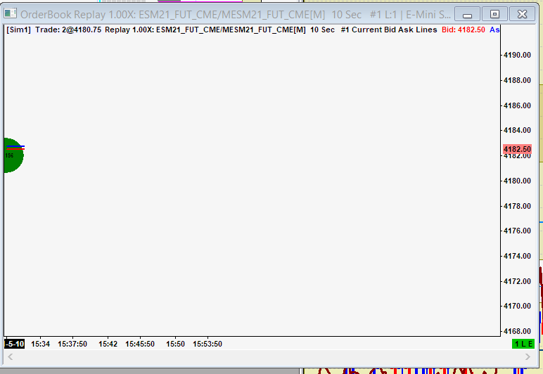

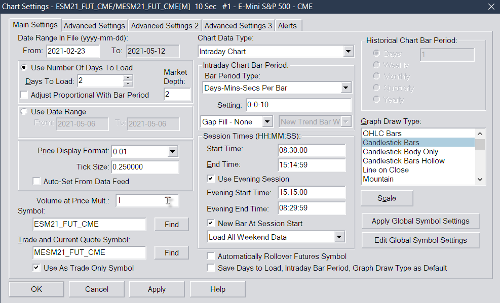

[2021-05-10 20:34:36]
amirN - Posts: 169
I am afraid it does not work for me.
1- I have a market depth chart with 4 days of data
2- I have .depth file for ESM21_FUT_CME.2021-04-06.depth
3- I use a single chart replay to 2021-04-6
4- no depth data shown on the chart i.e. it does not go to a time before the loaded data.
Please see attached
Date Time Of Last Edit: 2021-05-10 20:39:18
imagepic1.png / V - Attached On 2021-05-10 20:33:26 UTC - Size: 62.22 KB - 443 views
imagepic2.png / V - Attached On 2021-05-10 20:33:35 UTC - Size: 15.97 KB - 383 views
imagepic3.png / V - Attached On 2021-05-10 20:38:23 UTC - Size: 24.66 KB - 417 views

[2021-05-11 20:44:39]
amirN - Posts: 169
That does not answer my question:
What do I have to do, to be able to replay depth data on a day that is 60 days prior?
Just to make it absolutely clear:
Pic 1 number of days loaded is set to 6
Pic 2 set the replay to 21-05-06
Pic 3 The depth are shown
Pic 4 The number of days to load is set to 2
Pic 5 set the replay to 21-05-06
pic 6 the depth are not shown
So the depth data are there and valid but not shown in replay if the number of day to load is set low.
If I want to replay a date 60 days prior I have to set the number of days to download to 61 and SC throws memory error and would not load the file as the memory required is considerably more than 1.6GB. Then how can I replay those days?
imagepic1.png / V - Attached On 2021-05-11 20:44:05 UTC - Size: 62.85 KB - 386 views
imagepic2.png / V - Attached On 2021-05-11 20:44:14 UTC - Size: 18.28 KB - 299 views
imagepic3.png / V - Attached On 2021-05-11 20:44:25 UTC - Size: 44.09 KB - 306 views
[2021-05-11 20:45:26]
amirN - Posts: 169
File attached
imagepic4.png / V - Attached On 2021-05-11 20:44:52 UTC - Size: 61.71 KB - 340 views
imagepic5.png / V - Attached On 2021-05-11 20:45:00 UTC - Size: 19.51 KB - 384 views
imagepic6.png / V - Attached On 2021-05-11 20:45:18 UTC - Size: 26.24 KB - 397 views

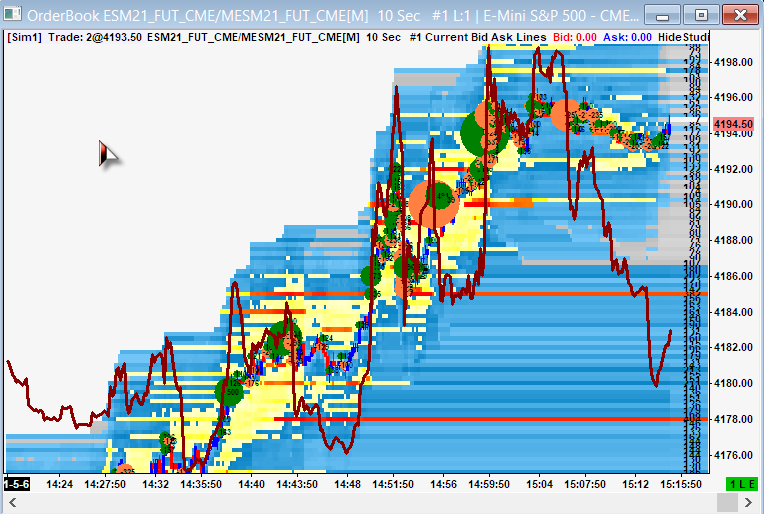

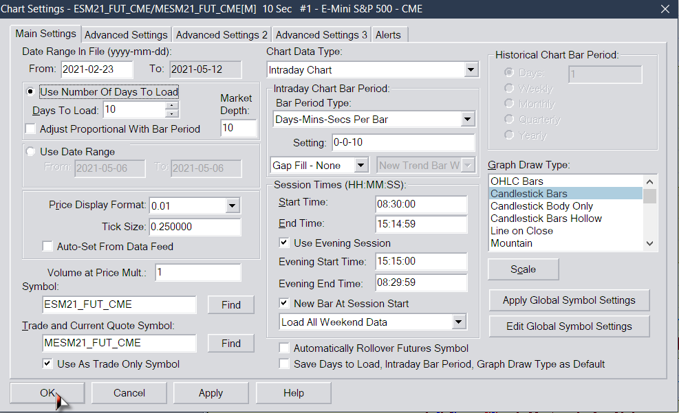

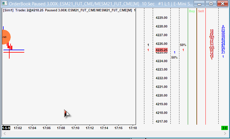

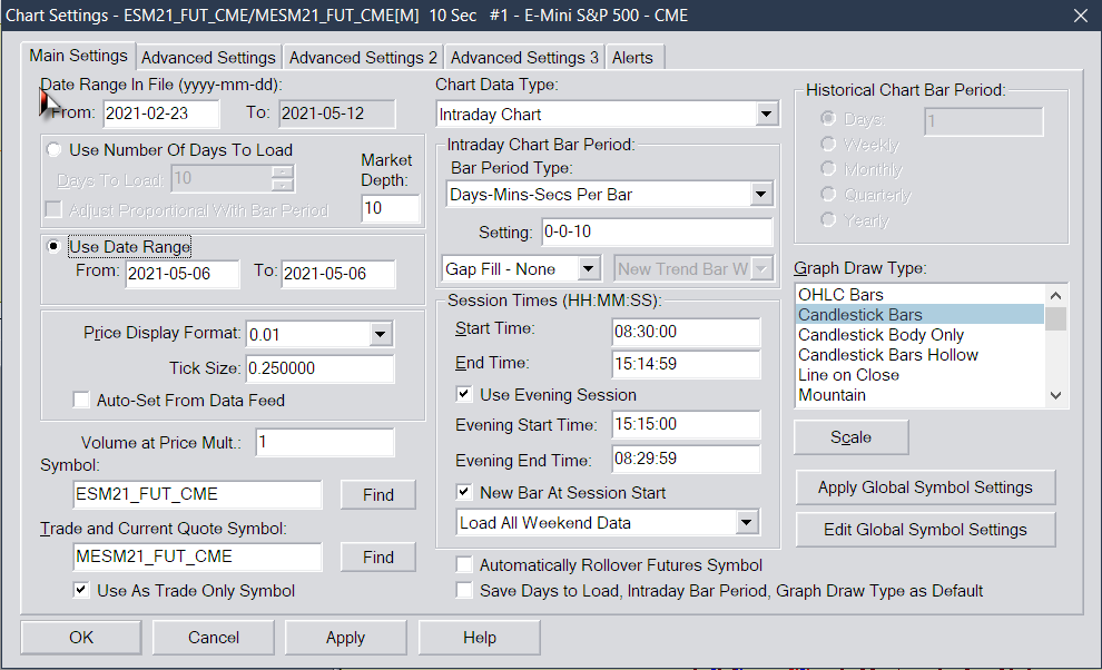

[2021-05-12 20:06:06]
amirN - Posts: 169
Please do the following for us:
- Open your chart and set the following in Chart Settings:
- Use Date Range
- From: 2021-05-06
- To: 2021-05-06
- Market Depth: 10
- Make sure the Market Depth Historical Graph is displayed and take an image of that screen. It should show that you have Market Depth Data.
Pic 1 and Pic 2

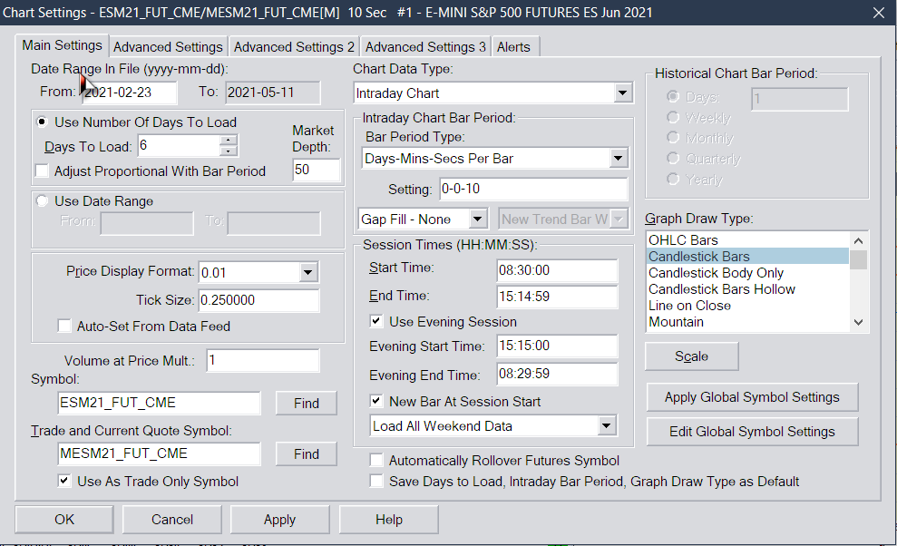

- Change your Chart Settings to the following, leaving everything else the same:
- Use Number of Days to Load: 10
Pic 3

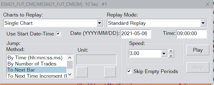

- Open your Replay Chart window and Enable: Use Start Date-Time
- Date: 2021-05-06
- Time: a time that is shown in the image taken above for 5/6 that shows Market Depth

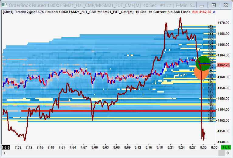

Pic 4

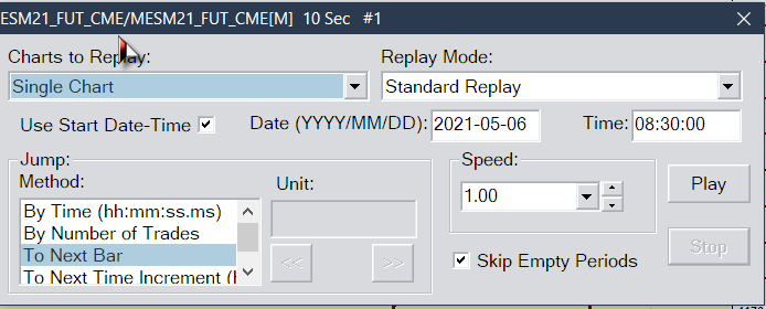

Select Play and let it play for a few minutes to show the data. Let us know what you see.
Pic 5

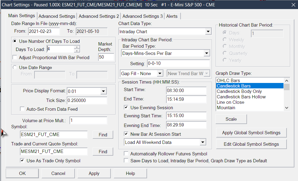

- Market Depth: 2
- Repeat the Replay as specified above and tell us whether you see the Market Depth or not.
pic 6
I have changed the chart setting to
Number of Days to Load: 2
Market Depth: 2
Pic 7 and pic 8 and pic 9
The chart is not displayed and the start time is 2 days ago. This is the same with price chart as well
Date Time Of Last Edit: 2021-05-12 20:11:28
imagepic1.png / V - Attached On 2021-05-12 20:04:56 UTC - Size: 62.18 KB - 324 views
imagepic2.png / V - Attached On 2021-05-12 20:05:06 UTC - Size: 75.97 KB - 334 views
imagepic3.png / V - Attached On 2021-05-12 20:05:16 UTC - Size: 61.99 KB - 364 views
[2021-05-12 20:06:52]
amirN - Posts: 169
File attached
imagepic4.png / V - Attached On 2021-05-12 20:06:22 UTC - Size: 19.92 KB - 367 views
imagepic5.png / V - Attached On 2021-05-12 20:06:31 UTC - Size: 72.88 KB - 342 views
imagepic6.png / V - Attached On 2021-05-12 20:06:46 UTC - Size: 73.54 KB - 297 views
[2021-05-12 20:08:09]
amirN - Posts: 169
File attached
imagepic7.png / V - Attached On 2021-05-12 20:07:44 UTC - Size: 60.69 KB - 307 views
imagepic8.png / V - Attached On 2021-05-12 20:07:53 UTC - Size: 19.95 KB - 293 views
imagepic9.png / V - Attached On 2021-05-12 20:08:01 UTC - Size: 19.12 KB - 290 views
[2021-05-12 20:31:33]
John - SC Support - Posts: 48095
We see that everything is working as it should. When you set the Market Depth to only be 2 days, when you started the Replay, you had your Market Depth displayed on 5/6, since it was the front day at that point during the replay.
What you are seeing in the last situation you cover, where you have only 2 days loaded is correct. You have to have the days loaded that covers the time frame for which you will be replaying your charts. So if you want to do a replay from 5/6, you have to have at least 6 days of data loaded. But, you do NOT need to have that many days of Market Depth. Just keep the Market Depth number of days at 10 and set the number of days to load to what you need to run the replay for the days you want to cover.
Date Time Of Last Edit: 2021-05-12 20:32:27
[2021-05-12 21:03:37]
amirN - Posts: 169
OK, I think I know where I am going wrong.
The "market Depth" in the setting windows is the number of days the market depth data is loaded.
So if I want to replay 60 days prior without running into memory problems the values should be set as:
The number of days to load to 61
Market depth to 4
In the setting window (F5)
One last question is there any way I can look at a few days of depth data 60 days prior without the replay function, using something "goto date-time"or preferably by syncing charts. Since if I set the "market Depth" to a low value like 4, there would be no display of depth data if I scroll back more than 4 days.
Date Time Of Last Edit: 2021-05-12 21:09:45
