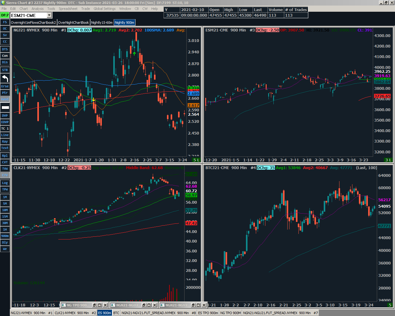

I attempted several times with no luck to transfer global graphics settings between sub instances using the below instructions. Also making sure to rename the originals if I had to revert and in all attempts nothing changed.
Basically I renamed sierra4.config to sierra4old.config and pasted a the new file. I also changed the extension on the old and that had no effect????

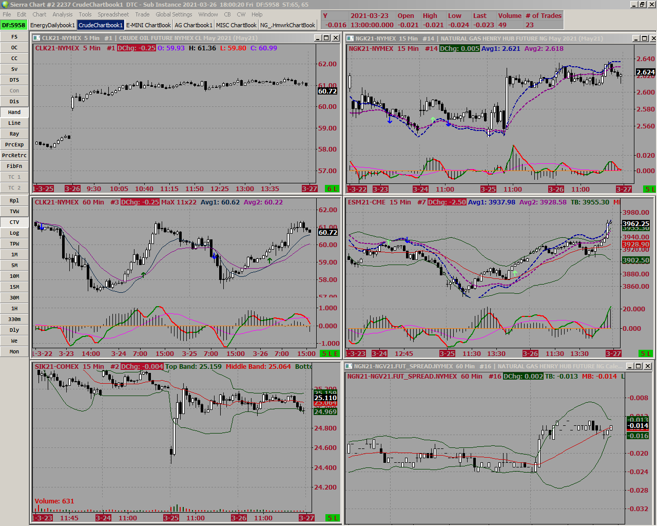

[2021-03-26 22:02:23]
User664240 - Posts: 209
I could not take a screen shot of the global graphics setting menu with it dropped down to demonstrate it is the same menu and not the transferred menu and as for your other suggestions the "use global graphics setting is checked in all instances but all of this is moot as the CB buttons and coloring are not affected by these options see below.

[2021-03-26 22:37:59]
I realize that I explained this poorly. What I meant is the CB and CB buttons and all the other menu items are not effected by specific chart settings only the Global and the drop down menu for global settings is not from the transferred instance.
