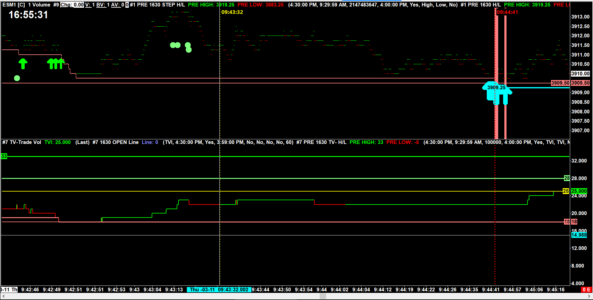

I have my "Trade Volume" study draw style SG1 set to auto coloring "Based on Slope" to Green for up. and Red for down.
When Im doing a "Color Based on Alert Study" and noting the slope to activate the alert, I typically use the Simple alert: ID70.SG1 < ID70.SG1[-1] to denote a down slope.
But in some studies, (this Trade Volume in particular), Ive notice the line in the study changes color while the line has the same value (ie: a level line).
Ive looked to see what cause the change in color, like a change in price, ask/bid, and I cant see anything. Besides what it is that makes it change colors for slope when there isn't any change, how would I denote that change of color in a simple alert? Obviously something changes to make the slope color change. I see in this example a "# of trades"is close to the change, but I cant see any relevance.

The first thing we need to know is whether the data all the way across the flat area in the Trade Volume Index is, in fact, flat. Please verify that where you have the vertical line drawn, that the value of the TVI at the bar following that line is the same as the bar where the line is drawn. We think that there is probably a very small change in value that is then causing the slope to be positive.

yes, at the yellow vertical line before (red) and after (grn) the Trade Volume is 22. I even changed the value format to .001 thinking there might be minute change, but no.See added screenshot.
I dont think it matters but its a volume chart. Obviously on non small time/increments, it wouldnt show up bc of ever changing outputs. But some input has to change the color.
Is there a simple alert way to identify the color (green) instead of the "increase" in value as I have noted and is typical? Likewise red. Since typically its green when a slope is up is normally not a problem, but without any noticeable change in value,I cant see why it changes color on a level horizontal line.
