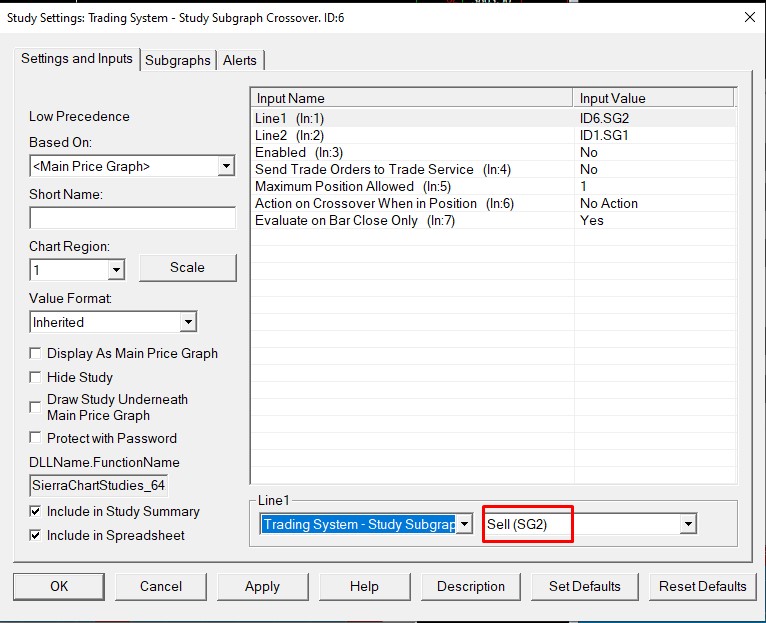

[2021-03-10 08:14:00]
User61576 - Posts: 458
==1
= there is a signal?
pls check attached screenshot, this is the source of the signal
can it be
== true
imageScreenshot_6.jpg / V - Attached On 2021-03-10 08:11:55 UTC - Size: 109.04 KB - 389 views

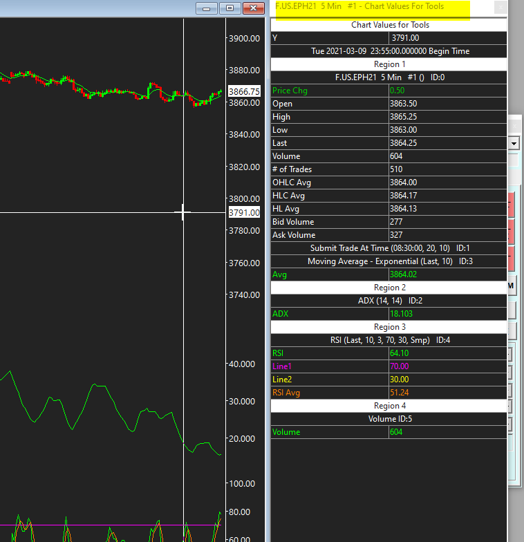

[2021-03-10 08:33:05]
Flipper_2 - Posts: 57
Use the "Chart Values For Tools" window to see what values are in the subgraphs
image2021-03-10 19_30_39-Sierra Chart 2234 Forum_Example CQG Web.png / V - Attached On 2021-03-10 08:32:54 UTC - Size: 46.65 KB - 592 views

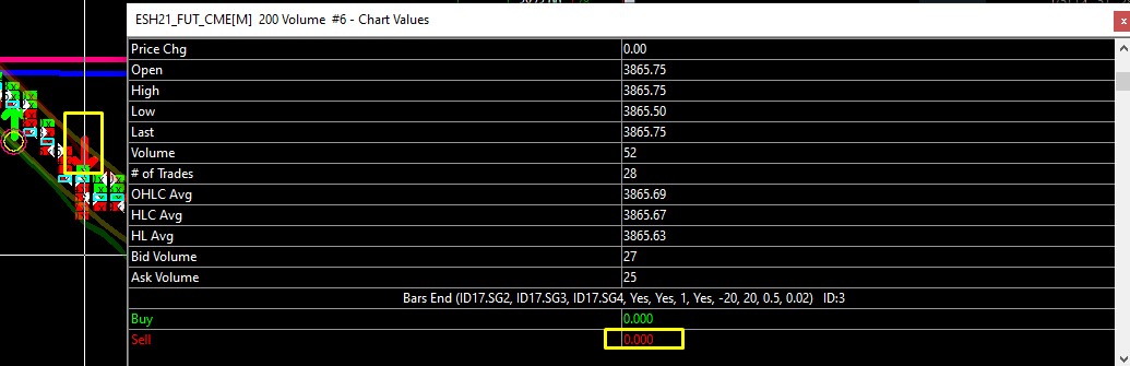

[2021-03-10 11:30:46]
you can see here (attached) that the signal (red down arrow) has no value
any other suggestion?
imageScreenshot_7.jpg / V - Attached On 2021-03-10 11:29:43 UTC - Size: 72.06 KB - 389 views
[2021-03-10 11:42:10]
Do you have the code for that study? You need to find the logic for that arrow and see why/how the value is stored/produced and import that subgraph
this is study #2 (scsf_TradingSystemStudySubgraphCrossover)
if #2 and #1 are both long I want the aggregator study to execute a long trade. the aggregator study is also scsf_TradingSystemStudySubgraphCrossover
i am using scsf_TradingSystemStudySubgraphCrossover as #2 for making a decision based on macd crossover and also if there is a crossover (#2) and signal from #1, then go long
I don't need the value of the inherited values, this ones I know
I need to find the value of drawing of the signal on the chart
another option I think about is creating a value which will be given a 1/-1 value upon long/short

User907968 - Posts: 885
You need to use the 'Chart Values for Tools' window, called 'Tool Values Window' in the menu. In your screenshot you are using the 'Chart Values Window', which reference the last bar displayed in the chart, not where the crosshair is - i.e. what's shown in you screenshot is not the data pertaining to the correct bar.
If the arrow is drawn on the chart by a subgraph, then it will certainly have a value.
