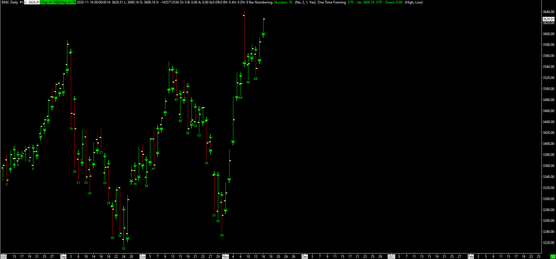

SC Support Tom - Posts: 450
I have coded this study based on the description given in Post #3.
The study contains two Subgraphs:
1) OTF - Down, which equals the High when High < High[1] and equals 0 otherwise. If this Subgraph is nonzero at a bar, then a downward arrow is placed at the High for that bar.
2) OTF - Up, which equals the Low when Low > Low[1] and equals 0 otherwise. If this Subgraph is nonzero at a bar, then an upward arrow is placed at the Low for that bar.
Note that any given bar can be both OTF - Up and OTF - Down, as is the case with Bar #4 in the attached image.
Let us know if this is what you had in mind. If so, then I will submit the code to Sierra Chart Engineering.
Date Time Of Last Edit: 2020-11-17 08:31:29
image$INX Daily #1 2020-11-16 21_09_00.555.png / V - Attached On 2020-11-17 03:17:38 UTC - Size: 36.69 KB - 602 views

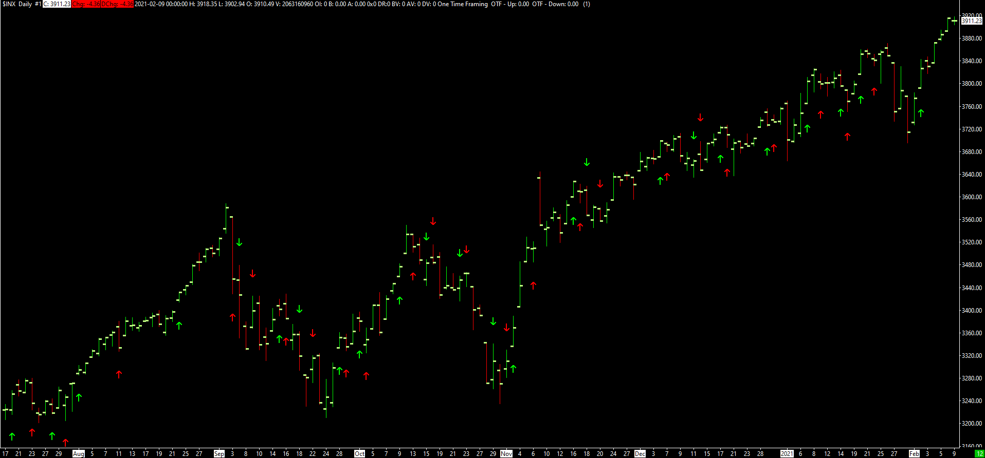

This study has been coded and submitted to Sierra Chart Engineering. It will be available soon; just keep updating your version of Sierra Chart.
The study will function as documented here:
One Time Framing
WRT Post #15:
a possible addition to the study is to have a selection period of timeframe:
1) based on bar period
2) based on daily bars
3) based on weekly bars
The study is quite basic, and has only one Input: an offset percentage that controls where the arrows in the Subgraph are drawn (see attached image). The timeframe of the study is the same as the timeframe of the chart. If you want it to be weekly, you can open a Daily Chart, change the timeframe to a 7 day chart, and apply the study.
image$INX Daily #1 2021-02-10 16_45_18.882.png / V - Attached On 2021-02-10 22:46:52 UTC - Size: 30.7 KB - 449 views

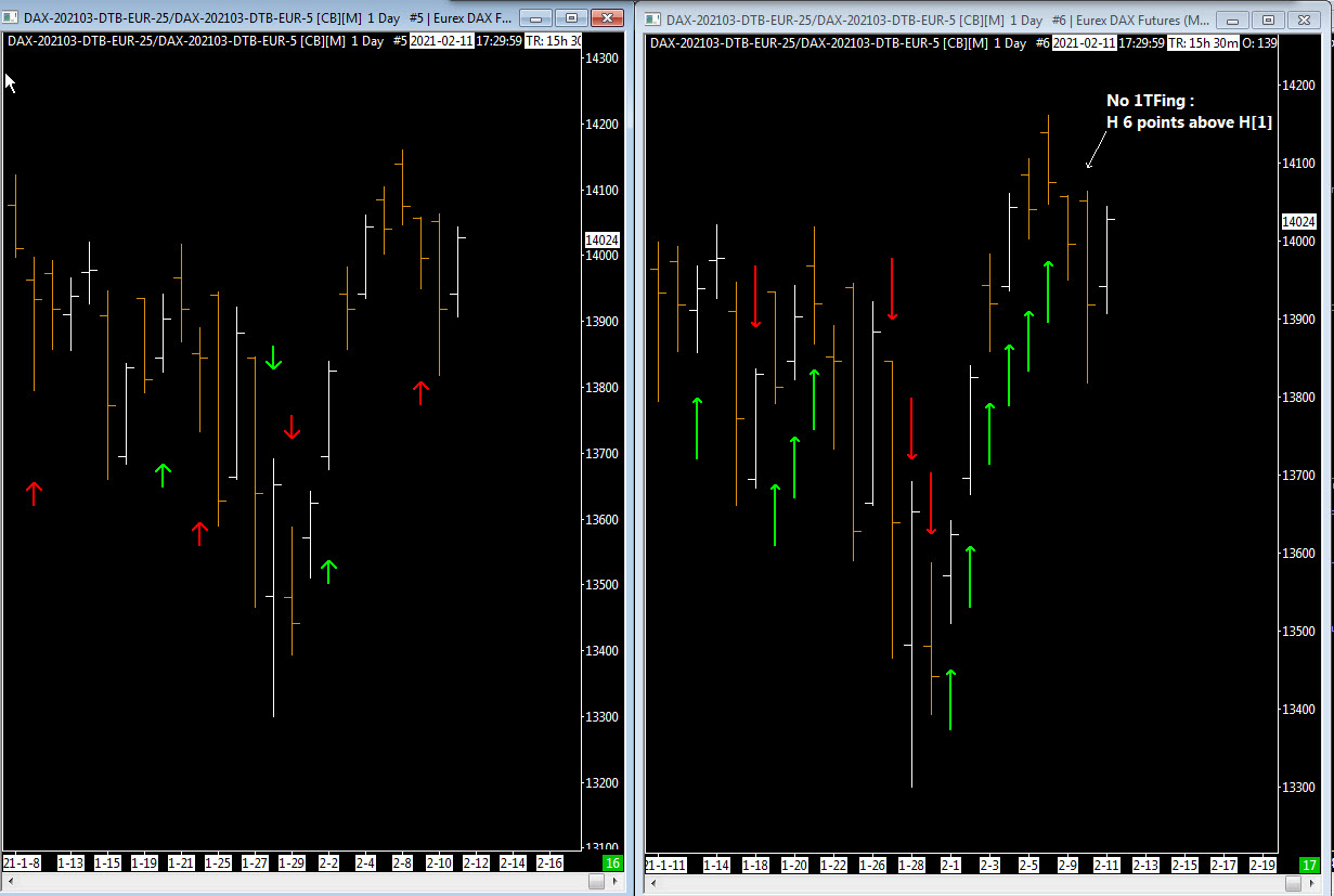

User877753 - Posts: 152
Hi John,
Great to have a new indicator for One-TimeFraming !
However I'm not sure the One Time framing indicator does exactly reflect generally accepte One-TimeFraming concept.
Jim Dalton popularized the concept as :
"One-TimeFraming
A trending situation where in an uptrend, the low of the previous bar is not broken to the downside by 2 ticks or more. Conversely, in a downtrend, the high of the previous bar is not exceeded by at least 2 ticks or more. As these upside and downside situations occur over multiple bars we identify them as 'one-timeframing’."
See : One-TimeFraming in https://jimdaltontrading.com/glossarypage/
In his 1993 "Mind Over Markets" book, Jim defines one-timeframe seller control as "inability of the buyer to successfully rotate price upward beyonf the previous time period's auction high during two or more successive periods."
The arithmetic transalation is :
One Time Framing up = L[1] > L - 1 : no condition on H.
One Time Framing down : H[1] < H -1 ; no condition on L.
See attached screenshot for correct drawing (so I hope...) on the right pane versus current indicator on the left pane.
Some useful enhancements to the indicator would be :
- to adjust the Arrow Offset in Ticks or Points : better on intraday chart
- to allow the user to modify the step in ticks or points : condition would be : L[1] > L - step. Would make sense for NQ for instance : a 1 tick step, as 1/4 point, is really too tight.
These days Jim uses a two tick step for ES.
Hope this helps. Feel free to reach me if you need.
Regards,
JM
image2021-02-11 17_31_20.jpg / V - Attached On 2021-02-11 16:32:02 UTC - Size: 192.9 KB - 477 views
WRT Post #19:
I coded and documented this study. Unfortunately, I did not find any explicit formulas for this study, but rather verbal descriptions. I inferred my formulas from those descriptions.
Let me see if I understand you correctly.
I understand L[1] and H[1] as the Low and High of the previous bar, respectively. I also understand L - 1 and H - 1 as 1 unit less than the current Low and High, respectively. Have I got those right?
Also, there must be a condition on H for OTF(Up) and on L for OTF(Down). Either that, or the following source is wrong.
http://www.marketprofilesolution.com/Archive/2014/5/basic_strategy_6#.YCbsymhKiUk
A one time framing is stopped by an inside bar. An inside bar is defined as a low higher than the previous bar low AND a high lower than the previous bar high and it starts a new balance. This balance top and bottom being the high and low of the bar preceding the inside bar.
I set up my formulas so that an Inside Bar would indeed stop OTF.
[2021-02-13 09:41:52]
WRT Post #20:
Yes. the "unit" could vary from 1 to a few ticks, depending on contract's average range.
There is no condition about H in 1TFing up ; no condition about L in 1TFing down.
As I understand One Time Framing (1TFing) from original authors, the source you mention is wrong.
Inside bar does not stop any 1TFing, as both condition are verified : L[1]>L>L-1 and H[1]<H<H+1.
Observation : the only type of bar which would stop any 1TFing, up or down, is an outside bar, as both previous H and L are exceded.
Note that outside/inside bar is not relevant for coding : just an observation.
Hope this helps.

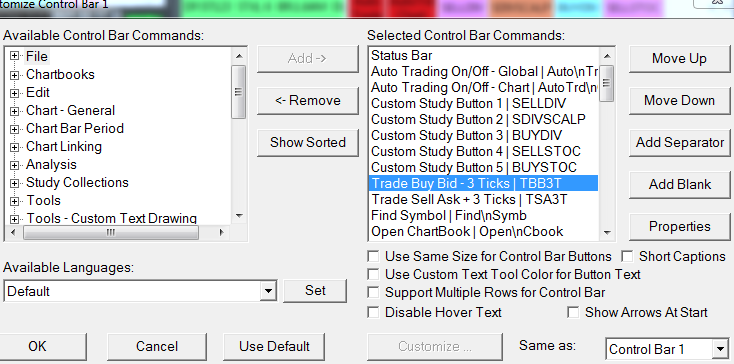

User657945 - Posts: 226
Tom may be I'm wrong but since you made a quite complex code in so less time, sometimes ago I asked if it was possible to make a modification to the code of a control bar buttons in sierrachart precisely TBB3T and TSA3T see attached snapshot.
The modification it's just the possibility to set up the number of ticks that now are fixed at -3 for Bid and +3 for Ask, since i.e on MicroNQ 3 ticks is very thin while on inerest rate FGBL is huge so need to set up like 12ticks on micro NQ and 2 ticks on FGBL and so on for any other derivatives traded.
Thx
imageTRADEBUYBID.PNG / V - Attached On 2021-02-17 23:28:14 UTC - Size: 58.33 KB - 418 views

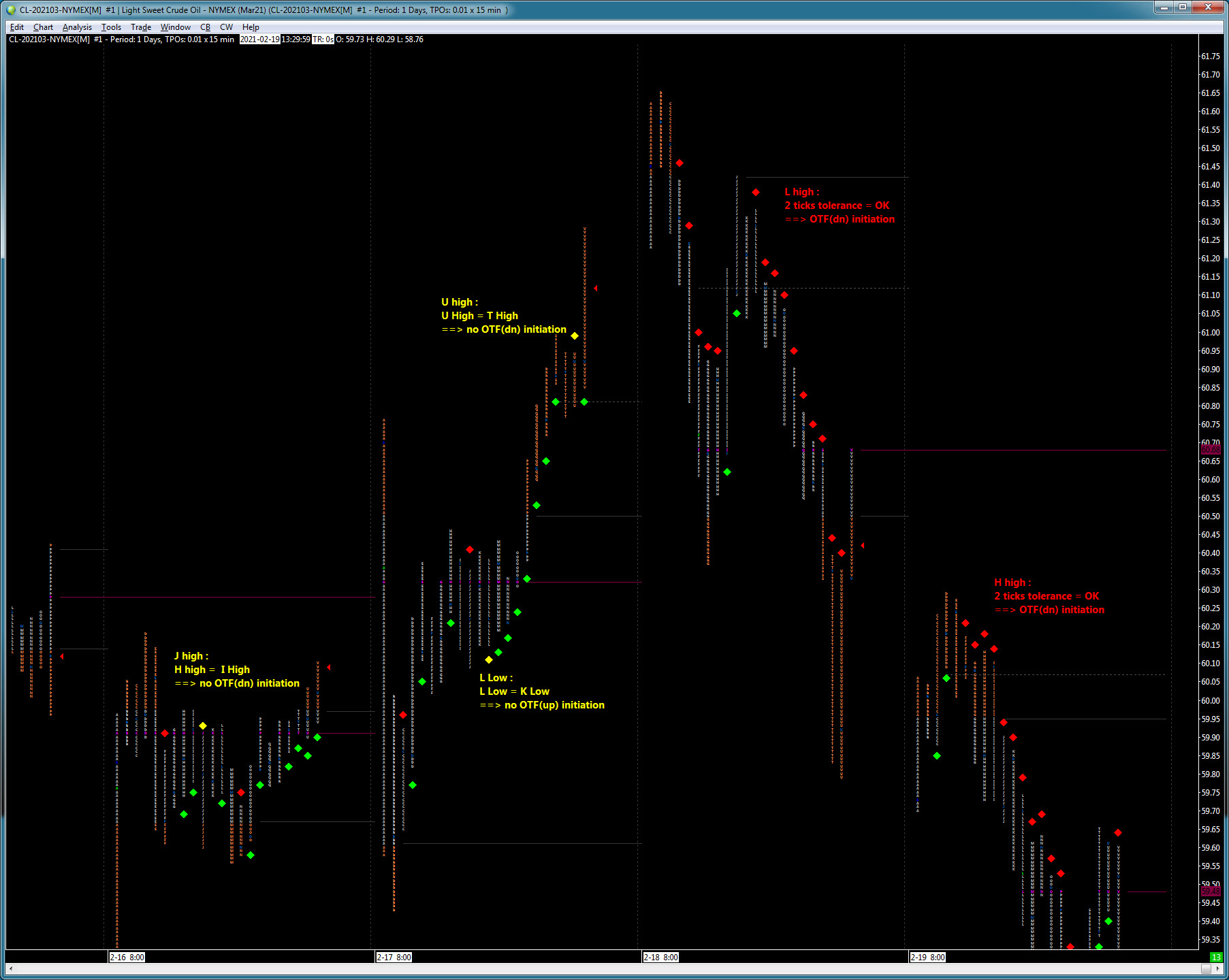

Suppose I create an Input called Number of Ticks (call it N) in conjunction with the Tick Size (s). Would you agree that the following formulas would be correct?
OTF(Up): L[1] > L - N*s
OTF(Down): H[1] < H + N*s
Hi Tom,
Taking into account Number of Ticks and Tick Size is a great idea.
So I understand that :
CL : Tick Size =1 Number of Ticks = 2 N*s = 2 cents
NQ : Ticks Size = 4 Numbert of Ticks = 5 N*s = 5 points
Am I correct ?
However, I realize that I made a stupid mistake in post 19 and that I misled you - sorry about that.
So let start over : here is my suggestion.
Condition for OTF(up) state entry :
L[2] < L[1] AND L[1] < L // We want two successive strict clean Higher Lows
See image for illustration of strict higher highs ; CL, 15 mn TPO, 2 ticks
For futher evaluation of OTF(up) state, I define a threshold level : LastStrictHigherLow, noted LSHL.
I will compare current Low to this threshold, as I don't want an endless downside drift each time within the N*s limit.
Condition for OTF(up) state exit :
LSHL=max(LSHL[1),L[1]) // LSHL is the max of previous Last Strict Higher Low and previous Higher Low
LastStrictHigherLow - N*s > L // Compares last Low below previous Low minus N*s
Jope this help. Sorry again for my mistake.
JM
image2021-02-20 13_13_22.jpg / V - Attached On 2021-02-20 12:16:28 UTC - Size: 444.7 KB - 608 views
WRT Post #23:
See Post #22 and let me know if that answers your question. There I propose adding an input that allows the user to set the number of ticks used in the OTF calculations.
