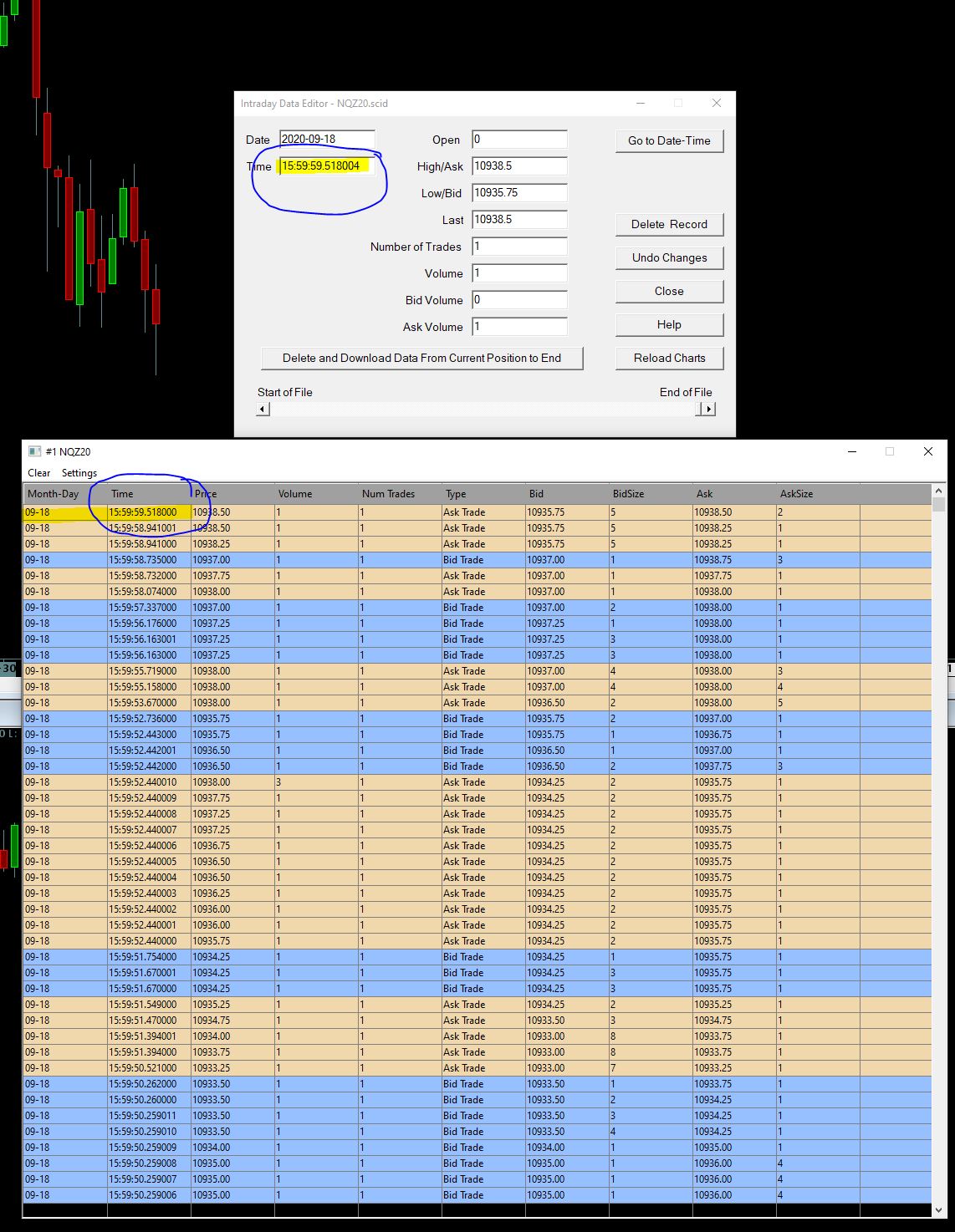

[2020-09-19 02:37:41]
ejtrader - Posts: 689
SC Team - Attached is the image of NQZ20.
As you can see from the image - T&S Very last record was at 15:59:59:518000.
In intraday file - there are additional records ( 4 Records - They keep increasing when you disconnect & Connect).
15:59:59:518001
15:59:59:518002
15:59:59:518003
15:59:59:518004
in Case of ES - There are 9 records in intraday file extra compared to last Time and Sales records.
Would you please check and confirm as this is causing issues for various studies which expects T&S and charts/intraday files to be in sync?
Edit - It appears like when there is a TS_MAKER record some how triggering the incorrect intraday record.
Date Time Of Last Edit: 2020-09-20 01:12:33

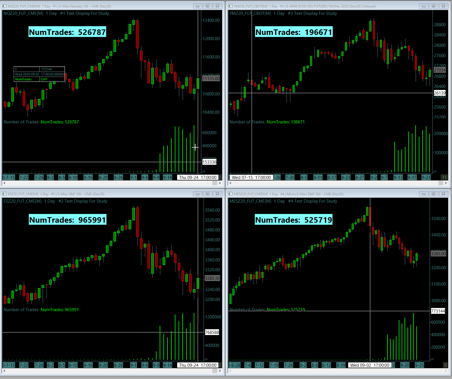

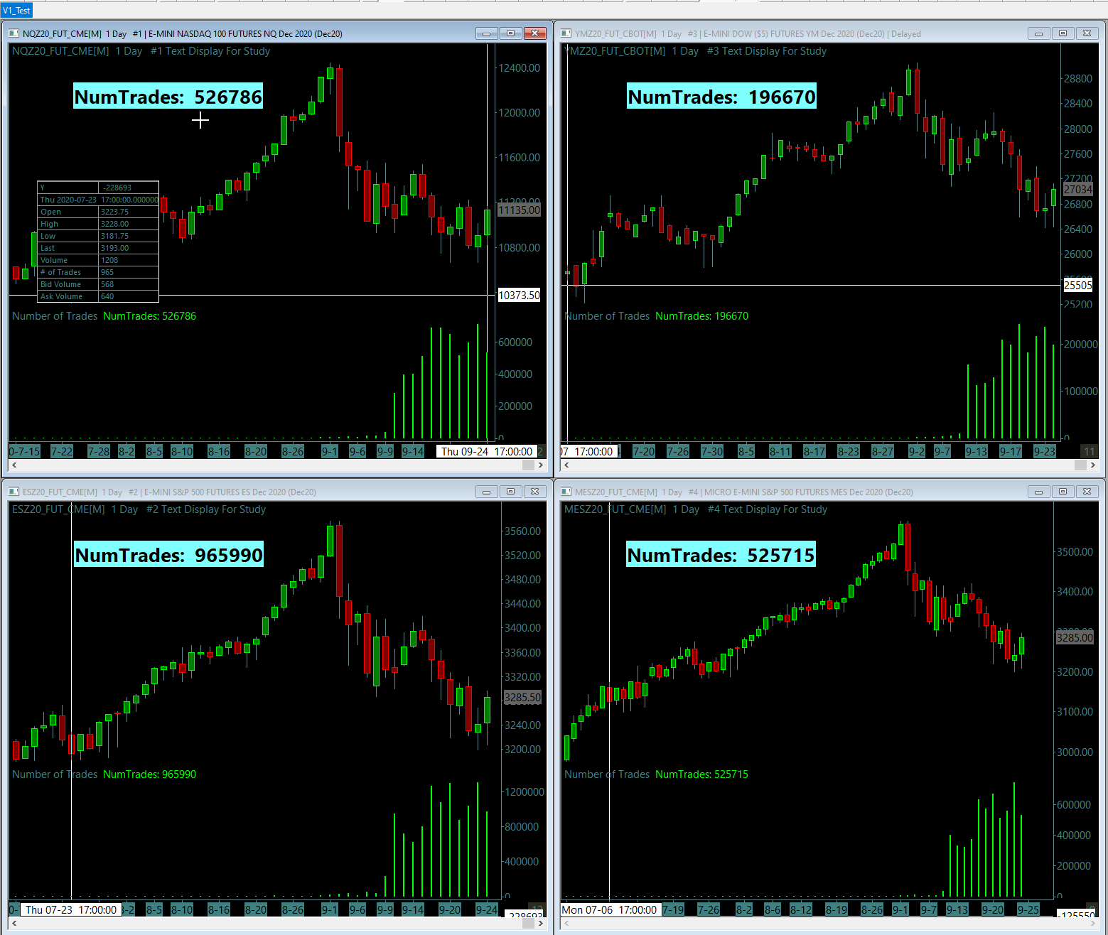

[2020-09-26 16:39:18]
This is SO frustrating that SC doesn't even acknowledge this as a potential bug. To maintain the accuracy across instances - it's really time consuming.
It happens with all the cases below:
- Live feed
- Delayed feed
- Main instance
- Sub instance(s)
- First image - incorrectly accumulated data (All this under normal circumstances - with auto triggered historical downloads which happens on it's own)
- Second image - After Delete/download option is used for the very last trading day - which corrects the data.
Could you kindly check on this issue?
Other users - Are you NOT experiencing similar issues?
Date Time Of Last Edit: 2020-09-26 16:43:30
imageSC_IncorrectlyAccumulatedRecords_Prior_To_DeleteDownload_Tas.png / V - Attached On 2020-09-26 16:38:12 UTC - Size: 88.09 KB - 408 views
imageSC_CorrectRecords_After_DeleteDownload_Task.png / V - Attached On 2020-09-26 16:38:20 UTC - Size: 95.68 KB - 435 views

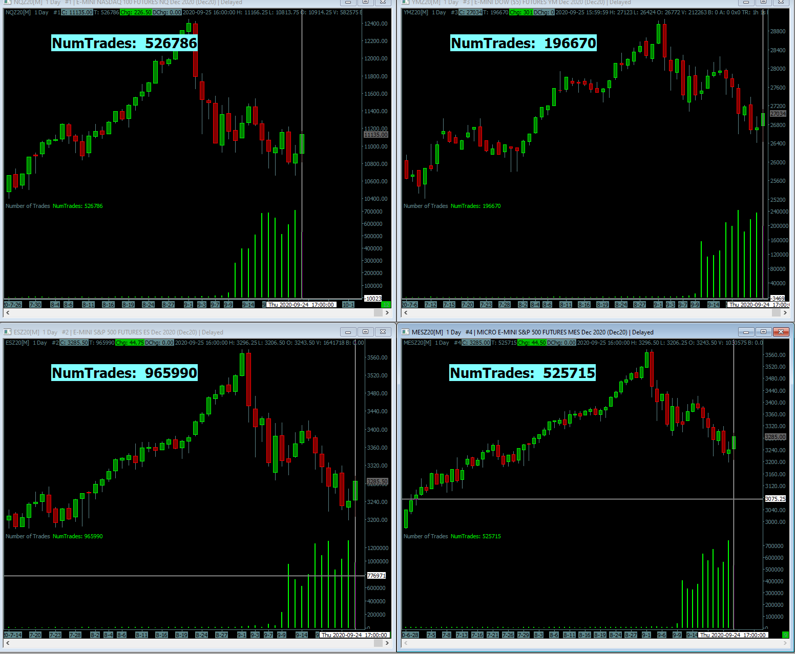

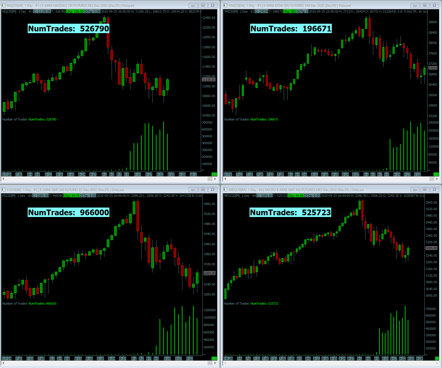

[2020-09-26 22:50:06]
Here it is from live feed - Today market is closed and have to deal with increasing number of trades on their own.
First image captured in the morning(this is after correcting the data using delete/download option) and second image captured in the evening ( all of this under normal circumstance). So this process of incorrect data is NON-stop even if the market is not open.
Main instance / live denali feed.
Attached is the small portion of log from the message log - when this auto triggered. As you can see it has added 1-4 records on it's own with triggered historical download (though these records are ALREADY part of intraday file. This produces the incorrect count for a trading day. Even if the data is corrected using "delete and download" option for the last trading day - it's NOT guaranteed to stay accurate as another auto triggered historical event would again add additional intraday records making it incorrect again.

[2020-09-28 23:29:27]
SC Team - Would you please acknowledge and comment whether you think this is a bug or not? Few of the custom studies are dependent on the T&S and intraday data to be in sync and struggling to maintain them due to this issue. Thank you much for your time.
Date Time Of Last Edit: 2020-09-28 23:30:32
[2020-09-29 19:38:23]
We expect to be going over this, today or tomorrow. There is no need for anything further. It takes too much time for us to go through all of these repetitive details.

Update to prerelease 2176.
We did find a small detail which was leading to an additional trade from getting inserted upon the writing of records during a historical Intraday download. But just one trade.
[2020-10-02 11:48:21]
SC Team - Thank you. I would think the auto triggered historical download events would be handled with the fix you did (would test and confirm).
However the manual disconnect/reconnect events are still failing.
- Tested in subinstance - the number of records differ in subinstance compared to main instance.
- Haven't tested the disconnect/connect behavior on the main instance yet.
Good news is - Main instance seems to be behaving much better now. But the subinstance - auto triggered historical download still has issues as well as manual disconnect/connects.
Edit - It appears like you have 2 builds for version 2176. 33473 & 33502. I was using the 33473 build which showed the errors. I would try out 33502 build and see if it resolves the issue.
Edit 2 - 2176 - Build 33502 - Issue seems to be resolved. If it works consistently for next week - it's all good. Thank you SC team.
Date Time Of Last Edit: 2020-10-04 02:58:37
[2020-10-08 17:53:48]
SC team - Update on this. So far this seems to be working as expected without any issues. Thank you.
