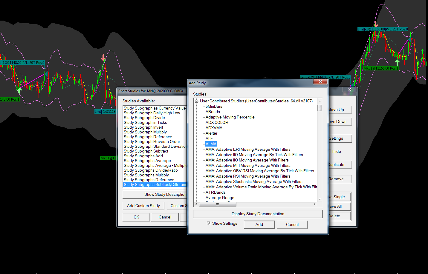

Ackin - Posts: 1866
I have used the Alma in other trading platform, it is useful, I hope Sierra can add it in studies!
ALMA has been part of UserContributeStudies for several years
imagealma.png / V - Attached On 2020-08-17 09:15:46 UTC - Size: 142.62 KB - 583 views

User223734 - Posts: 120
Dear Ackin,
I have try the Alma in UserContributeStudies but it can't work in Sierra 2150 version , may I know which software version you are using?

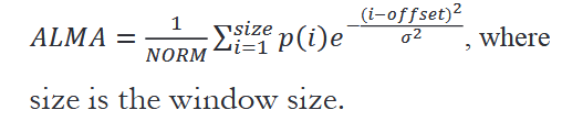

Research on quantitative forecasting in food prices:
https://www.cjournal.cz/files/308.pdf
The formula cited in that paper is in the attached image. It is the same as post #3.

The references in Post #14 use the same formulas as the references that I gave in Posts #3 and #11.
Yes, this is the formula that looks like it is missing a factor of 2 in the denominator of the exponent. That is, I would expect to see 2*sigma^2 in the denominator of the exponent if this is a Gaussian filter. The absence of the 2 means that the weights are squares of Gaussian weights.

cmet - Posts: 746
It's already in there.
Moving Average > Arnaud Legoux
Incidentally, the output is identical to the ALMA in User Contributed Studies.
Date Time Of Last Edit: 2020-09-19 00:52:31
[2020-09-19 02:04:46]
I can't find it? I am using 2146 version.
From Moving Average, it is only available "Adaptive' and "Adaptive Binary Wave" , after that it is "Block" , "Double Exponential"......
[2020-09-19 03:58:01]
User90125 - Posts: 715
Upgrade your SC version then. It's there in the latest build.
Date Time Of Last Edit: 2020-09-19 03:59:30
[2020-09-20 05:21:24]
Yes update Sierra Chart to the current version to find the study.
