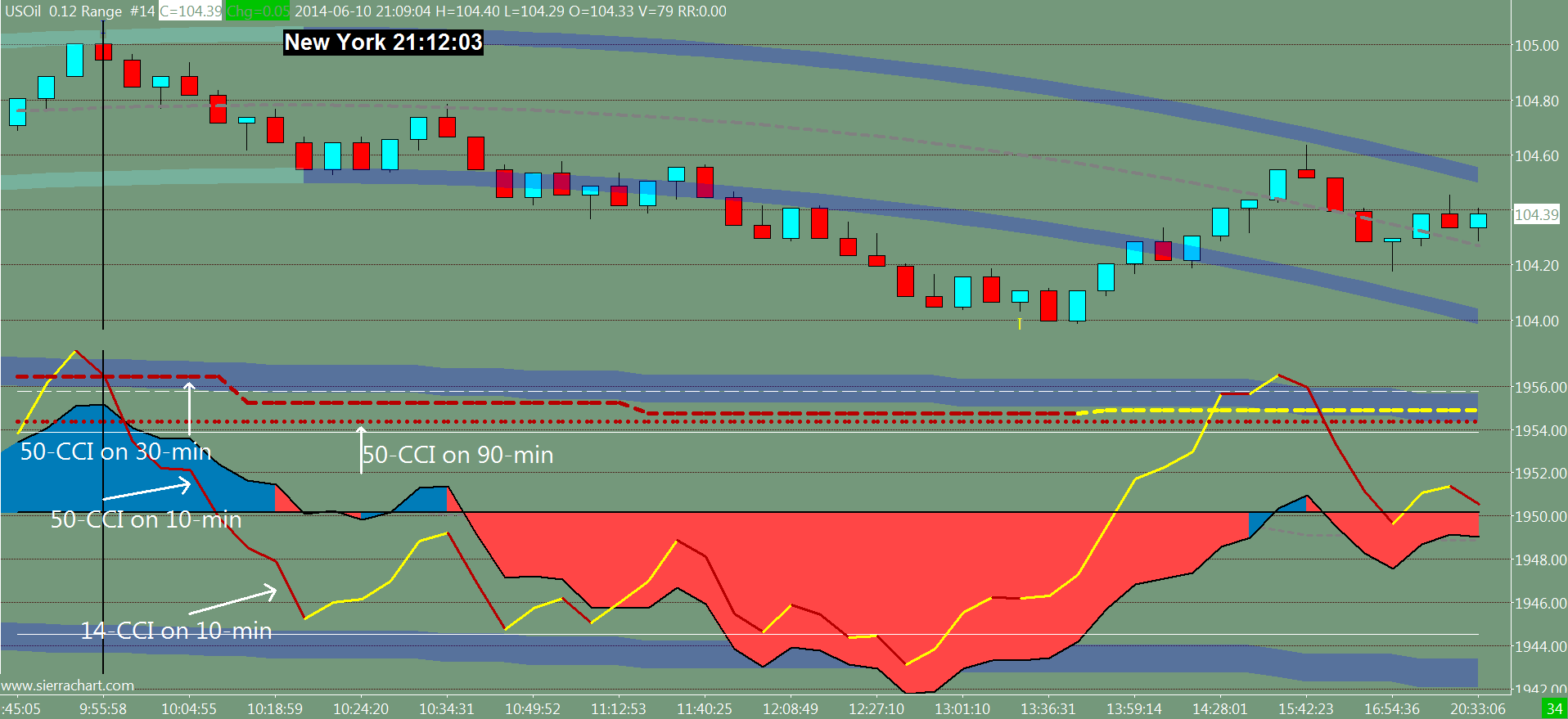

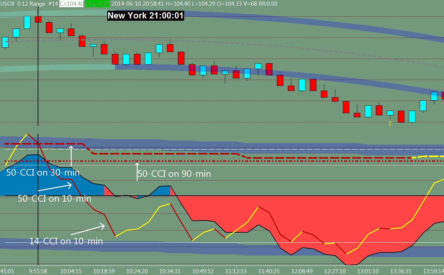

I should have been more specific. Because I will overlay the 50-CCI from different Time Frames on a chart (such as on a 10-minute chart overlayed with a 30-minute 50-CCI and a 90-minute 50-CCI), I want to be able to have a candlestick (bar) on the 10-minute chart in which the 14-CCI and 50-CCI on the 10-minute chart as well as the 50-CCI on the 30-minute and 90-minute charts (study-price overlay) are all Yellow (Up).
Please see attached picture with the black vertical line at 9:55-AM indicating the 4-referenced CCI lines as all descending.
Thanks again

http://www.sierrachart.com/image.php?l=1402449123387.png

image2014-06-10_2100_Oil.png / V - Attached On 2014-06-11 01:08:24 UTC - Size: 44.02 KB - 709 views
[2014-06-13 13:31:34]
jackw - Posts: 57
Triggering a single alert off of multiple time frames makes things a whole lot more complicated. I outlined what I think is the easiest way below, but its still pretty convoluted. I considered using spreadsheet studies to do this, but it turns out that is just as complicated, and then you have the additional overhead of the spreadsheets. The best way to do this is with a custom study, but you really don't want to invest the time in writing one until you've been using this for a while and you're sure its worth the effort.

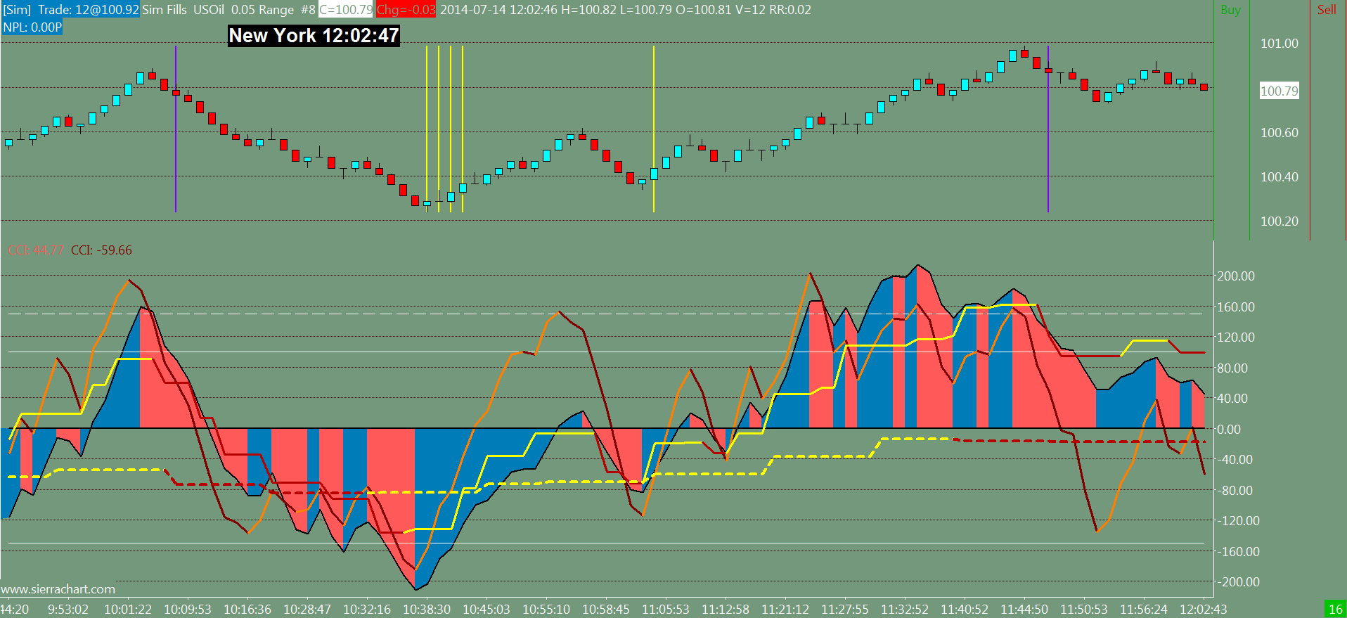

Back from the hard life of travel. 30-hours ago I was having mint tea with disreputable types in the casbah of Tangier.
I implemented your terrific alerts etc. Two alterations so far: 1) I replaced a color-bar with color-background, and 2) I required the 14-CCI of the main chart to have the previous bar as plus 75 or minus 75 subject to Selling or Buying (relatively).
It would have taken me a long time (and I'm being kind to myself) to have understood to create slope alerts in the 'longer' time frames, as well as make the main chart alert include plus-1 and minus-1 requirements for the 'longer' time frames.

http://www.sierrachart.com/image.php?l=1405353768513.png

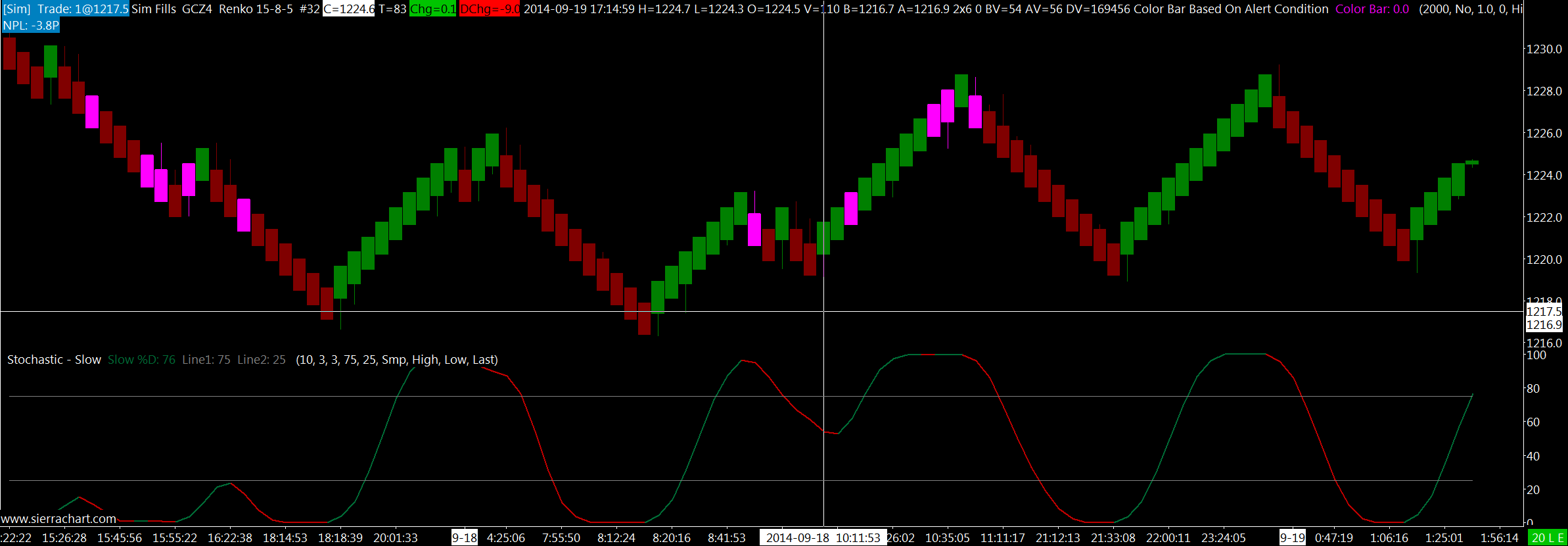

Hi I tried to use the Slope Change Study above ---> SlopeChange.StdyCollct <-- but it does not work all the time on a Range or Renko (Flexticks) or ticks per bar charts. seems to only work on a volume per bar chart. On a ticks per bar chart (144 ticks) it does not work at all.
The attached picture shows some times where it is not working. Other pictures how it working most of the time. Any idea what is wrong? Thanks in advance for your help and comments.
imageCHART OF SLOPE CHANGE STUDY COLLECTION WHICH DOES NOT WORK O.png / V - Attached On 2014-09-20 17:57:41 UTC - Size: 74.98 KB - 756 views

[2014-09-20 18:55:13]
jackw - Posts: 57
Found 2 problems with the original study collection that were creating your issue:
1) The Value format on the Stochastics study was set to 1. Because of this, when the alert formula on the color bar referenced the %D value, the value it was getting was being rounded to a whole number. So, when the change in %D from bar to bar was less than 1, the alert would fail.
2) Though it happens rarely, if the %D value is the same value 2 bars in a row, the alert would fail.
Made the following changes to the study collection:
1) Changed the Value format on the Stochastics study from 1 to .01.
2) In the alert formulas, changed the operator from '<' to '<='
The revised study collection is attached. Let me know if you still see a problem.
attachmentSlopeChange.StdyCollct - Attached On 2014-09-20 18:54:19 UTC - Size: 18.68 KB - 694 views

[2014-09-20 19:41:52]
User75277 - Posts: 33
Jack, I see your changes in the newly downloaded study you provided, but it still misses some slope changes mostly when the Stochastic is flatish on either side of the slope change. For tick charts (144) it does not seem to color bars at all. I can not see what is wrong.
