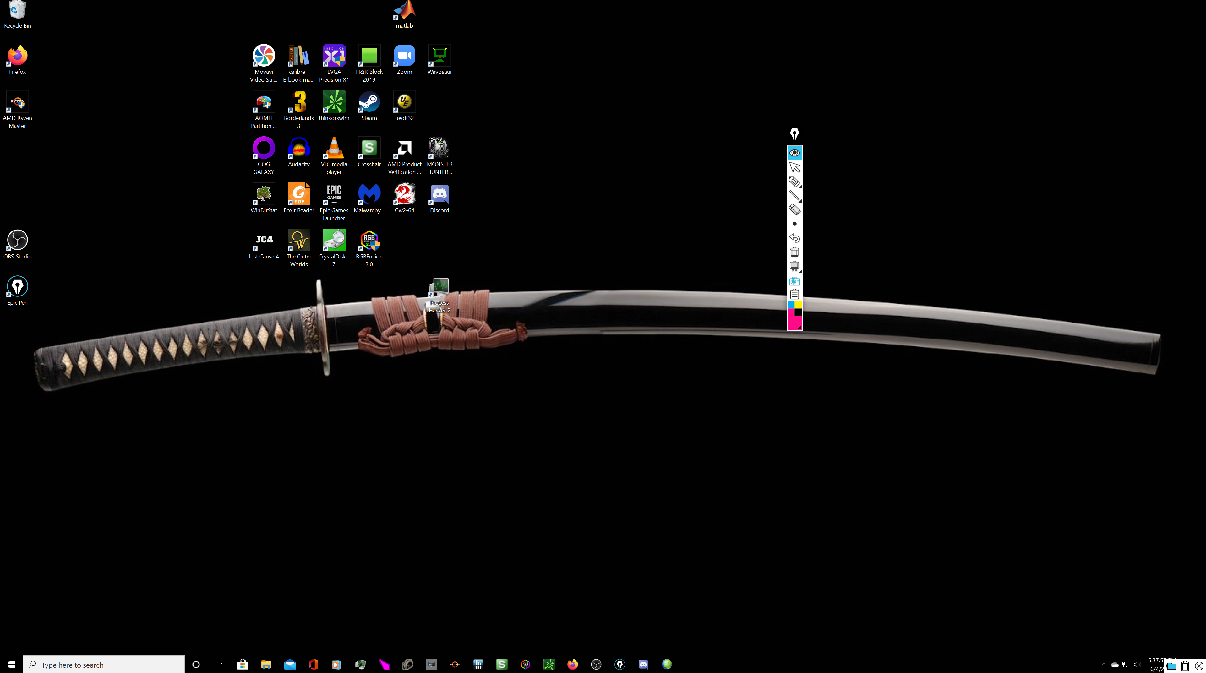

Unhandled Exceptions in chart drawings, in market historical depth loading, etc, makes OpenGL really unpredictable. Sometimes it loads & works several days then the next day, it rears its ugly head against. And when it crashes, it took down the whole system w/ them so u have to terminate the process and restart the PC. Nothing we can do to make it works w/o crashing so we have to turn it off. And the difference between chart drawing time is like 300ms for non-OpenGL vs 20ms for OpenGL, making interactive chart operation like using 3rd world country toilets.
As a group of traders of close to 100 persons w/ different PC configurations, every single one of us has seen the beauty of OpenGL when it works and the ugly side, when it doesn't. (See my screen capture of my 2nd display when SC crashed. The 1st & the 3 displays are completely blank & unresponsive). this problem never goes away since the 1st report of months ago. We just so tired to say the same thing over & over.
Just a suggestion. Maybe u need to have a better debugging log & better handling of exceptions so it won't crash the system when your app goes nut.
Thank you.
Edit: Normal screen do not display icons in a disarray manner like the rioters just went to town. Your SC app did that when it goes nut.

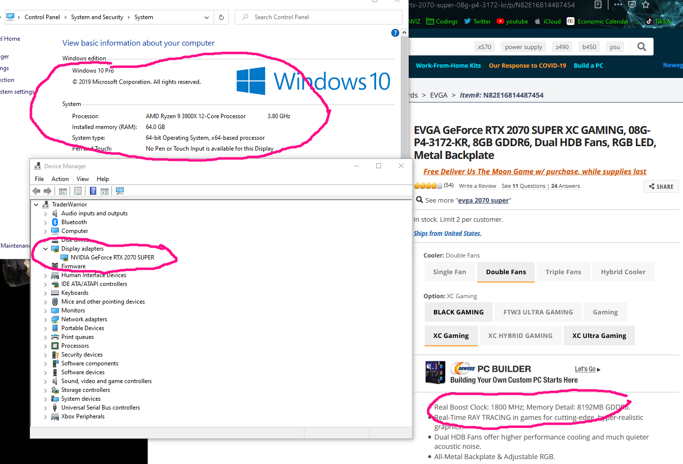

Edit: Yesterday, OpenGL works on main & 2nd instance. Today 2nd instance crashed so I turn off OpenGL on 2nd instance. On other days, main didn't. As I said above, u really don't know when or where the rioters going to show up to ruin your days.
Edit2: In case it's not obvious, it crashes during loading market depth, sometimes one day depth load helps, sometimes, it doesn't matter. Once it works, it normally not crashing anymore.
Edit3: I let 2nd instance running for 30min, change to OpenGL, exit then start new 2nd instance again. It works. Strange thing like this is how we learn to tolerate OpenGL. Pain in the ass if main doesn't work then we need to switch charts around.

imageSysSpecImg.png / V - Attached On 2020-06-05 12:27:26 UTC - Size: 208.47 KB - 853 views
imageGPUMemUsage.png / V - Attached On 2020-06-05 12:27:42 UTC - Size: 8.68 KB - 791 views

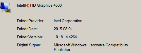

We will obtain the same video hardware that you have, thank you for the screenshot showing the hardware, and we will install the same driver. But we want more specific details regarding the driver. We need to specific details shown in the attachment.
We also need to get your Chartbook which you are using. Instructions:
Date Time Of Last Edit: 2020-06-06 10:27:27

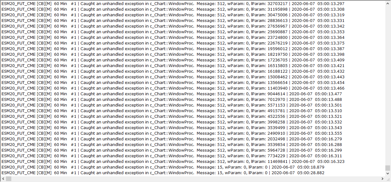

Attached is a chartbook to reproduce the errors. I know that the I have set volume at price multiplier in chart settings and in the profile study which is not necessary. If I only set it in the study no crashes on GL. But when I use the chartbook with both price multipliers with GDI it's stable!
Attached also a screenshot from the error messages when the freeze occurs.

imageSNAG_ 2020-06-07 - 12.00.39.png / V - Attached On 2020-06-07 10:05:25 UTC - Size: 114.27 KB - 735 views
