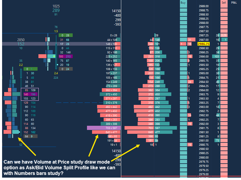

Hi
Would like to request an Ask/Bid Volume Split Profile option in the Volume at Price study.
Please see screenshot.
https://content.screencast.com/users/ninjus/folders/Default/media/6df31da1-b9d2-4cd8-bbb1-0ad4da4da036/05.31.2020-08.14.png
Thanks for your time.
imageVAP_bidaskVolumeSplitProfile.png / V - Attached On 2020-05-31 07:13:53 UTC - Size: 79.99 KB - 795 views

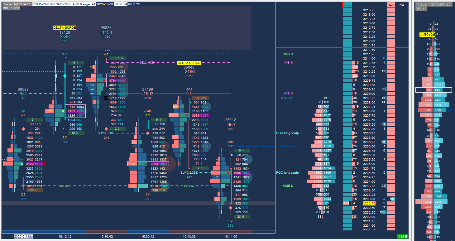

[2020-06-08 16:33:25]
ninjus - Posts: 33
And this will display in the fill space?
I am currently using 4h chart with numbers bars with no scale borders to the left of my chart DOM to at least have something.
I'd love to save the space.
I'd love to be able to use the draw profile tool as well haha. But I'll leave that wish with the SC engineers.
image4hoursplitprofile.png / V - Attached On 2020-06-08 16:32:57 UTC - Size: 165.92 KB - 523 views

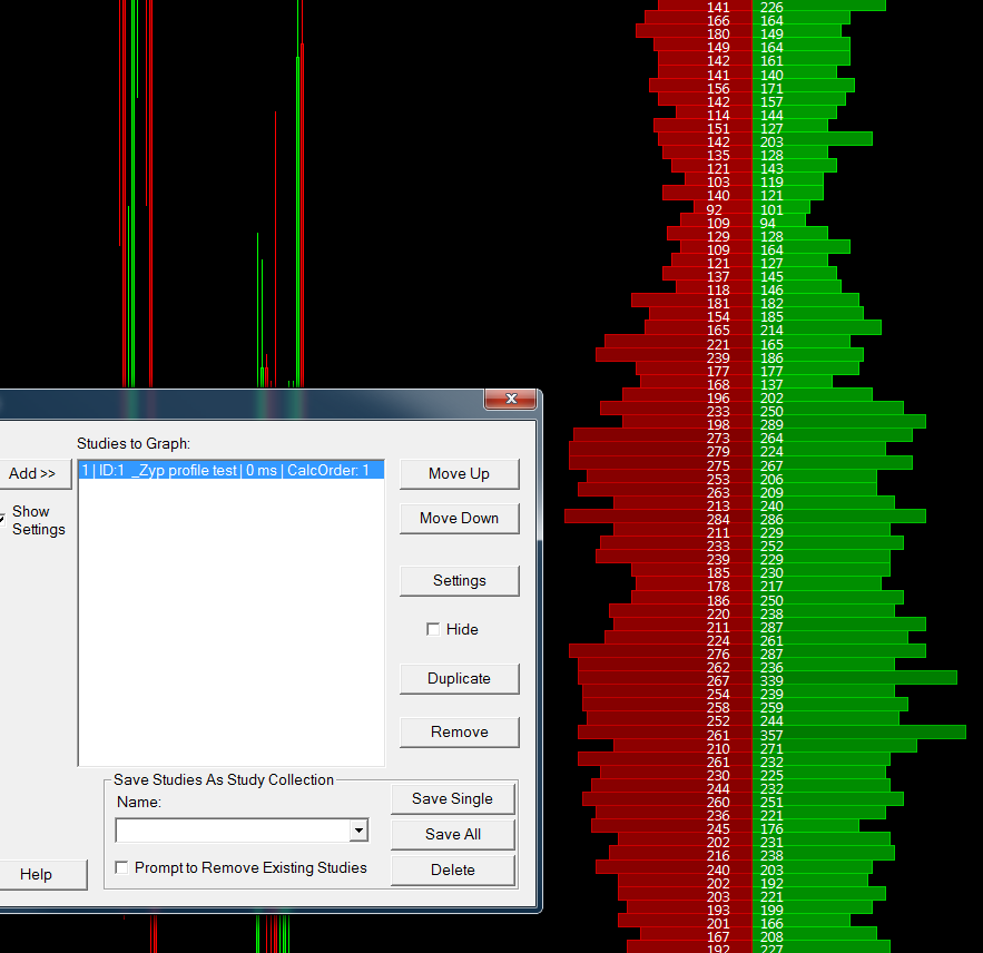

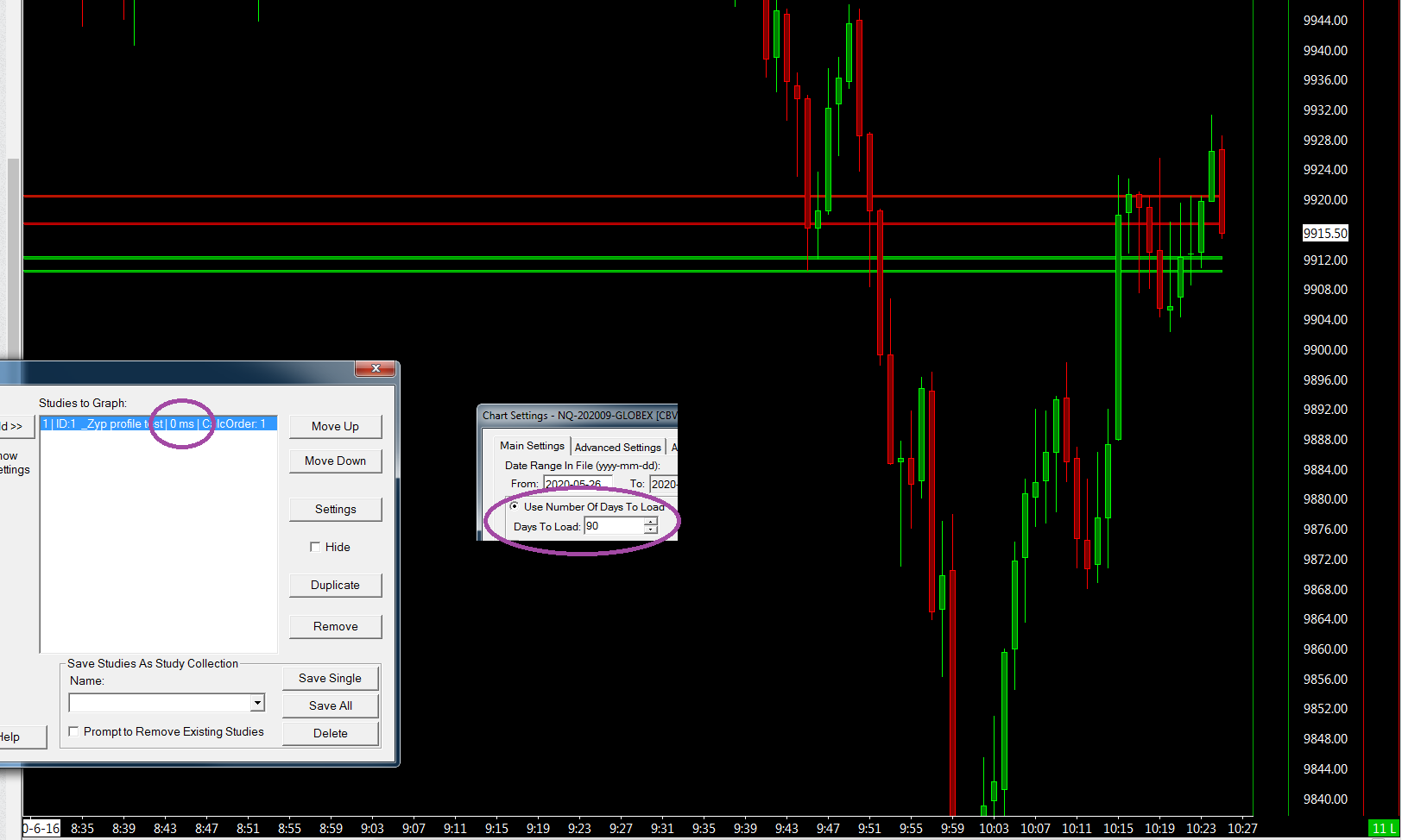

- Speed improvement (attached img for settings 500 bars back, 90 days loading ...for tests)
- Possibility to filter areas
- Switching: profile / SR zones

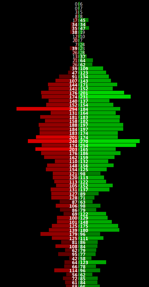

[2020-06-18 13:24:11]
Ackin - Posts: 1866
- user defined values filtering (treshold max/ min input ask bid volume)
- display inside chart without fill space
- New selection category in profile settings "Calculation method"
Ask Bid, Delta at_price .........
- Comparison of time bars and filtering of the same time bars or vice versa
- offset text
- another speed improvement (100.000 bars per 1ms), then there is a problem with refresh graphics - I do not use OpenGL .... rendering directly into graphics or GDI+ would probably speed it up
next:
diagonal imbalances
Date Time Of Last Edit: 2020-06-18 13:49:08
image_profile test9.png / V - Attached On 2020-06-18 13:24:06 UTC - Size: 83.21 KB - 503 views
