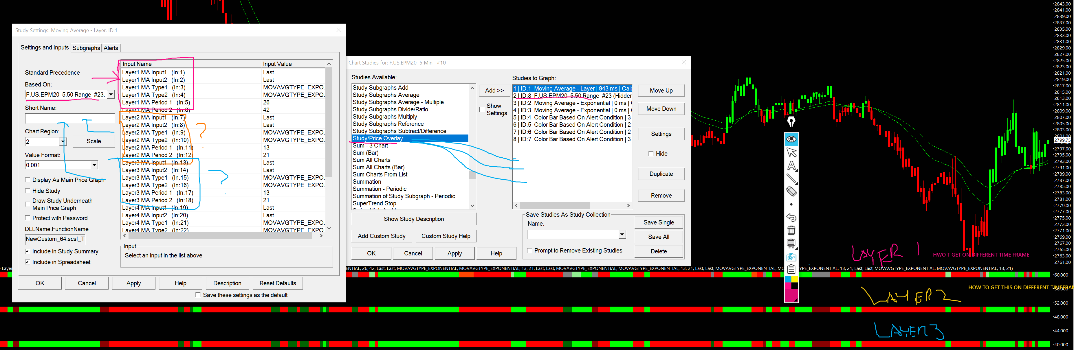

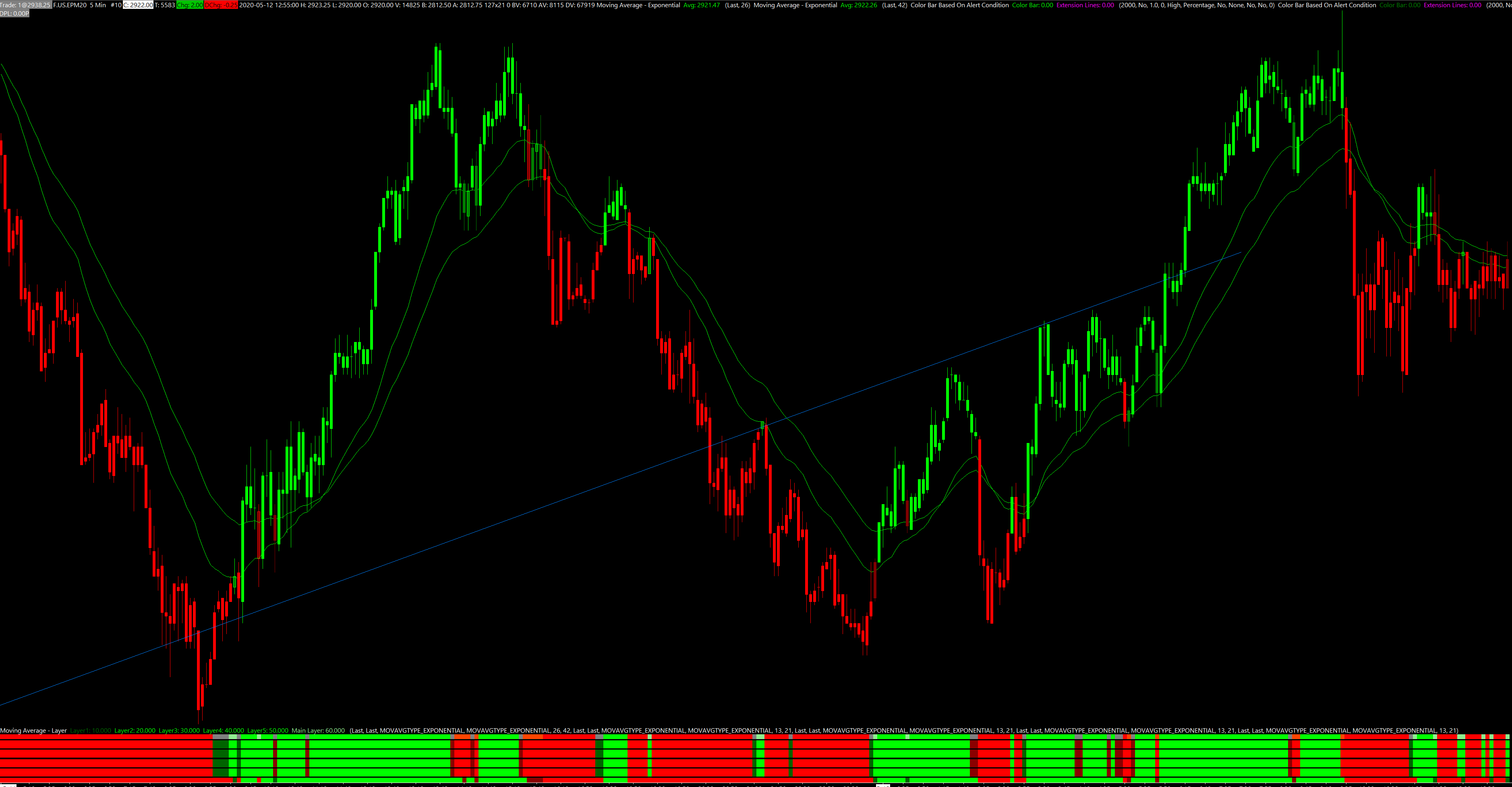

I am working on a custom indicator, nothing fancy its 5 colored layers that reflect various moving average positons. What I want to achieve is have each moving average reflects a different time zone. See attached image for how this indicator looks.
Initially in the settings, my goal was to add "timeframe" so that I could set type, period, and time for each moving average. But I believe this cannot be done, adding multiple time-frames (MTF) into the indicator directly. Each timeframe has to be added via the chart, so using Study/Price Overlay.
Using the Study/Price Overlay is fine, but it only allows one timeframe to be selected for the indicator as a whole, so all 5 layers ar set to either chart time, or Study/Price Overlay time. My goal is to have one timeframe per Layer, each of the colored bars.
I can of course just create the indicator with 1 Layer, and add 5 of them but this defeats the purpose and is quite messy on the charts.
So the question is there a way I can reference multiple timeframes to a single indicator, either via Study/Price Overlay or similar or via specific indicator coding?
Thanks Marc

imageMALaerSettings.PNG / V - Attached On 2020-05-14 01:42:19 UTC - Size: 89.34 KB - 827 views
imageMALayer1.PNG / V - Attached On 2020-05-14 01:42:24 UTC - Size: 250.98 KB - 1115 views

User497645 - Posts: 7
Please take a look at the attached screenshot. There must be a way to have a single indicator pull in multiple different timeframes, especially if using ACSIL.
I found this online, You are able to add multiple instances of the Study/Price Overlay study in order to overlay multiple price graphs and studies from other charts.
Once you have all of the chart bars and/or studies overlayed on the destination chart, then the next step is to reference the data in your custom study. Below is a code example that demonstrates this. The primary function that is used is sc.GetStudyArrayUsingID.
Referencing Other Time Frames and Symbols When Using the ACSIL
Then just create a dropbox or similar in the setting and inputs tab, so that you can connect the various Study/Price Overlays to the MA Layers, 1,2,3,4,5.
Thanks again, appreciate the help and support.
Date Time Of Last Edit: 2020-05-15 12:04:39
imageScreen Shot 5-15-2020 at 9.55 PM.png / V - Attached On 2020-05-15 12:04:31 UTC - Size: 336.05 KB - 788 views

[2020-05-15 19:18:28]
It sounds like you know what to do in post #5.
Yes you can do this in ACSIL in a single study as you understand in post #5.
