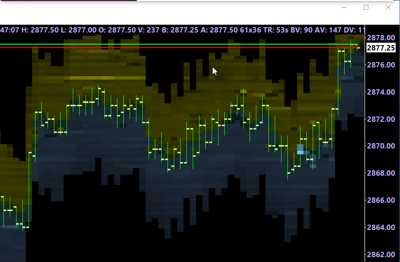

I am having a problem with Market Depth Historical Graph. When price trades through liquidity it remains on the graph (first screenshot)
A few minutes later it updates (second screenshot)
This keeps happening, has never been an issue previously.

Another example of the graph not updating.
http://www.sierrachart.com/image.php?Image=1588102296484.png
http://www.sierrachart.com/image.php?Image=1588102537206.png
It is updating in the DOM and market depth window..
Many Thanks
Date Time Of Last Edit: 2020-04-28 19:35:49

Chris_uk - Posts: 89
They remain the same, but they continue to update on dom and market depth window
http://www.sierrachart.com/image.php?Image=1588103116357.png
it has been starting and stopping all day, no issue previously as stated earlier

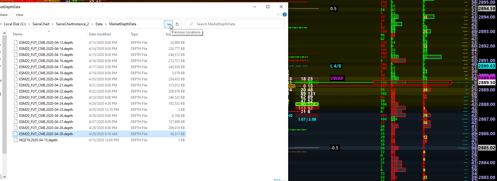

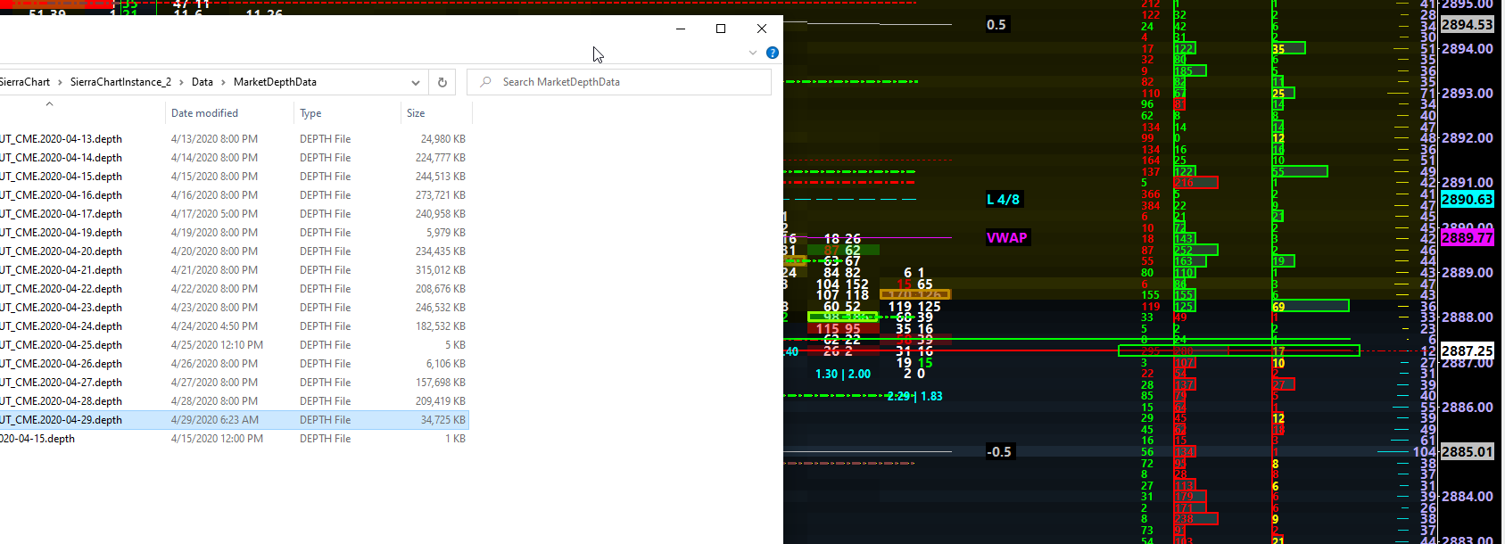

User48838 - Posts: 134
I am not sure if this is the example you were looking for re the MarketDepthData file but this is what i see when it is stuck right now. First shot shows the Market Depth Historical Graph stuck and the file size at 34,511, the 2nd shows the study still stuck and file size has increased to 34,557
image2020-04-29_6-19-13.png / V - Attached On 2020-04-29 10:24:39 UTC - Size: 148.27 KB - 366 views
image2020-04-29_6-21-05.png / V - Attached On 2020-04-29 10:24:50 UTC - Size: 155.08 KB - 407 views
