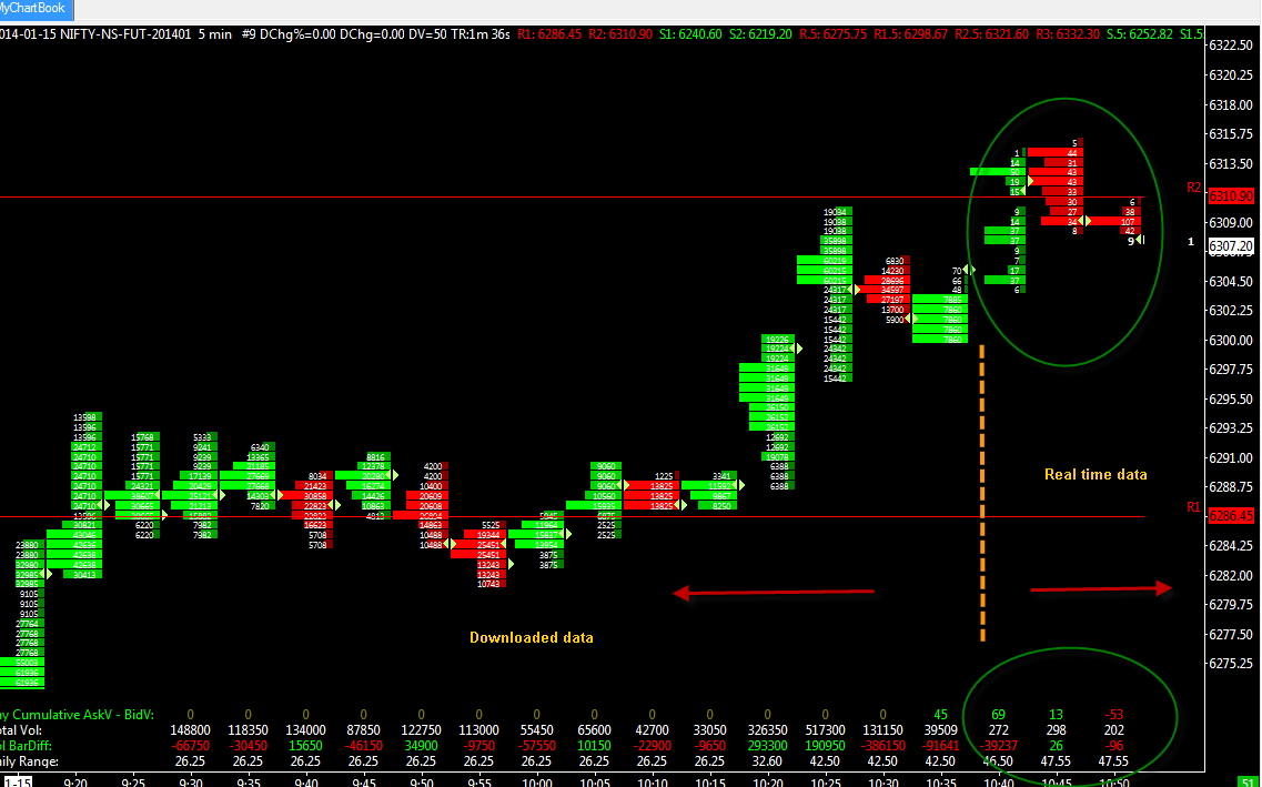

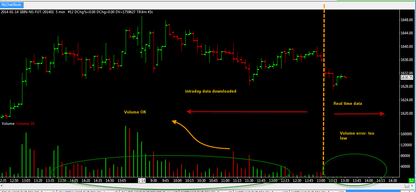

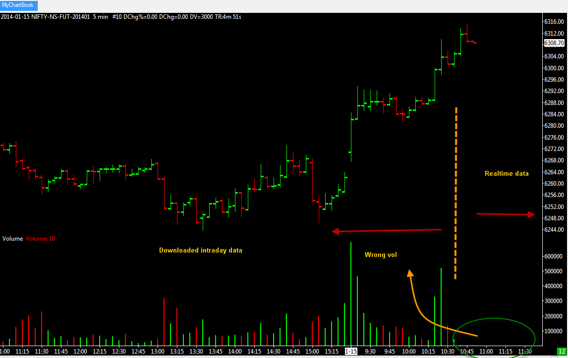

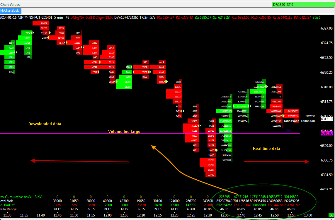

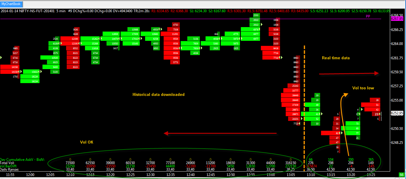

I have recently started using Global Data Feeds (I) as my data vendor. Sierra Chart is connecting very well with this and I can download all historical data. I am having one problem. The historical (and intraday) data is showing correctly ( Volume as well as price) but the realtime data is showing errors in volume. All volumes in the realtime chart is incorrect. I asked GDFL support and they say that there is no error from their side.

[2014-01-14 08:27:16]
We need to ask Global Data Feeds about this.
Possibly we need to multiply the real-time volume by 100? Not really sure.

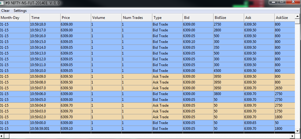

I still do not find any changes.I followed your instructions and restarted SC. Chart is still showing wrong volume in real time. For your information Time & sales and quote board is showing correct Bid and ask volumes.

[2014-01-15 06:24:01]
Thanks for these images. We have reported the problem again to Global Data Feeds.

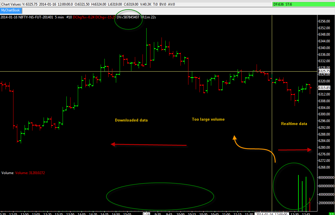

Downloaded and installed version 1078. Now the volume in real time chart is too large. Attached images.

[2014-01-16 07:53:53]
We have an idea what is causing this. Give us about one hour to take care of it.
This data feed works in a nonstandard way, so the way in which it works is not so well understood. And the documentation does not make it clear.

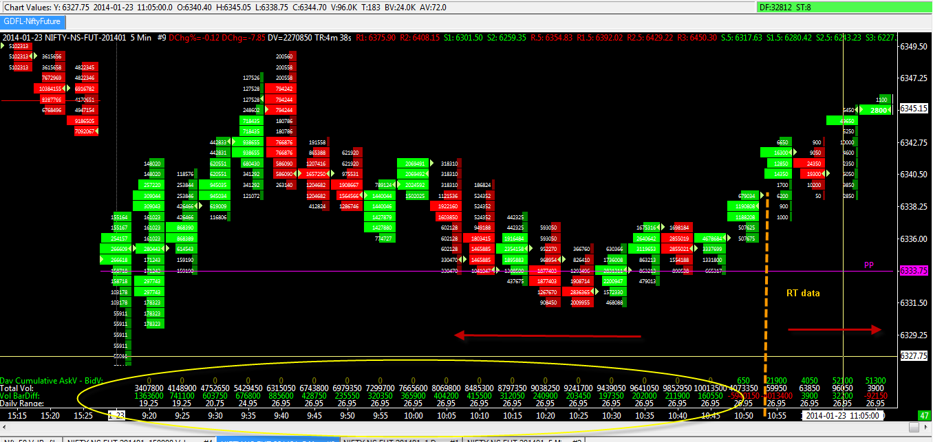

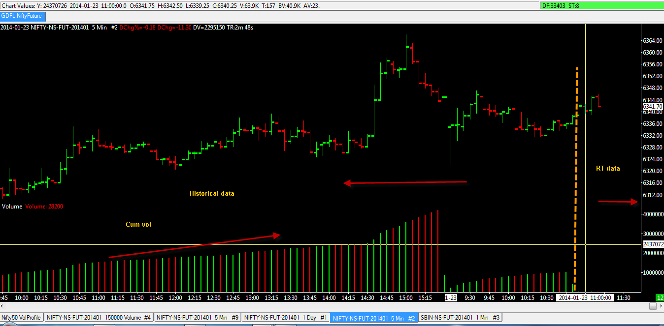

I have downloaded and installed ver 1081. Now the problem is completely different. RT data seems to be ok but the historical data is very high. Seems to be cumulating at every bar.

[2014-01-23 06:55:37]
We will let Global Data Feeds know about this. Must be an issue on their side because there is no function in Sierra Chart Market data processing which would cause this.
[2014-01-23 09:40:12]
This is happening due to changes that Global Data Feeds has made to the market data messages and we did not implement the corresponding changes with the historical data processing. We will be doing that in the next release. It will be out later today.

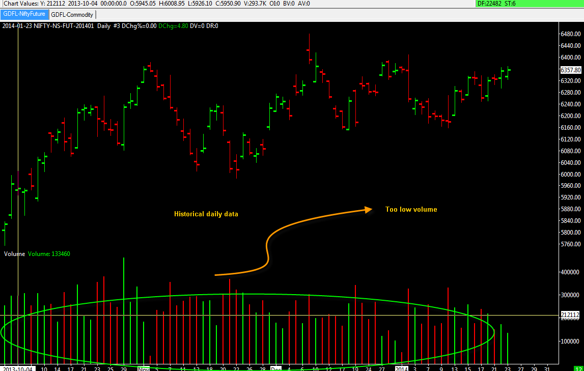

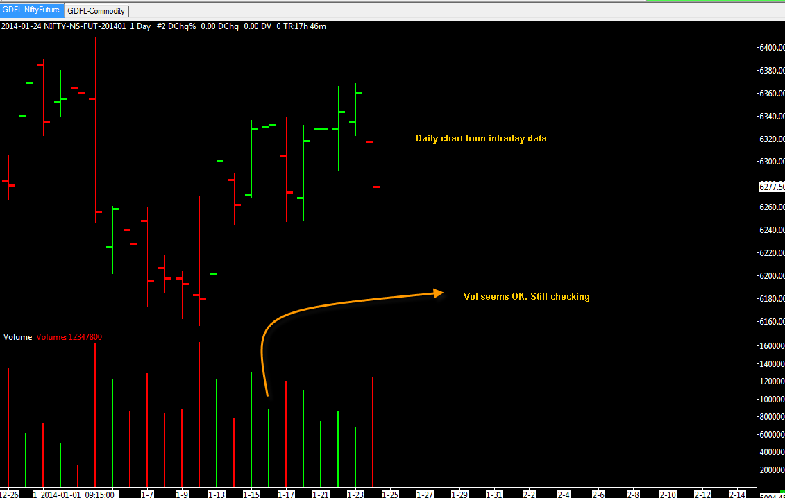

turnbull - Posts: 34
Intraday historical day seems OK. Checking RT data. Now Historical daily data is a problem. It is too less. Let me know if I am wrong.

[2014-01-25 01:08:28]
We will have to contact Global Data Feeds about this.
[2014-01-28 08:49:40]
From Global Data Feeds:
We have found out the issue.
The intraday volumes are coming in weights whereas the day end volume are coming in lots. So you are finding the difference.
We will check how we can address this issue.
