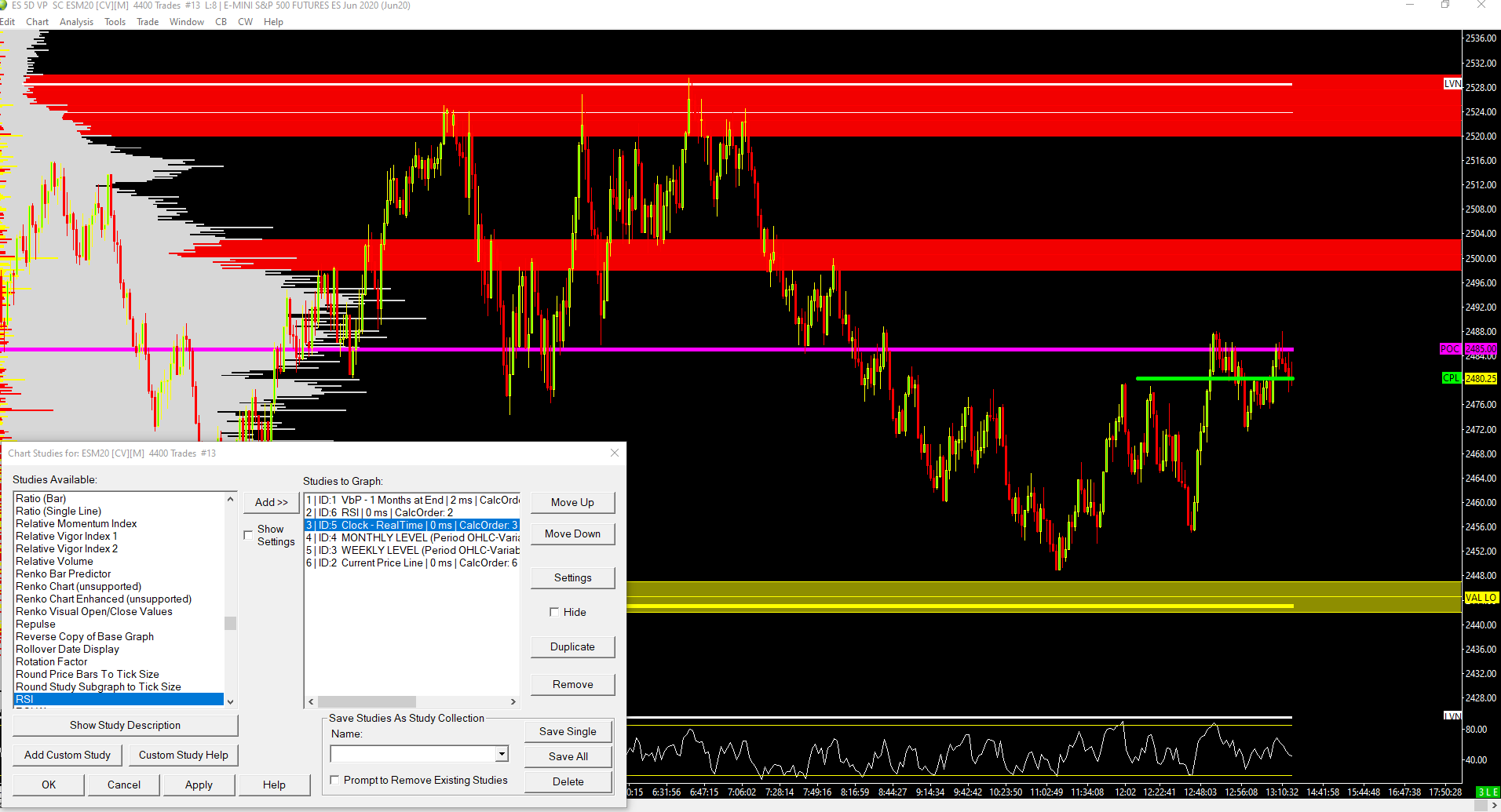

I've the clock - realtime study on most of my charts. I see that some charts show the time while most are not showing it. Is this due to a specific setting? I've attached a screenshot as example.
It is enabled and not hidden.
imageSC - Clock study.png / V - Attached On 2020-04-05 17:04:19 UTC - Size: 118.11 KB - 848 views

Ackin - Posts: 1866
Just idea:
Try mark study "Clock-realtime" and then using the button "Move Down" move study to the last position in the window (studies window as on your attached picture)...because it is possible that the study is graphically overlapped by another study.

[2020-04-05 18:52:39]
Oxcap - Posts: 81
Thanks. I tried that just now and didn't work.
[2020-04-07 12:13:40]
There is a setting on the Clock - Real Time study for Draw Above Main Price Graph. Set this to Yes to have the Clock drawn above the other items in the chart.
If you do not have this option in the study, then update to the latest release to have this available.
Also try removing the study from the chart and adding it again.

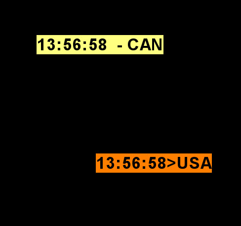

JohnR - User831573 - Posts: 340
OK, Since there have been many to help me with my coding issues, Here is a simple give back. I've attached a screen shot, .cpp source file, and compiled .DLL which can be added to your Data directory.
I've modified the ClockRealTime to now allow text to be added to the end of the display. I call it MyClockRealTime. I have include source as well as the prebuilt DLL. This is my first time offering code. It can be added to User Contributed Studies, or used to modify the built in original - if SC chooses to do so. Basically all I did was change the name of the DLL, Study and Graph Name. Then add an additional input [9] for the text and added 1 line of code to add the text to the original string.
--> RemainingTimeString += Input_MyTimeZone.GetString();
Hope this helps,

[2022-10-20 21:34:32]
User132988 - Posts: 13
Thanks John! I cant see the DLL to test it out though :)
[2022-10-21 02:25:00]
Try again, The DLL file was marked private. I am not sure it that was by default, or if support changed it to private as it is an executable. Hopefully, I am not doing something 'wrong' by making the DLL file "Public".
JohnR
Date Time Of Last Edit: 2022-10-21 02:27:24
[2022-10-21 03:20:03]
Thanks! ill try and get it working :) not familiar with custom studies, ill work it out. Thanks John!
