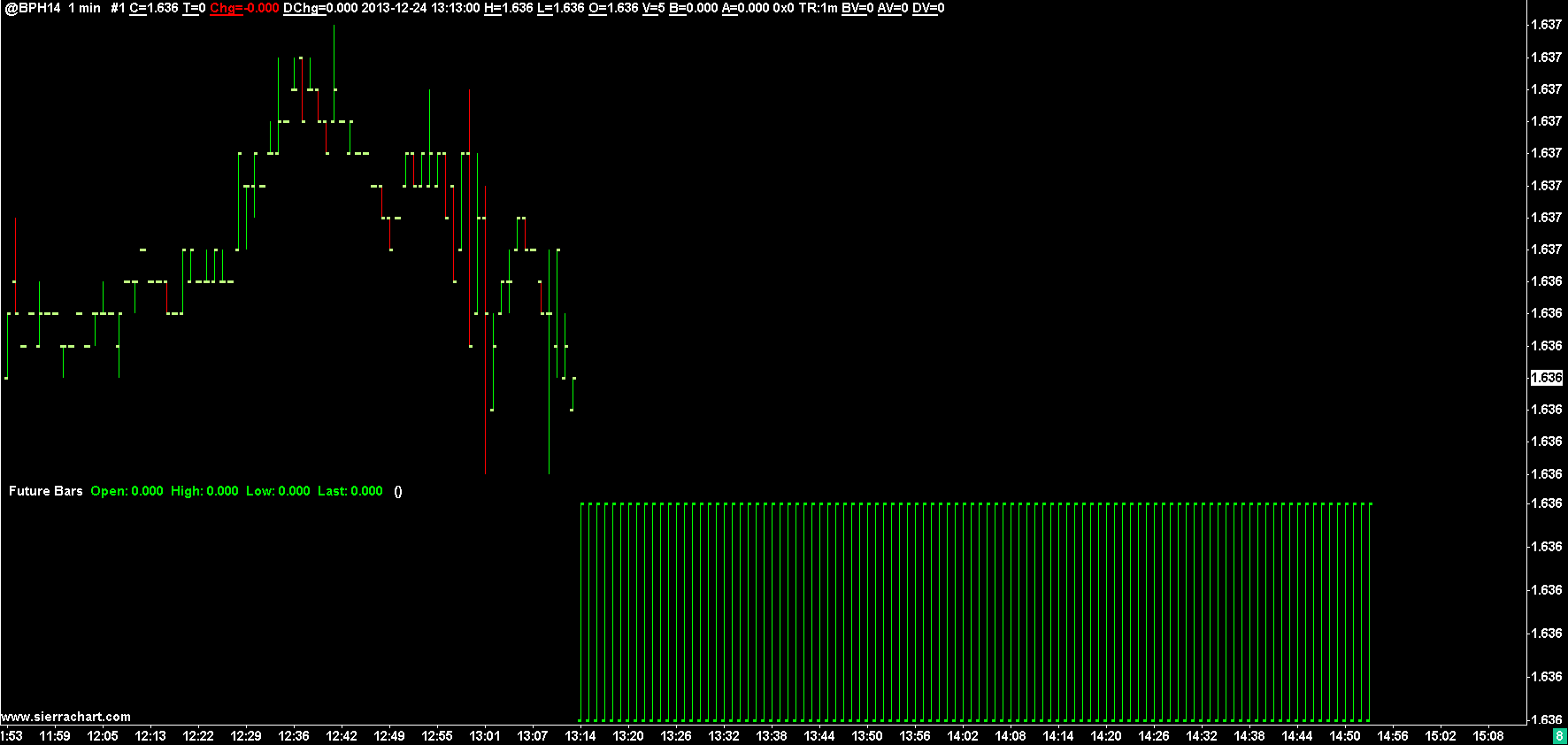

[2014-01-14 07:16:25]
Here is an example of drawing bars into the forward projection area:
http://www.sierrachart.com/image.php?l=1389683535406.png
SCSFExport scsf_ForwardProjectionBars(SCStudyInterfaceRef sc)
  SCSubgraphRef Open = sc.Subgraph[0];
  SCSubgraphRef High = sc.Subgraph[1];
  SCSubgraphRef Low = sc.Subgraph[2];
  SCSubgraphRef Last = sc.Subgraph[3];
  if (sc.SetDefaults)
    // Set the configuration and defaults
    sc.FreeDLL = 0;
    sc.GraphName = "Forward Projection Bars";
    sc.AutoLoop = 1;
    sc.GraphRegion = 1;
    sc.GraphDrawType=GDT_OHLCBAR;
    Open.Name = "Open";
    Open.DrawStyle = DRAWSTYLE_LINE;
    Open.PrimaryColor = RGB(0,255,0);
    Open.DrawZeros = false;
     Open.ExtendedArrayElementsToGraph= 100;
    High.Name = "High";
    High.DrawStyle = DRAWSTYLE_LINE;
    High.PrimaryColor = RGB(0,255,0);
    High.DrawZeros = false;
    High.ExtendedArrayElementsToGraph= 100;
    Low.Name = "Low";
    Low.DrawStyle = DRAWSTYLE_LINE;
    Low.PrimaryColor = RGB(0,255,0);
    Low.DrawZeros = false;
    Low.ExtendedArrayElementsToGraph= 100;
    Last.Name = "Last";
    Last.DrawStyle = DRAWSTYLE_LINE;
    Last.PrimaryColor = RGB(0,255,0);
    Last.DrawZeros = false;
    Last.ExtendedArrayElementsToGraph= 100;
    return;
  // Do data processing
  //Repeat last bar into forward projection area.
  if(sc.Index+1 >= sc.ArraySize)
    for (int Index = sc.ArraySize ; Index < sc.ArraySize + Open.ExtendedArrayElementsToGraph ; Index++)
      Open[Index] = sc.Open[sc.Index];
      High[Index] = sc. High[sc.Index];
      Low[Index] = sc. Low[sc.Index];
      Last[Index] = sc. Close[sc.Index];
  return;
The below code makes no consideration to the indexes to use for PriceArray [] that correspond with ForecastOverlay []. You will need to work out these details. We recommend looking at this page:
http://www.sierrachart.com/index.php?l=doc/doc_ACSILRefOtherTimeFrames.php
int NumberOfBarsToForwardPlot = ForecastOverlay.ExtendedArrayElementsToGraph;
if(sc.Index >= sc.ArraySize)
for (int i = sc.ArraySize;i < sc.ArraySize + NumberOfBarsToForwardPlot ;i++)
ForecastOverlay[i] = PriceArray[i];
