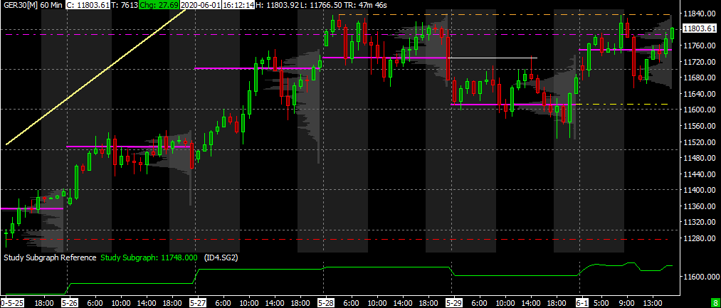

I never used "Study Subgraph Reference" but it's ingenious. It creates a "trail" of PoC's previous values so we can test for SG1<SG1[-1] and so on.
I gave it a quick test by replaying the chart at high speed. Seemed to work most of the time except small changes. Which probably get missed because I bunched up a few DAX points into a single VbP bar. This seems to speed up calculation and makes the histogram easier to read. I can live with this. Now testing on the live chart.

This is how I use the VbP study - calculated for the day and PoC highlighted.
http://www.sierrachart.com/image.php?Image=159102073760.png
The PoC moves up/down during the day and I pay attention to this. Hence wanting to make it audible.
