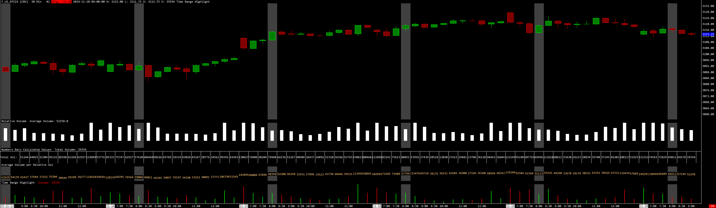

I have noticed an issue with the average volume part of the relative volume study that seems to lead to inaccurate relative volume output.
The chart (link below) has the volume numbers based on the Numbers bars calculated values study for each half hour period and an overlay of the average volume calculated by the relative volume study.

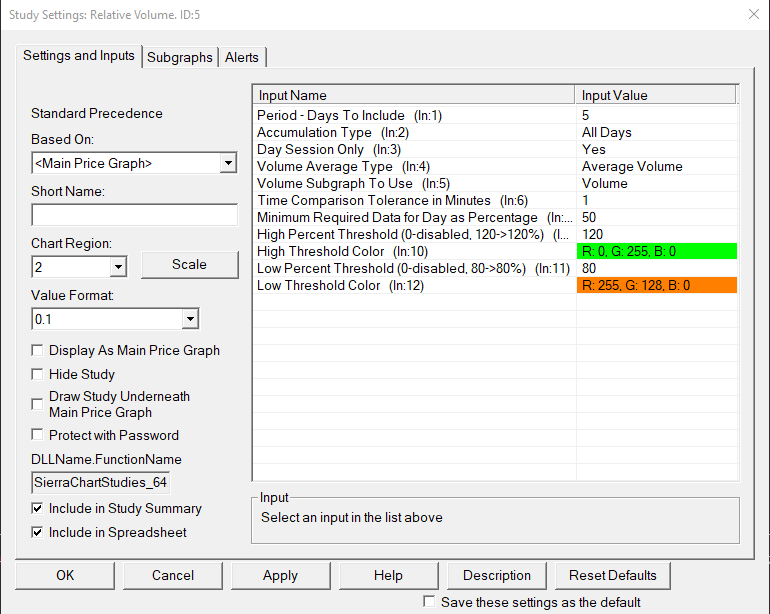

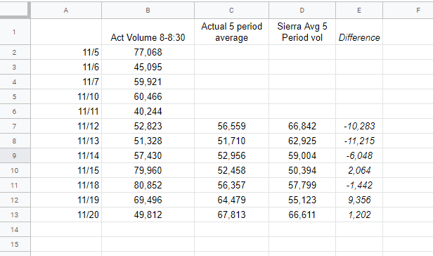

I have attached an image of my calculations for a 5 period average compared to the relative volume's calculation for a 5 period average and the difference (all for the 8-8:30 time frame, which is highlighted in the chart). Additionally I attached an image of my relative volume settings. Please let me know if I am making a mistake somewhere or there is an issue with the study's calculations. Thank you.

Set the Input in the Relative Volume study for Minimum Required Data for Day as Percentage to 0. Refer to the information for this Input here:
Relative Volume: Inputs
And also understand that the average volume for a particular chart bar does not include the volume for that bar.

We took a look at your chart and specifically at the calculation for the Average Volume on November 20, 2019 for the 08:00 bar, which matches the data you displayed in your image. The Average Volume calculated by the Relative Volume study matches your calculations exactly. The value is 67812.4, and you showed a value of 67813.
Refer to the data below.
We do not know where you got the value of 66,611, as we do not see that anywhere near that particular bar.
The one thing we want to point out is that you do not have the Average Volume being displayed in the Tool Values Window, so we do not know how exactly you determined the value from the Relative Volume study.
