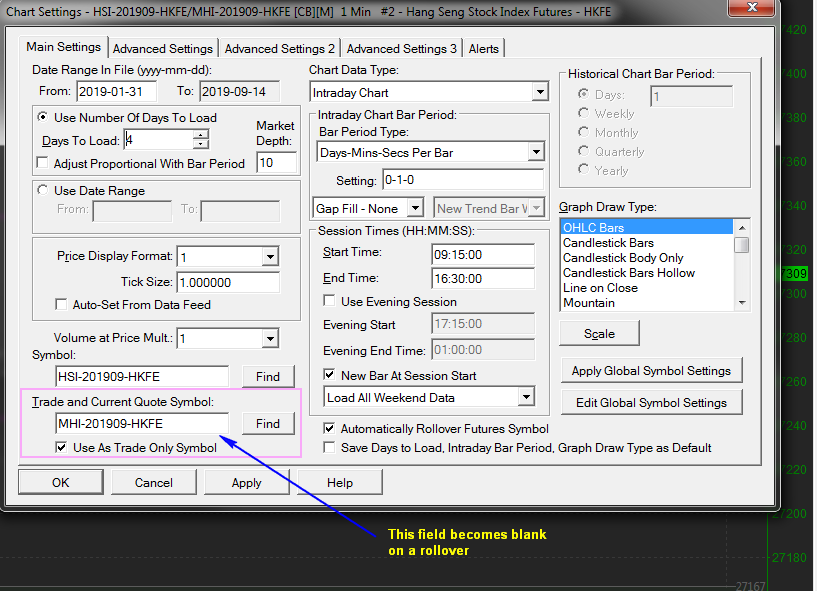

User19165 - Posts: 346
I don't understand the reply from support. I believe what the original post is referring to, is this field in the chart settings as per screenshot. They are absolutely correct that when the main chart symbol rolls, you fully delete the entry in the highlighted field and it needs to be re-entered. Has caused me to enter trades on the wrong contract more than once and it would be great to have this rectified.

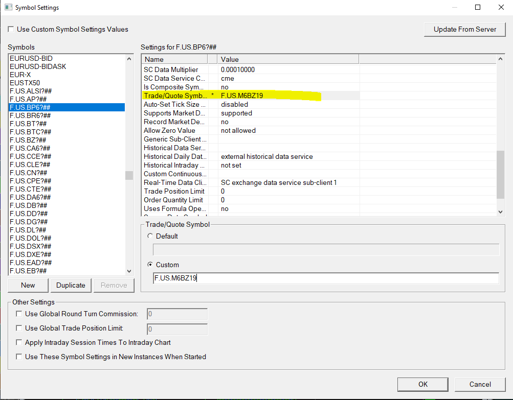

[2019-09-14 03:11:46]
Rrrracer - Posts: 20
Yep, I found it, that should be it... if you don't hear from me in three months you'll know it works LOL. Too bad I have to do it for 60 charts haha, but once it's done it's done.. better than having to do it every 90 days LOL. Thank you very much for the help... Sierrachart rocks!

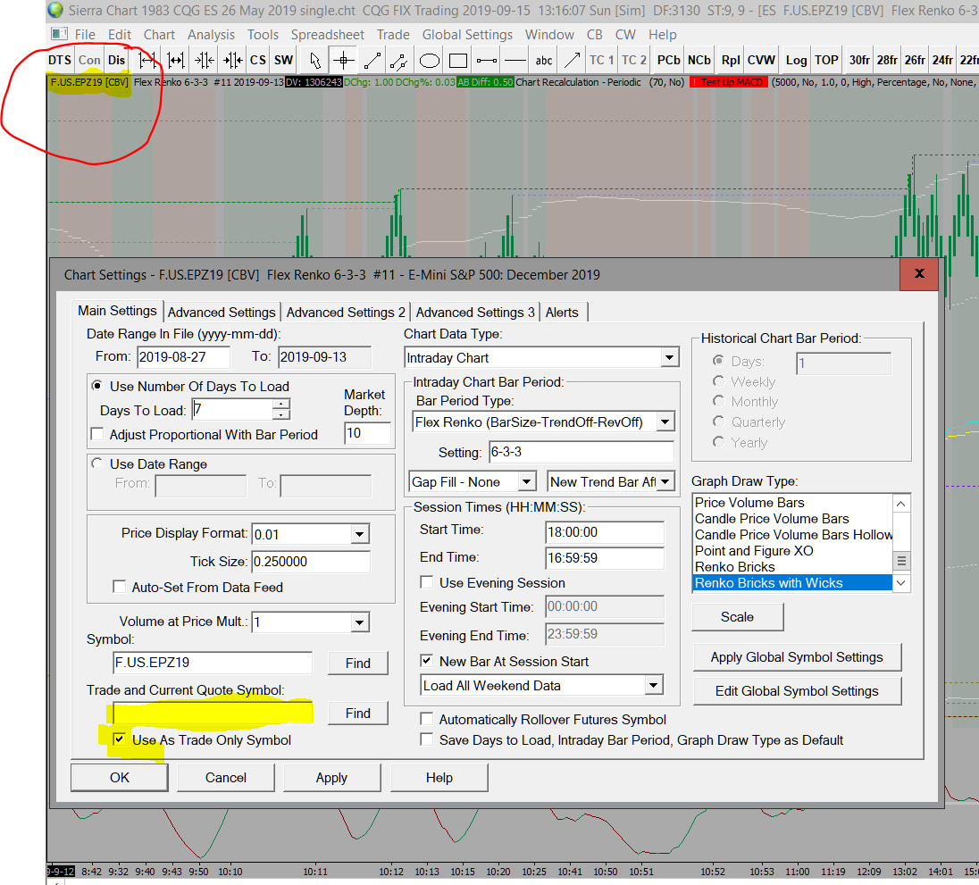

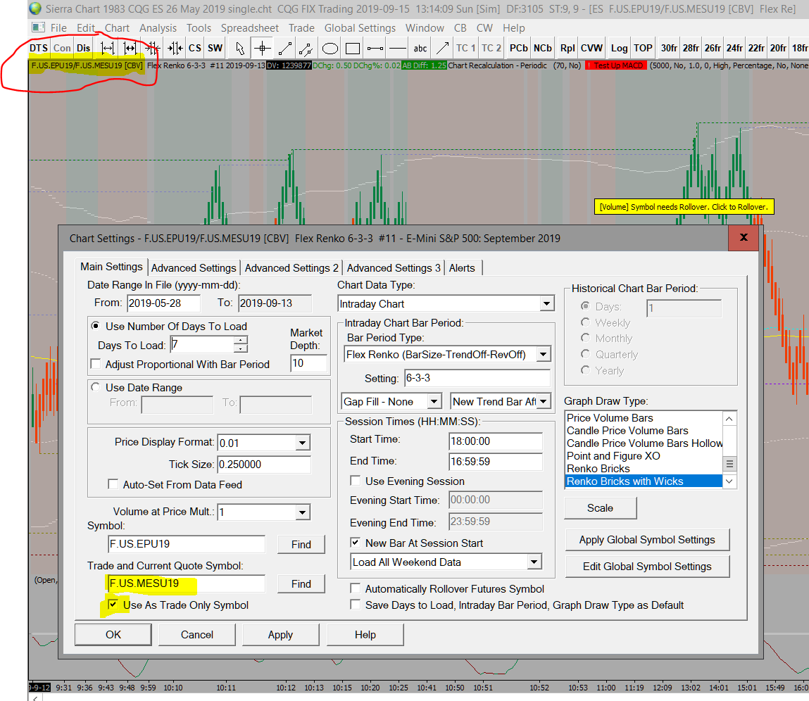

User13668 - Posts: 296
I am sorry SC, but I beg to differ.
Two screen grabs attached of the ES/MES before and after rollover.
On the pre rollover picture I simply click on the Yellow dialogue box to perform the rollover.
As you can see in the post rollover picture the reference to the micro traded contract has gone. It has also gone from chart settings.
So clearly in your proof of performance you must be undertaking the rollover a different way to what I have been doing by selecting on the yellow dialogue box.

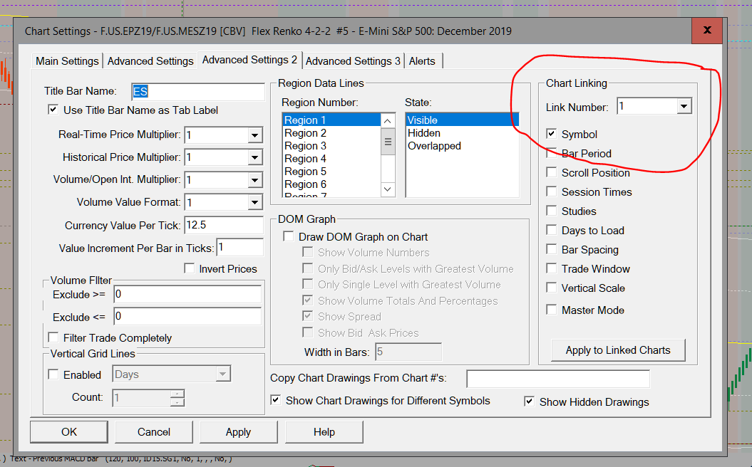

Hi SC,
Re post #9 and 12.
So there must be a difference between your test setup and my actual trading setup.
Thinking out loud I wonder if the issue is to do with Chart Linking?
In my setup I have a Chartbook for ES/MES that comprises several charts that are all Linked (see attached screen grab) eg Daily, 30 minute, RTH 30 minute and a Flex Renko chart (the one I place trades on).
Now I only have the Flex Renko chart (the one I place trades on) setup with the micro contract/symbol as the symbol to be actually traded ie place trades on the MES not the ES.
All the other charts are just configured for the ES only.
But ALL charts are linked as mentioned earlier.
So I wonder if the logic behind the Linking process is 'dropping' the rolling of the micro (MES) contract because none of the other charts that are linked are configured with this 'trade only' symbol.
And/or I am not selecting the correct options when I am Linking charts (see attached picture again) ie maybe there are other items in this list I need to tick to get the micro contract to roll as well.
