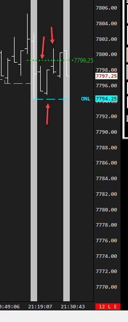

Thank you. It tried that condition and I see little difference. I will share screenshot here.
imageGlowImage.jpg / V - Attached On 2019-09-11 17:41:13 UTC - Size: 39.18 KB - 423 views

Sawtooth - Posts: 4359
The formula in post #2 will only alert when the Close price crosses the +5 line from above, and only from the previous bar.
Do you want an alert on every bar that closes between the +5 and the ONL ?

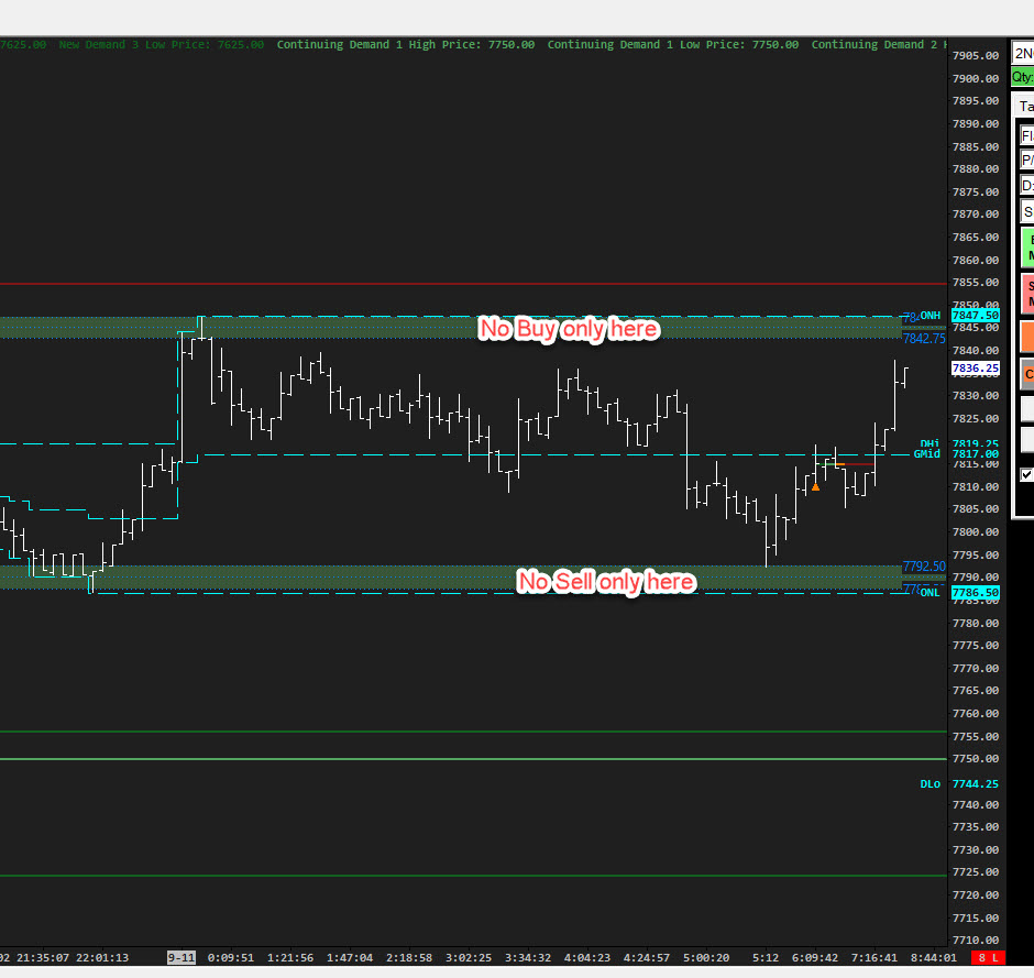

Chippstrader - Posts: 31
Thank you. I will check it out. My idea is in graph. I want to just ignore buy or sell only those areas and system can take trades remaining areas.
Thank you for replying. Please don't bother to reply if it consuming too much time of yours.
imageGlowImage2.jpg / V - Attached On 2019-09-11 23:43:32 UTC - Size: 179.38 KB - 467 views
