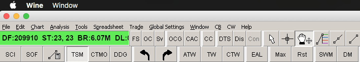

These are some install notes for Sierra Chart on macOS. I moved from Parallels to wine because the overal performance is better. There is no delay when you activate the app. Also, I/O should be faster as your disk is not virtualized. The 64 bit version of Sierra Chart stopped working after build 2011. install wine-stable with brew brew cask install xquartz
brew cask install wine-stable wine --version # wine-5.0-rc6 install Sierra Chart cd ~/Downloads/
wine SierraChartFileDownloader.exe 64bit -> you must specify the 2021 build, credit Zombiekray 32bit -> you can install more recent versions (incl. 2083) manually start the 32 bit version (for recent builds) cd ~/.wine/drive_c/SierraChart
wine SierraChart.exe Tested with macOS High Sierra 10.13.6 / Sierra Chart 2083 / wine-5.0-rc6 / xquartz 2.7.11 Date Time Of Last Edit: 2020-04-13 16:22:20
