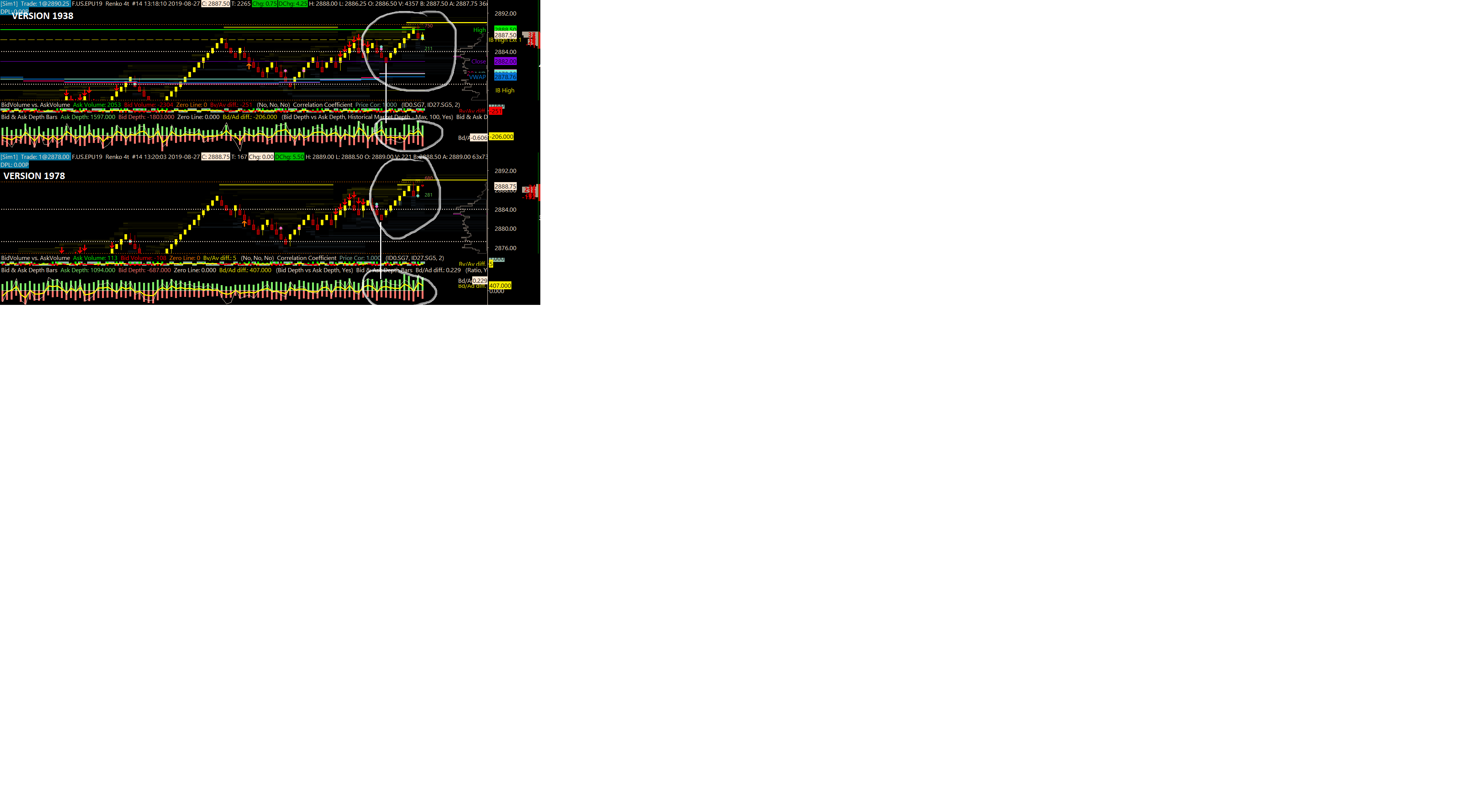

NotIll - Posts: 122
Please look at the image I attached.
It is the same market and same data, yet the newest version just changes the bid ask data. what is going on here?
The difference on the big up thrust is also very much telling. It cannot be that an update does this to actual market data.
I have looked and the changes happend after 1941 which is the same what User41727 has found.
please reverse this.
Date Time Of Last Edit: 2019-08-27 13:19:09

[2019-08-27 15:41:34]
User41727 - Posts: 124
What we can say is that the new implementation of Bid and Ask Depth Bars is very accurate.
I don't doubt that. The values for the ratio calculation seem to be as expected with the new version based on the bid size to ask size ratio, but they are still often enough notably different from what the old version would calculate.
I have looked into this a bit more, and I was using "Historical Market Depth - Last" as "Source Data" with the old version. From a cursory glance, the values calculated by the old version seem to be identical to the new version when using "Time & Sales" instead. Unfortunately, the documentation was never particularly clear on what exactly using the historical market depth as data source actually meant, and how exactly it differs from using T&S when only L1 quotes are available anyway. Maybe you could shed some light on that?
In any case, I would greatly appreciate it if you could implement a way for the new study version to behave just as the old one did with the depth data.
