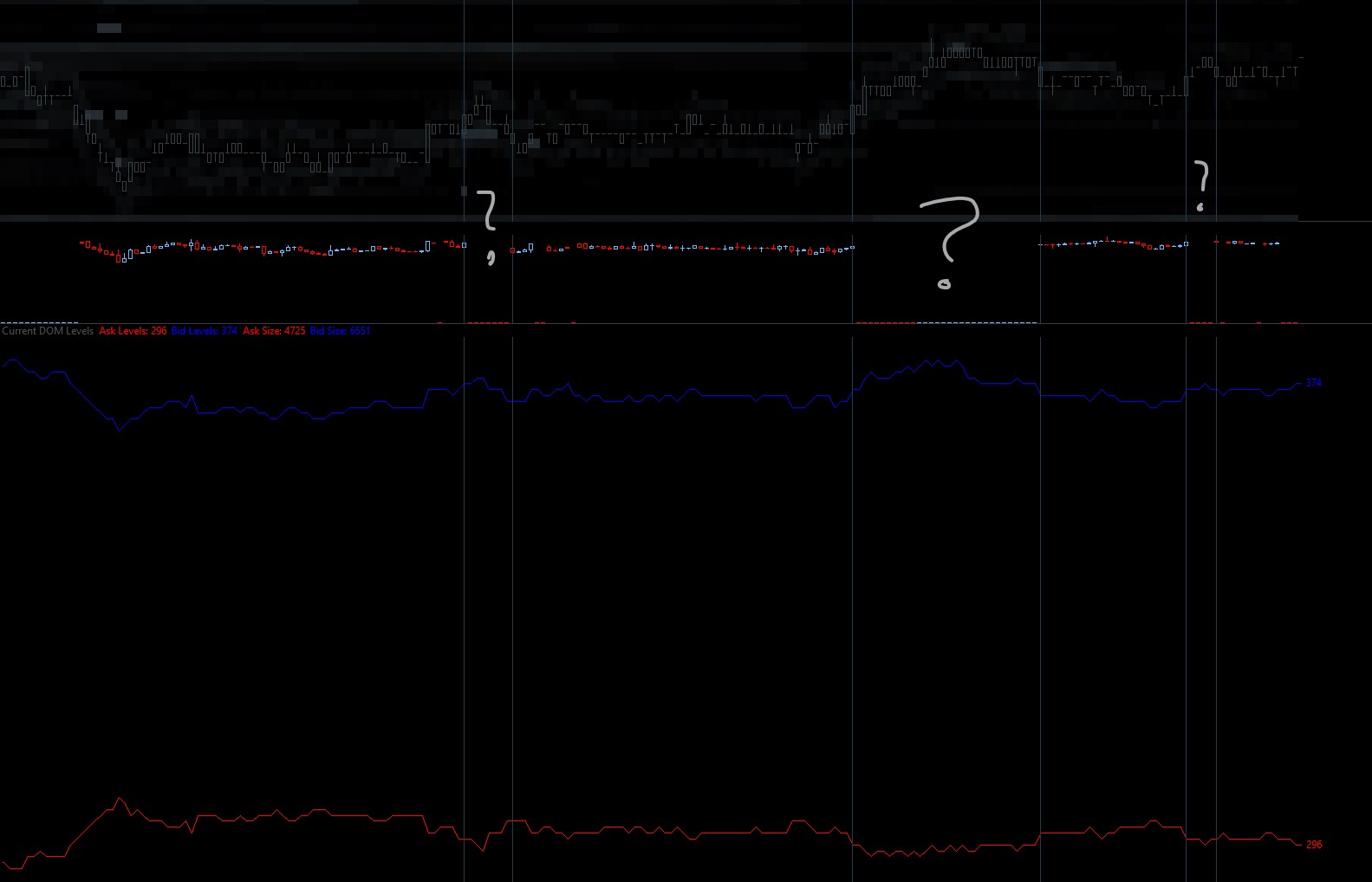

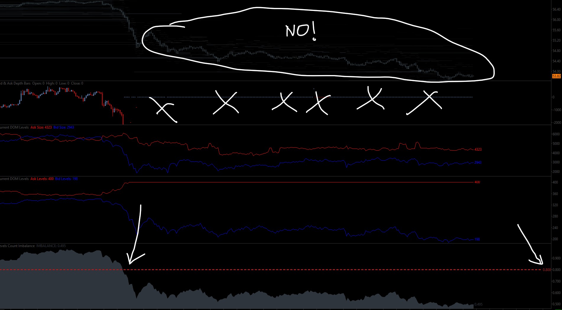

Please stop filtering and calculate depthbars regardless of number of levels imbalance!
The filtering we do is based on imbalance between the number of levels on the bid side and ask side. If the imbalance is exceeding more than an 80% difference between the number of levels on the bid side and ask side, then we skip doing any calculations on that current market depth state. Normally there will be a balance.
Your assumption of balance as normal state is totaly wrong. Depending on market the number of levels can be very different. Yes it offsets the market but thats all. It shouldn't affect the study calculation!
Please see the screenshot. Blue and red line is current number of available levels for bid and ask side. You will see many price bars without study being calculated which is just wrong. As soon as number of levels got below 80% imbalance it started to calculate again. No idea what was your plan here. Whats wrong with different numbers of levels??? It's the true market and you should represent it correctly as it is.
Please remove your filtering rule. Thank you
Date Time Of Last Edit: 2019-07-30 20:08:02
imageimbal.jpg / V - Attached On 2019-07-30 19:40:03 UTC - Size: 35.01 KB - 761 views
imageimbal2.jpg / V - Attached On 2019-07-30 20:01:17 UTC - Size: 104 KB - 658 views

over the last couple of hours on 1958 i’ve been getting big gaps in my sierra depth bars of about 5-10 minutes, is this related? looks like the difference between bid and offer is around the 80% mark so this would confirm the thread creators idea
agreed, please remove this restriction

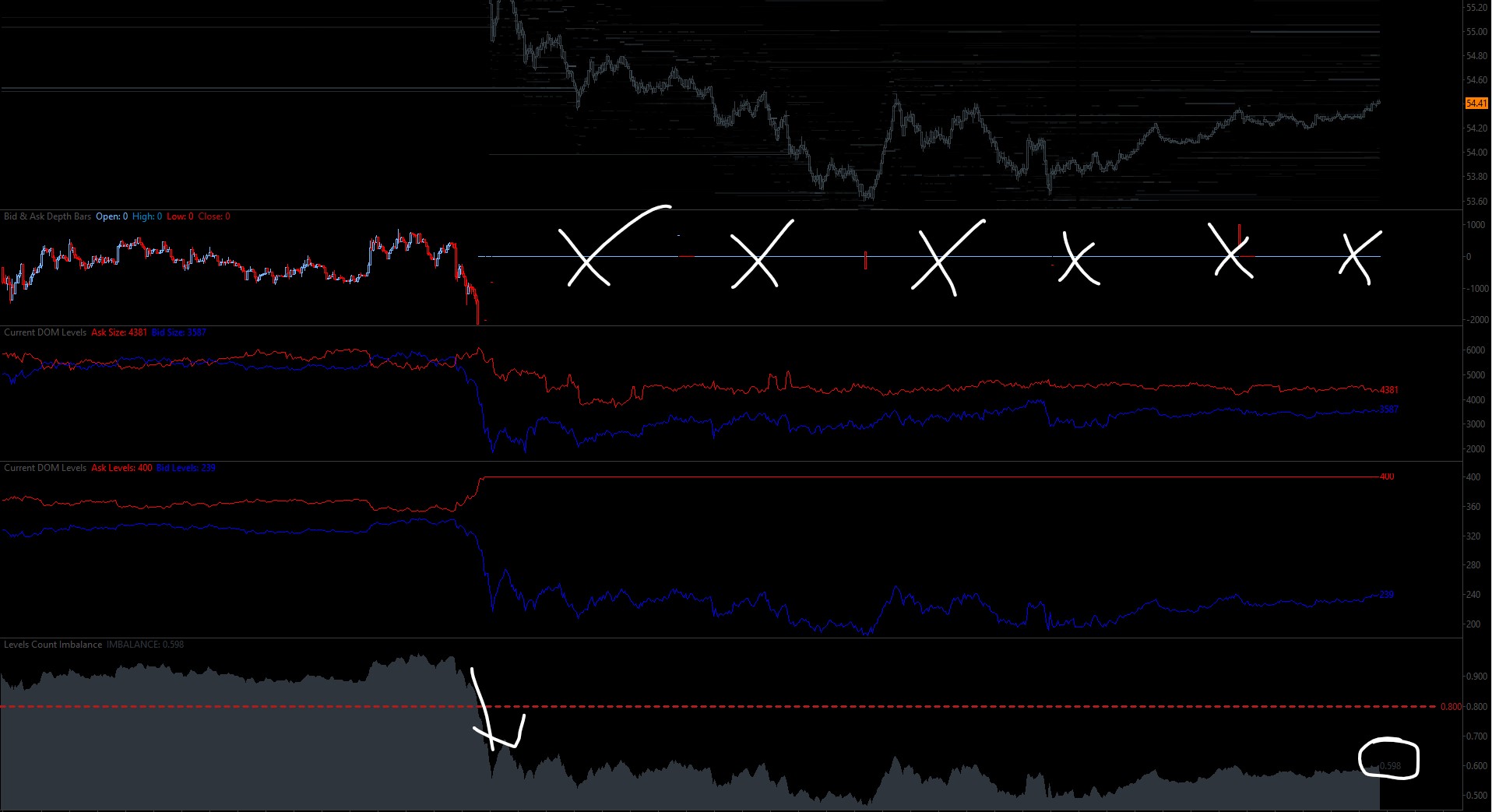

Crude day session just starting and I have over 15 minutes of depthbars not working just because theres levels imbalance over 80%! Build 1963.
Please remove imbalance filtering asap! We need to see the market as it is! Thank you.

We need some time to look this over. Do you see Bid and Ask Depth Bars appear where they are missing, when you set this setting to 50:
Chart Settings: Maximum Market Depth Levels (Chart >> Chart Settings >> Market Depth menu)
The solution to the problem is to limit the number of market depth levels used in the calculation. Limit it to no more than 300.
With the recent changes made to CQG market depth processing we probably do not need the imbalance check in that particular case but it may be applicable for other services. Although it would not be needed for Sierra Chart data services.
So therefore it is quite challenging from our side to manage this. If we take this out, while it might be ok for you, other users could have a problem with other non-Sierra Chart data feeds.
Date Time Of Last Edit: 2019-07-31 20:15:04

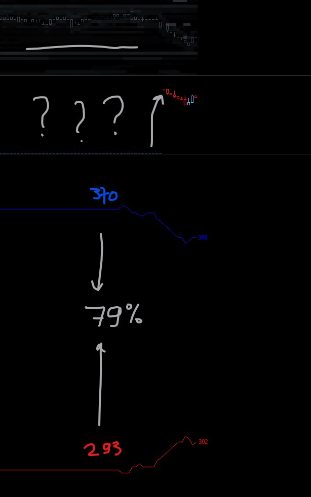

Please, please remove imbalance filtering! 30 minutes of no data. Market dropped 300 ticks causing major depth imbalance but it doesnt mean theres something wrong with it. It is how it is. We need to see the market!
Please remove this filtering asap! Thank you!!!

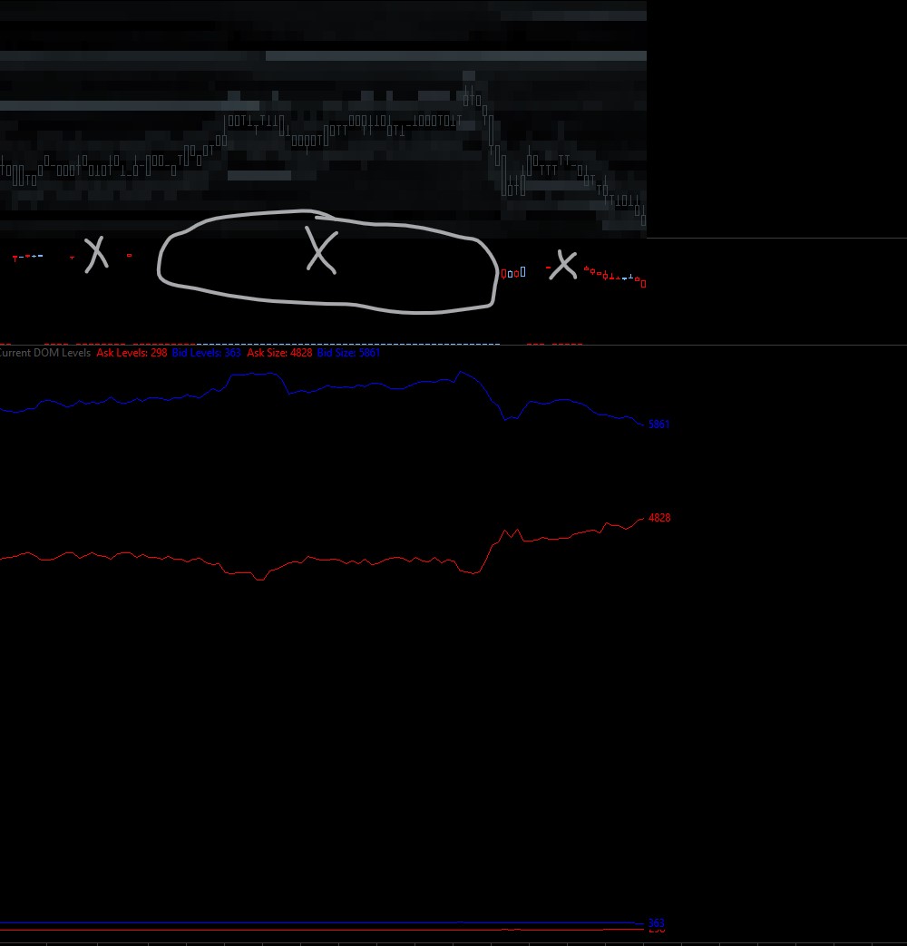

So it's over 1.5 hours of trading now with no depthbars data.
Please kill that filtering asap. Thank you!

We are doing our best, we just do not want to make a change that then starts causing problems for other users. We have to consider everyone. This is a rather involved process because we have to do a careful examination of market depth data processing.
However, we know that you are all wanting the change related to not filtering based on an imbalance. The imbalance check is there but it has been reduced to being a ratio of 50/100. This will be out in version 1968 in about 15 minutes.
