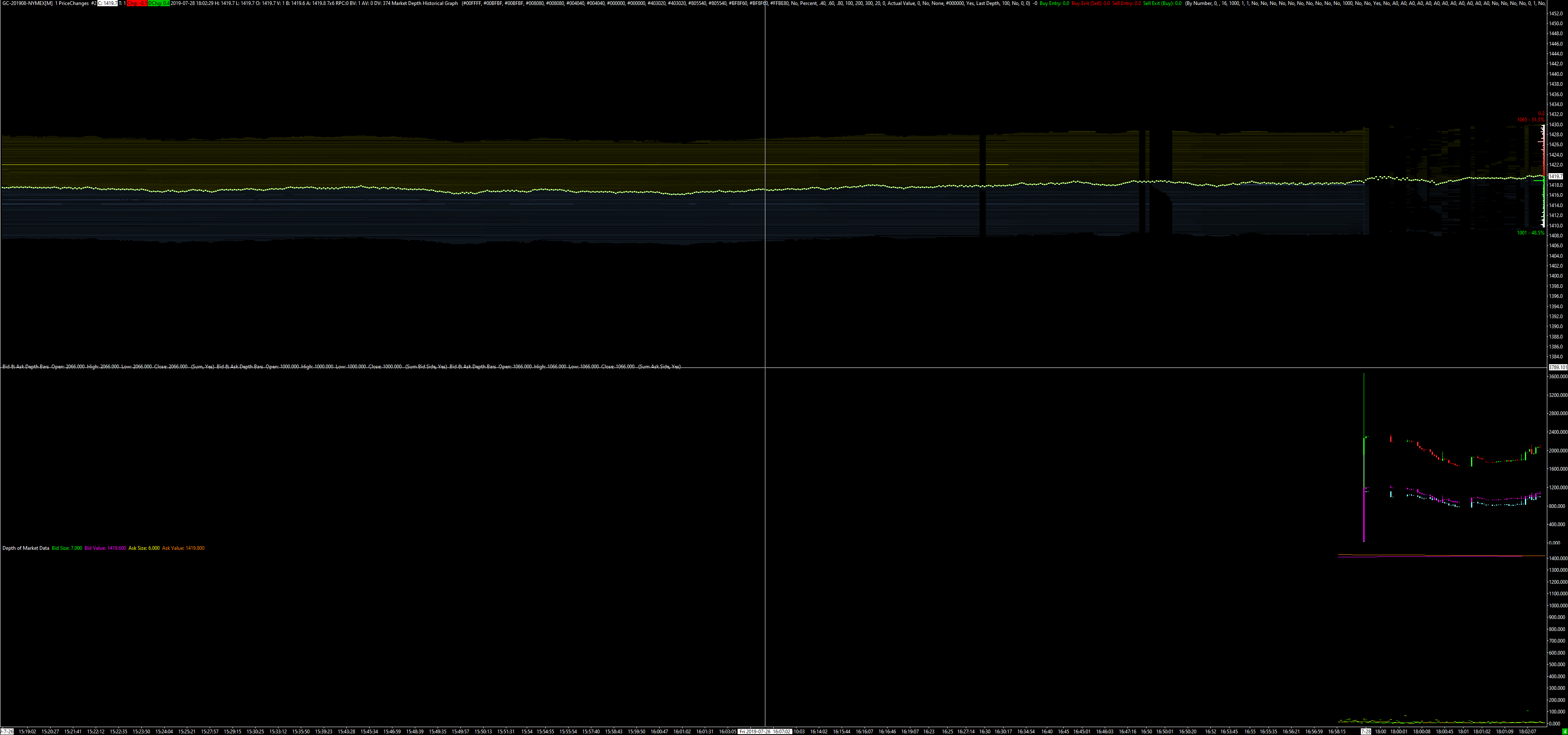

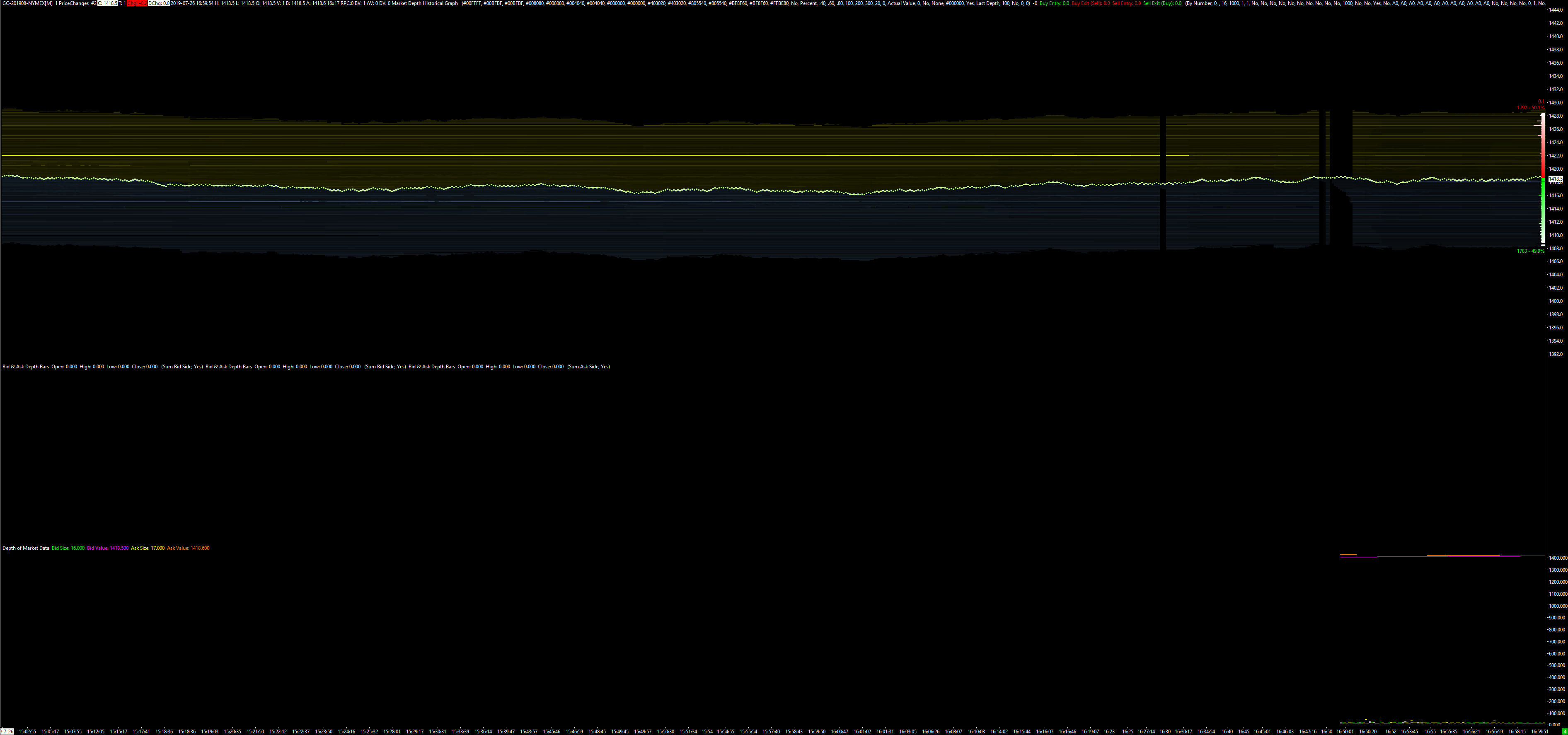

In the previous format multiple Bid Ask Depth bar studies could be used to display multiple depths simultaneously.
Here is what I get now
http://www.sierrachart.com/image.php?Image=1564350631652.png
Here is what I get version 1941
http://www.sierrachart.com/image.php?Image=1564350723839.png
I tried multiple non zero sub 100 values for market depth in chart settings 3.

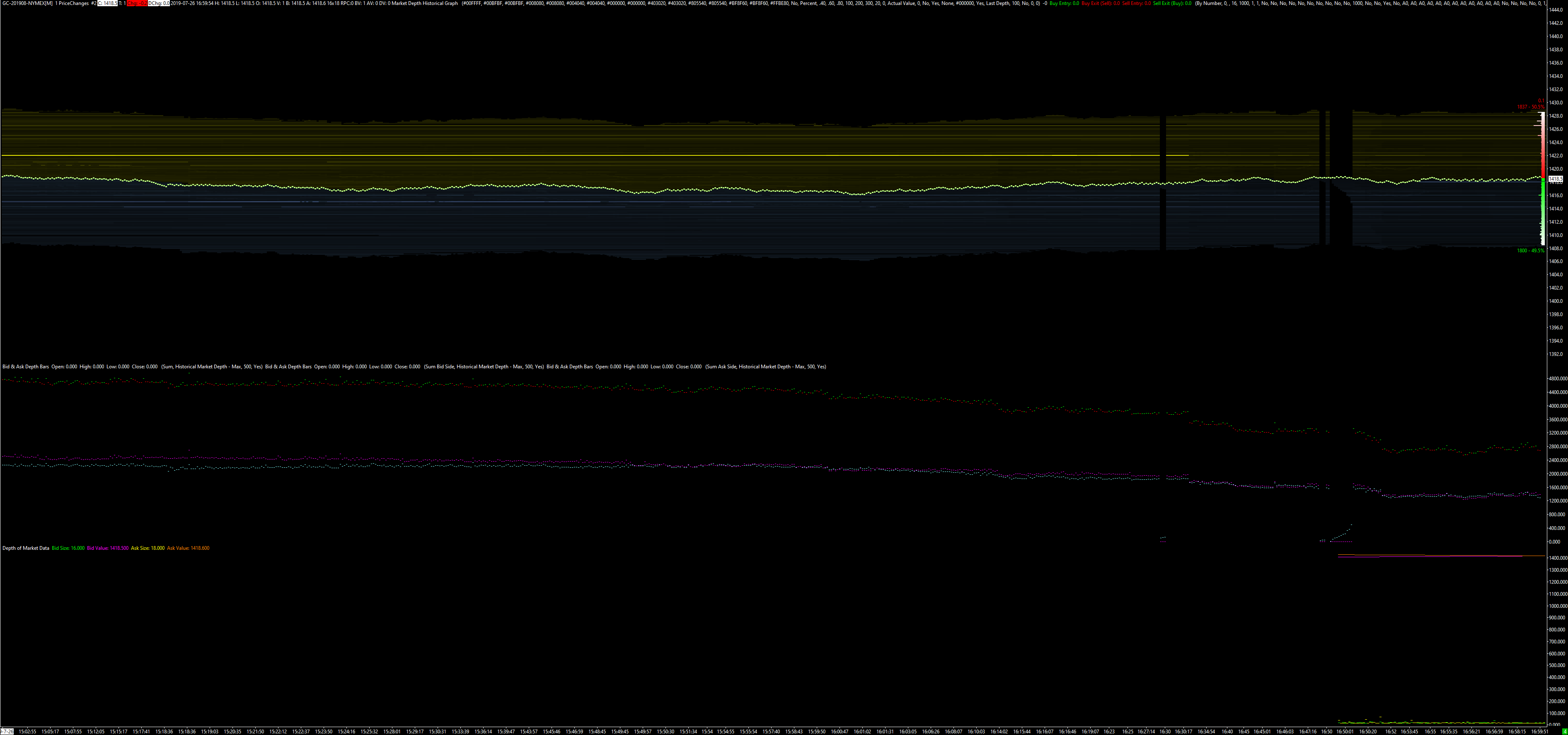

(UPDATE)
It is calculating and drawing once new data is ticking. It can even recalculate depth bars from newly recorded data. Just seems like the new Depth bar study can't calculate pre-1957 depth data records?

[2019-07-29 01:52:38]
Yes this is true and is going to be the case. In your case you will need to have recorded market depth data with version 1957 or higher which happens automatically when using Bid and Ask Depth Bars study. Market depth data from older versions which do not support the market depth improvements will not be used by the study.

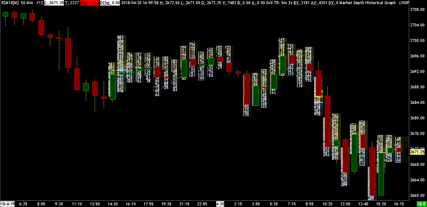

And as you can see in this chart image here of the Market Depth Historical Graph study (the numbers are overlapping though):
http://www.sierrachart.com/image.php?Image=1564394550986.png
in the newer versions of Sierra Chart, this version is 1959, older historical market depth data is still usable in all areas of the program which utilize it, just not with Bid and Ask Depth Bars. This chart shows data from back in 2018.
