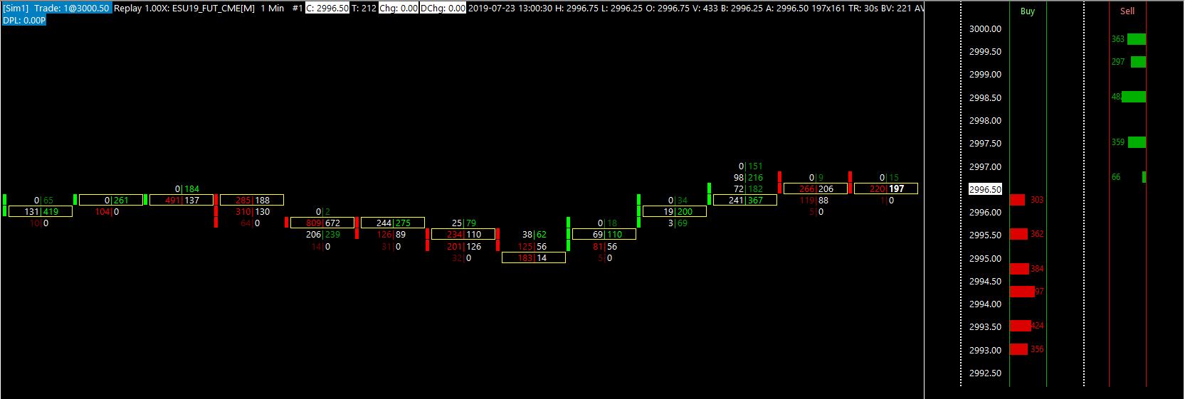

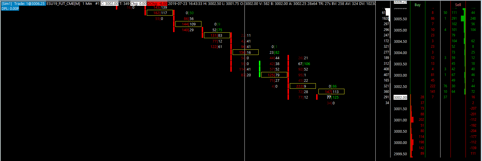

I have Sierra Chart configured to "Record Market Depth Data".
When I look at the live market, it appears correct, see good-dom.png attached.
When I replay the market, I do see some DOM data and the Market Depth Historical Graph does seem to update as if it has full DOM data, but the price ladder is missing DOM for various price levels. See bad-dom.png attached.
Does anyone know why replaying does not show all DOM activity for me?
imagegood-dom.png / V - Attached On 2019-07-23 20:46:13 UTC - Size: 50.62 KB - 395 views
imagebad-dom.png / V - Attached On 2019-07-23 20:46:18 UTC - Size: 40.13 KB - 425 views

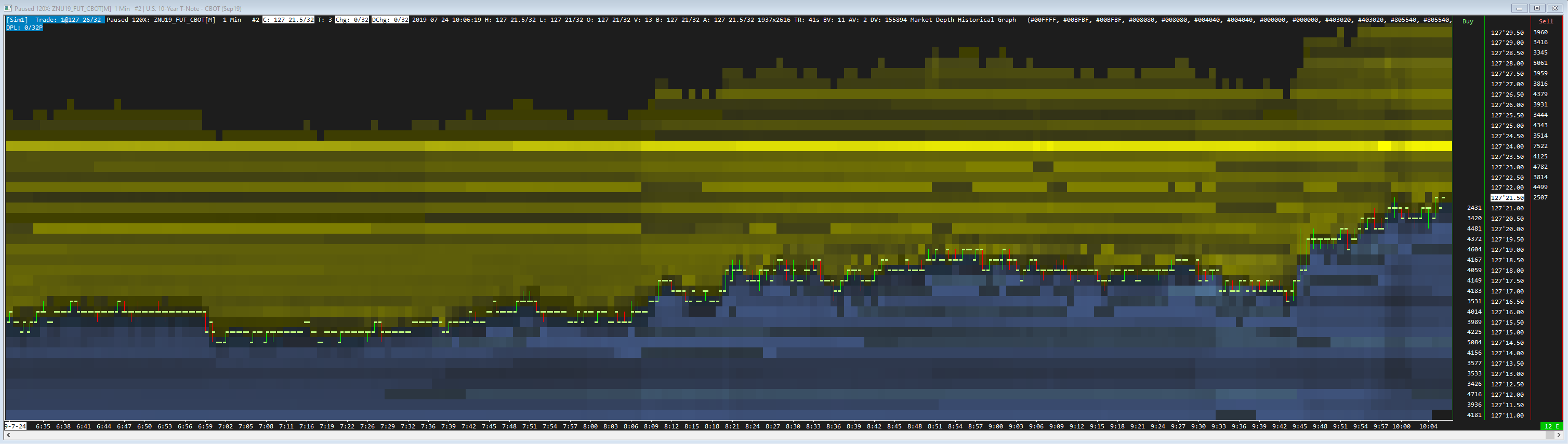

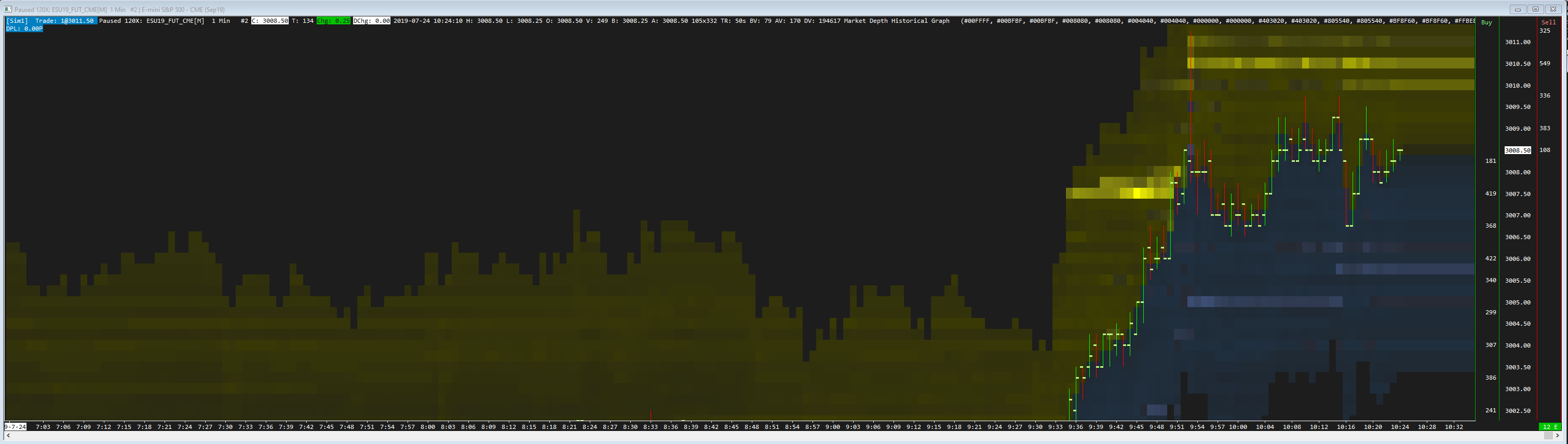

Attached are 3 more screenshots. I created a very basic new chart to test this. The changes I made were enabling Trading Chart DOM and adding the Market Depth Historical Graph study. I ran each replay from 9am today at 120x speed. As you can see from the screenshots, ZN shows the order book at all levels, but the ES is missing order book data at seemingly random levels. Both charts appear to have the Market Depth Historical Graph updating as the replay moves along.

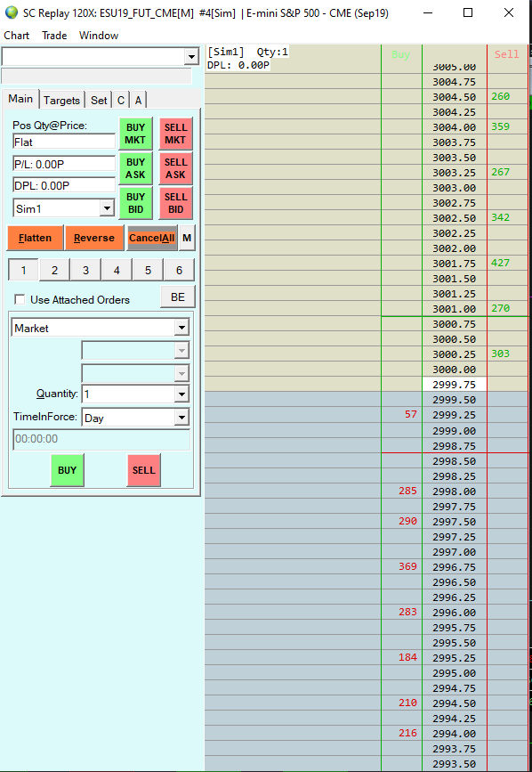

I see the same info (complete on ZN, missing on ES) on both the Chart DOM and Trading DOM. I've attached an ES Trading DOM screenshot as well.

imagees-dom-replay.png / V - Attached On 2019-07-25 01:03:57 UTC - Size: 68.79 KB - 458 views
imagezn-dom-replay.png / V - Attached On 2019-07-25 01:04:02 UTC - Size: 110.84 KB - 379 views
imagees-trading-dom-replay.png / V - Attached On 2019-07-25 01:11:09 UTC - Size: 54.97 KB - 416 views
