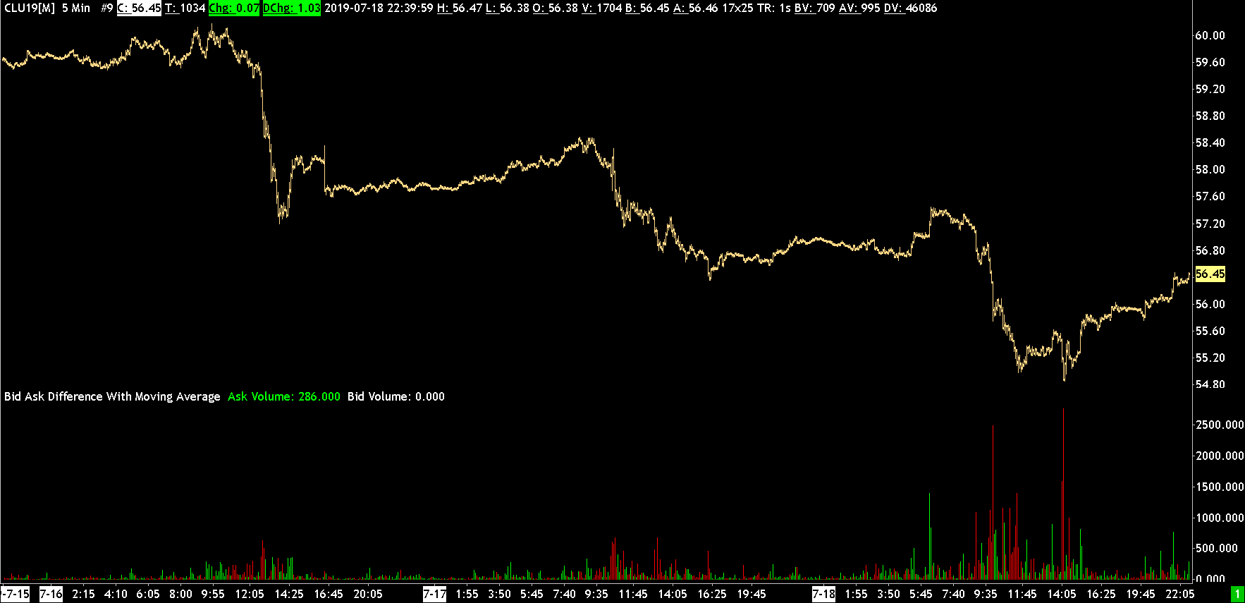

It works just fine for us using the Analysis >> Build Custom Studies DLL >> Build>> Remote Build.
This is the final result on the chart:
http://www.sierrachart.com/image.php?Image=1563504002989.png
