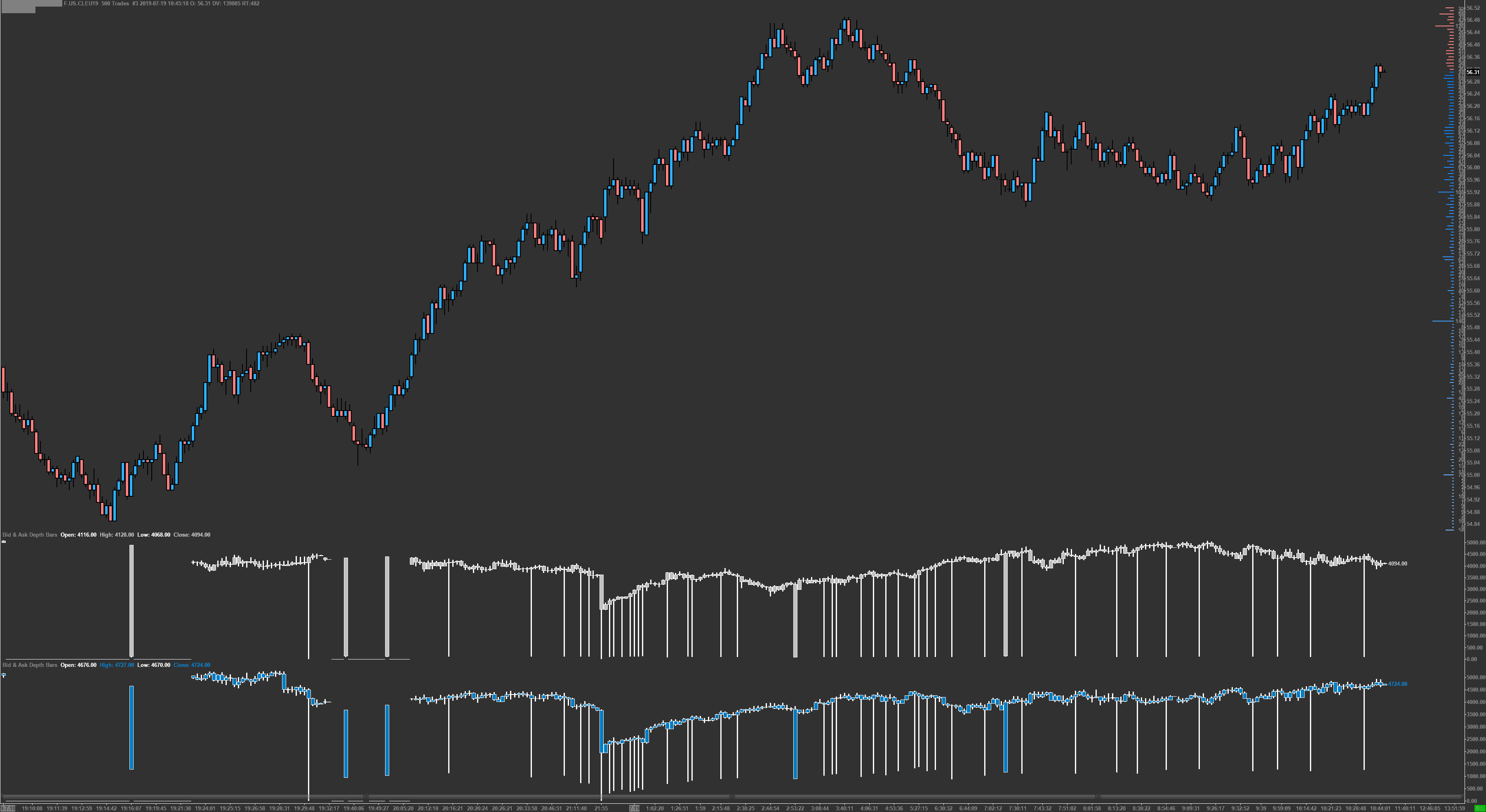

[2019-07-18 09:03:06]
samual sprat - Posts: 343
Sure see attached. This is from version 1952 this morning
Date Time Of Last Edit: 2019-07-18 09:05:45

[2019-07-18 18:32:29]
In regards to post #10, we need you to post an image following the instructions here:
Essential information is not visible on those charts. They are meaningless to us.
That sounds scary. What kind of filtering are you talking about?!? We need to see true spectrum of depth. Don't filter anything!
I kindly ask again what kind of data is Depthbars study based on since it doesnt use T&S? You owe your users that explanation otherwise noone will trust this study. Also this way we could be more helpful with testing it. Thank you.
The filtering we do is based on imbalance between the number of levels on the bid side and ask side. If the imbalance is exceeding more than an 80% difference between the number of levels on the bid side and ask side, then we skip doing any calculations on that current market depth state. Normally there will be a balance.
The calculations are based on the actual market depth data as it changes. The calculations are much more complete now than previously. The depth data we would record with time sales data was only snapshot. There is a considerable more degree of precision now than previously.
Date Time Of Last Edit: 2019-07-18 18:32:53
[2019-07-19 09:46:17]
Just taken this screenshot.... http://www.sierrachart.com/image.php?Image=1563529519842.png

[2019-07-22 16:34:57]
In regards to posts 15, 16, 17, 18, 19, 20, what is this all about? There are no limitations with market depth data. Do not just post without understanding what it is you are referring to and clearly make reference to what it is you are referring to. There are no limitations with market depth data. Full depth data is processed. Do not post here further, about this. There is not any issue here at all.
Why only a snapshot?? So isn't the s_TimeAndSales data structure with s_TimeAndSales::Type set to SC_TS_BIDASKVALUES supposed to contain EVERY bid/ask quotation from data feed and hence record every depth change??
What is the basis of this post since this issue has been resolved in newer versions of Sierra Chart where the calculations are based upon market depth data changes at all levels. The way this works in previous versions is also documented:
Bid & Ask Depth Bars
When the Input Source Data is set to Time & Sales then the Bid Market Depth and Ask Market Depth quantity totals are calculated when there is a change with Market Depth at the best Bid and Ask level only. This includes either the prices or quantities change. This creates a snapshot of total Bid Market Depth and total Ask Market Depth at that moment in time.
This is no longer a limitation in the current version of Sierra Chart. Also, the number of market depth levels processed related to that study within each individual chart is controlled with this setting:
Chart Settings: Maximum Market Depth Levels (Chart >> Chart Settings >> Market Depth menu)
For the latest updates, use prerelease 1954 or 1955 which we are coming out with in about an hour.
In regards to post #13:
we think this is a CQG specific issue. We made a change which we think will resolve this. Use version 1954.
Date Time Of Last Edit: 2019-07-22 16:38:27
