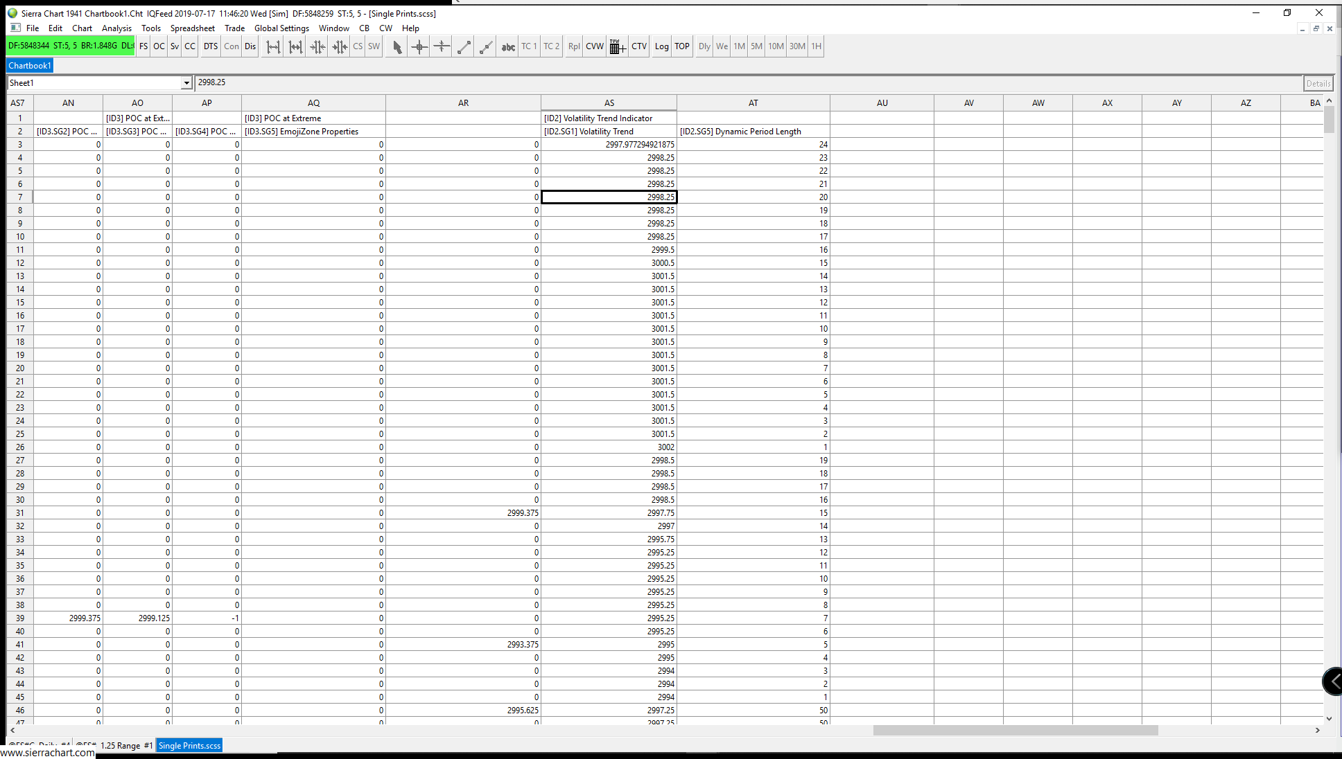

Ok, so that worked when using the alerting feature - thank you. I was able to access SG4 and got the Volatility Trend to alert using the Color Bar Alert. However, working with the Spreadsheet appears to be a little different.
You can see in my attached screenshot, columns AS and AT are the exposed subgraphs that are populated into the Spreadsheet when I load the Volatility Trend study onto the chart. So, in order to access the hidden values of SG4 I would need to make ID2.SG4 it's own column and the values it would be expected to produce would be either 1 //uptrend or -1 //downtrend. I've tried adding "[ID2.SG4] Direction" into the AU column - row 1 and/or row 2, but that does work. As soon as I do a right-click, Recalculate All Formulas, the [ID2.SG4], from column AU, disappears.....

[2019-07-17 19:22:51]
Sawtooth - Posts: 4361
The Volatility Trend Indicator study appears to be similar to the Parabolic study, in that if price crosses the previous value, it switches sides.
The formulas in post#4 could be used to find the transitions (direction change):
Color Background Based on Alert Condition and the Parabolic SAR (PSAR)
To convert them for a spreadsheet study:
VTI moves below price bar (transition to upslope):
=AND(ID2.SG1@4>=C4,D3>=ID2.SG1@3)
VTI moves above price bar (transition to downslope):
=AND(ID2.SG1@4<=D4,C3<=ID2.SG1@3)
If you want a +1/-1 persistent output in the same column, e.g. cell P3:
=IF(AND(ID2.SG1@4>=C4,D3>=ID2.SG1@3),1,IF(AND(ID2.SG1@4<=D4,C3<=ID2.SG1@3),-1,P4))

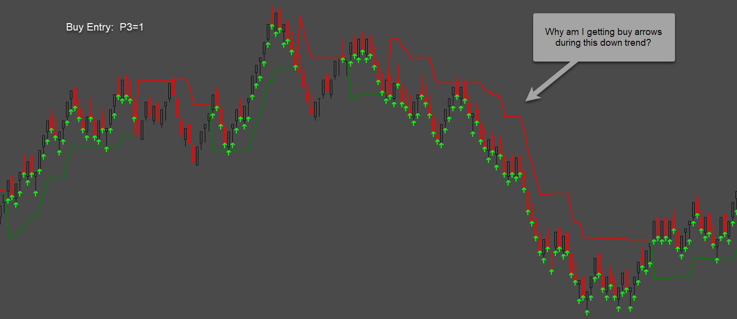

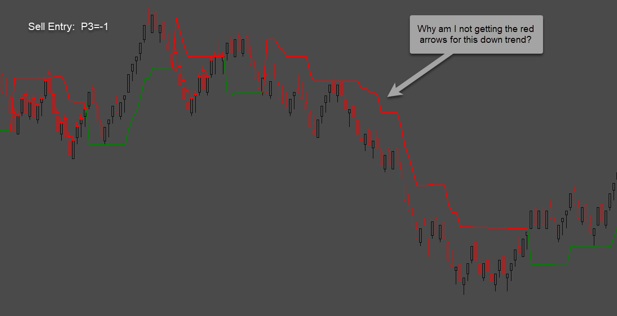

[2020-02-10 02:55:57]
tommartin321 - Posts: 81
Hi Tom,
Not sure why, but this formula is giving me mixed signals for the Volatility Trend study. For the Buy Entry I've entered P3=1 and for the Sell Entry I have P3=-1. However, the attached screenshots show I'm getting Buy signals during a down trend and I'm missing Sell signals during a down trend.
Thanks,
Tom
imageBuy Entry_ P3=1.png / V - Attached On 2020-02-10 02:49:48 UTC - Size: 29.93 KB - 975 views
imageSell Entry_P3=-1.png / V - Attached On 2020-02-10 02:49:54 UTC - Size: 24.79 KB - 592 views
[2020-02-17 00:46:34]
@tomgilb
I've made this modification and it works now.
=IF(AND(ID2.SG1@3<=C4,E3>=ID2.SG1@3),1,IF(AND(ID2.SG1@3>=D4,E3<=ID2.SG1@3),-1,P4))
