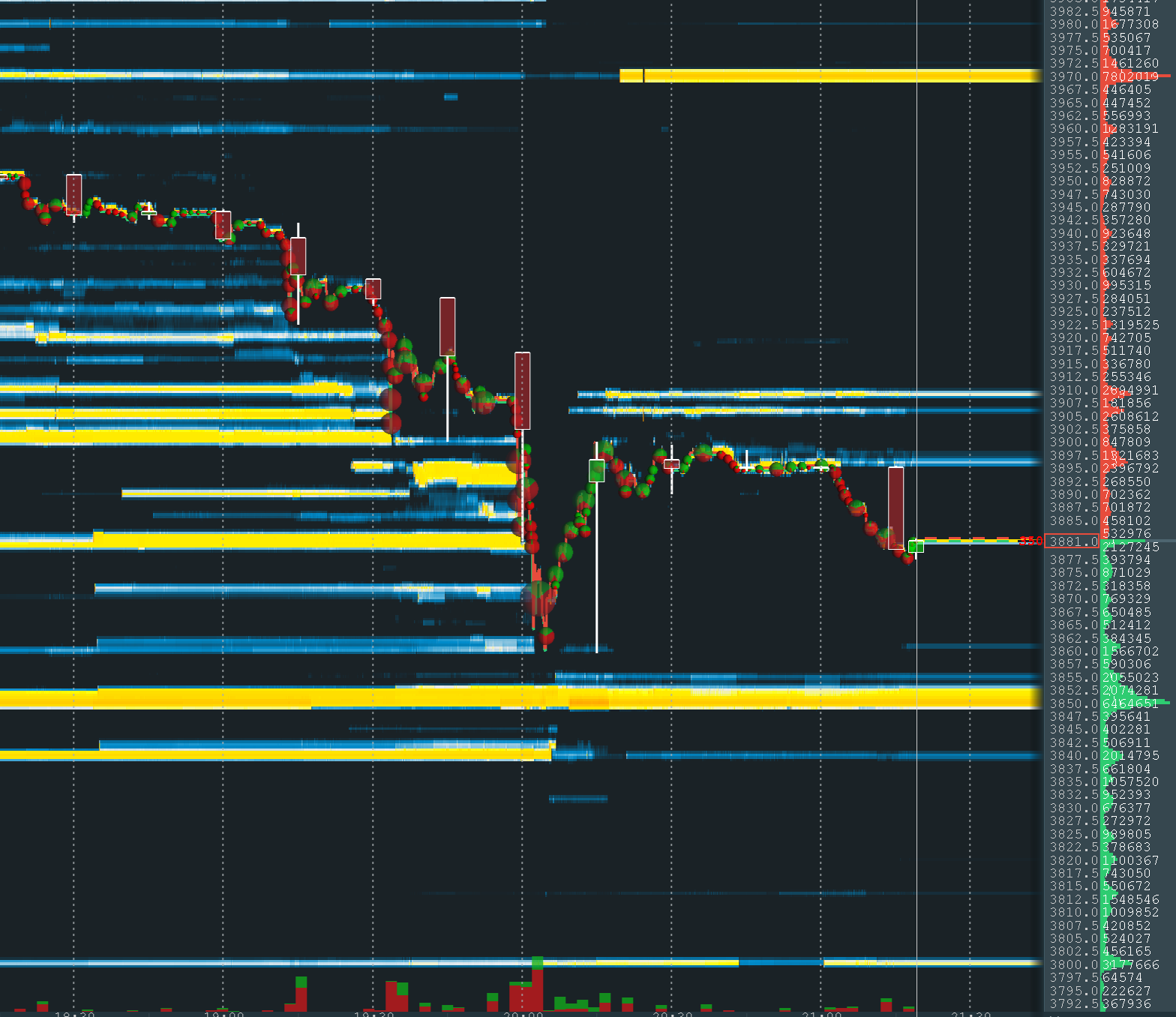

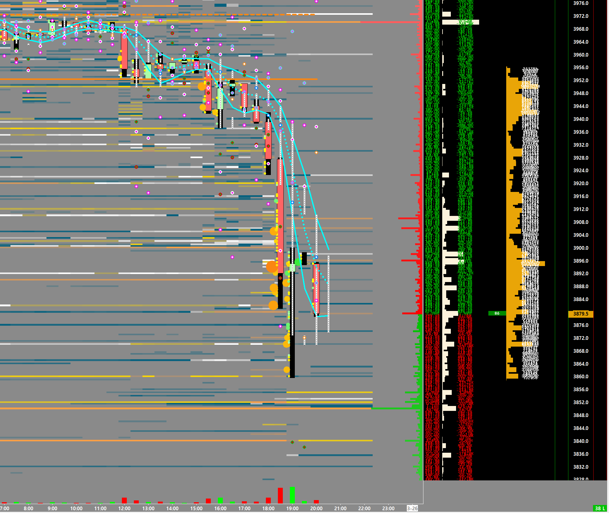

DAMN!!! i heared about bookmap not long ago and SURELY want to make use of this tool. 2 days ago i finally found out what Market Depth Historical Graph actually is...AWESOME!!!!!
Its not as specialist as bookmap but it has all the essentials and does the trick...just needs tweaking.
What i miss: Today we had a decent drop in bitcoin. So the price range on the chart gets bigger. While bookmap merges several price ticks together as you zoom out, sc doesnt. The endresult is in sc the ChartDOM is unreadable and the color shaded price levels get thinner and thinner, In this case, is it possible to set a bigger tick size on the DOM and several price levels get calculated as one?
i attached to files for comparison and better understanding

[2019-03-26 21:50:00]
You can use this setting to combine market depth levels:
Chart Settings: Market Depth Combine Increment in Ticks (Chart >> Chart Settings >> Market Depth menu)
But it does not affect the Market Depth Historical Graph study but we will work on that later.
You can also increase the actual Tick Size for the entire chart. Just be aware that this can have other implications, particularly to some Drawings and Studies that are dependent on the Tick Size. Refer to the documentation here:
Chart Settings: Tick Size (Chart >> Chart Settings >> Symbol >> Symbol Settings menu)
Date Time Of Last Edit: 2019-03-26 21:50:32
