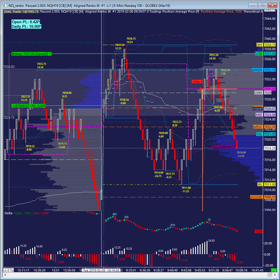

Hello, I tested it on replay and it seems to calculate wrong the flat to flat average:
On Replay I entered two contracts short at 7030 covered one contract 7020 at this point it was showing average at 7026.67 for the remaining one open contract (really strange reading) I was expecting to see that the breake even for the flat to flat position would move to 7040 after the first contract was closed with 10PT profit.
image2019-02-06 screenshot average flat to flat.jpg / V - Attached On 2019-02-07 10:21:06 UTC - Size: 258.1 KB - 789 views
[2019-02-07 16:04:46]
That is the correct calculation. It is the sum of the fill prices times the quantities divided by the total quantity.

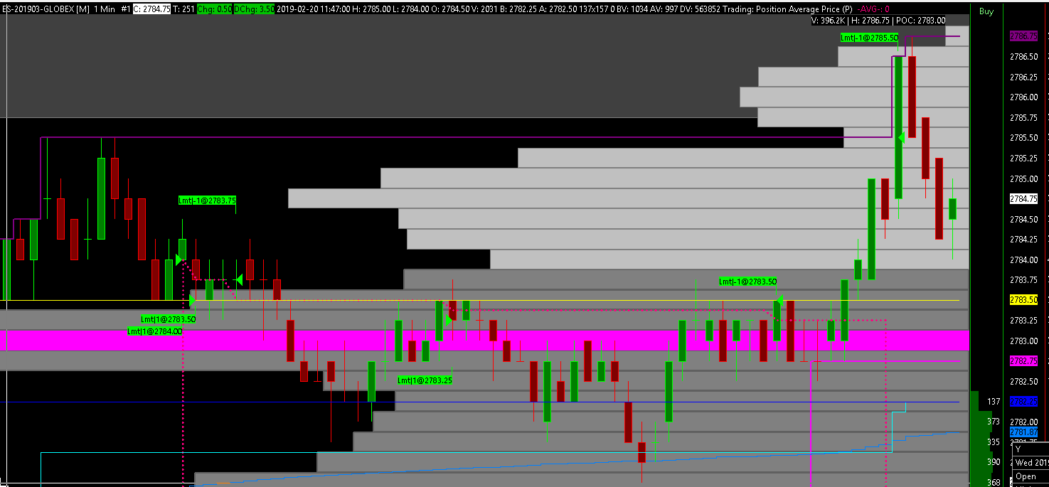

Thank you again. Glad to confirm that under v1875 new calculation works as expected. I was able to see correct value during multi-lot long trade in Trading DOM field. So far I didn't have a chance to place multi-lot short trade. So confirming only long multi-lot trade results at the moment.
Another observation is that study "Trading: Position Average Price" does not produce expected results. The line is close to what I would expect, but not exact.
Details of this "not-the-best" trade and values of the study:
Fill Lots Theoretical average Study value
+84.00 1 84.00 84.00
+83.50 2 83.75 83.75
-83.75 1 83.75 83.50
+83.25 2 83.50 ~83.37
-83.50 1 83.50 83.25
-85.50 0 0.00 0.00
I also attaching screenshot showing fills and "Position Average Price" study in dashed pink color.
Thank you and best regards.
Date Time Of Last Edit: 2019-02-20 17:31:41
imageAverage_position_price.png / V - Attached On 2019-02-20 17:25:06 UTC - Size: 49.14 KB - 600 views
[2019-02-21 00:43:38]
"Trading: Position Average Price" is based on the standard calculation in the Trades list will always be using first in first out.
Date Time Of Last Edit: 2019-02-21 00:44:19
