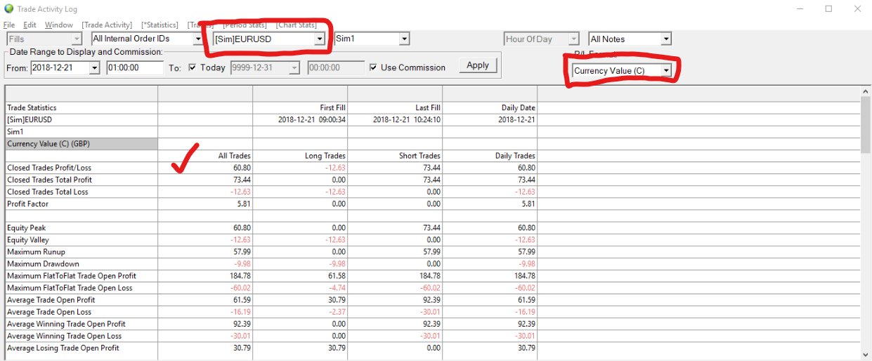

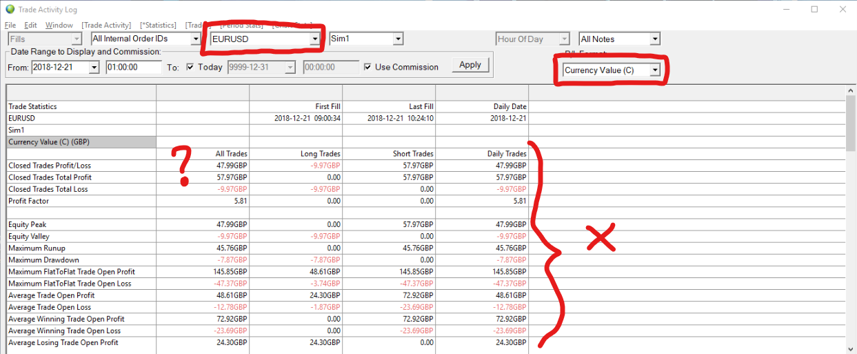

Version 1852 appears to have bugs with currency conversions as displayed on the TAL.
When Common Profit Loss currency set to any value other than NONE the calculated totals in the trade activity log are incorrect when choosing a non [SIM] symbol.
This is seen on SIM and LIVE trade data.
Screen shots attached.
Steps to reproduce:
Close sim trade in EURUSD
Set Common Profit Loss to GBP
Set P/L Format to Currency Value
In Trade Activity Log
Choose Trades tab:

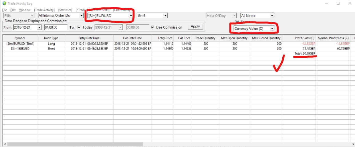

Symbol "[SIM]EURUSD" shows correct total (eg: 60.08GBP)

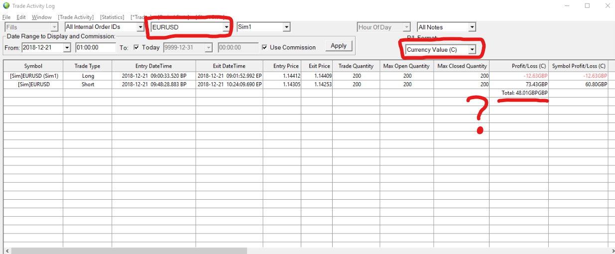

Symbol "EURUSD" shows incorrect total and with double currency suffix(eg: 48.02GBPGBP)
Choose Statistics tab:
Symbol "[SIM]EURUSD" shows correct values with no GBP suffix
Symbol "EURUSD" shows all values as incorrect and with a GBP suffix
Choose Period Stats tab:
Same issues as above.
Note that tick values do not change between symbols "[SIM]EURUSD" and "EURUSD" and appear correct.
My guess is there is a double currency conversion taking place somewhere in the code.
Can you please investigate and confirm.

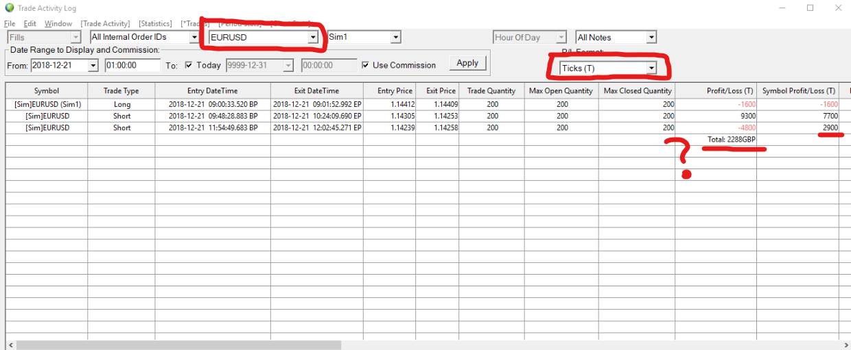

I think I have found further issues with this.
On the Trades tab for both "[SIM]EURUSD" and "EURUSD" when setting the P/L Format to Ticks or Points the totals are not correct and have a currency suffix. Screen shot attached.
This all seems a bit of a mess right now.
Can you please confirm.
Just to be clear I would expect to see total ticks if P/L Format is set to ticks and total points if set to points. I would only want to see total currency if P/L Format is set to currency.

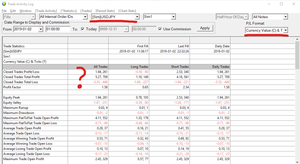

Hi support

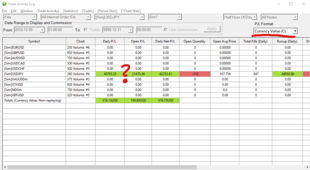

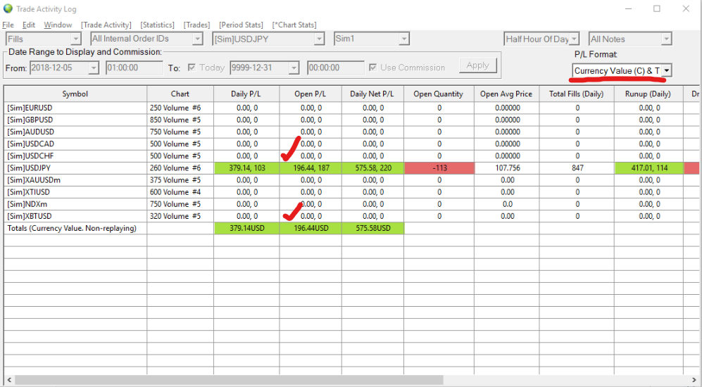

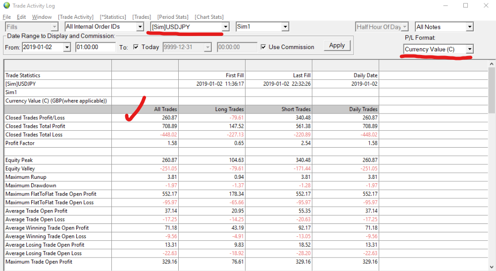

I'm still finding problems with incorrect values in the TAL when Common Profit/Loss Currency is set to any value other than NONE and the symbol quote currency is not USD eg USDJPY or USDCAD
Statistics tab:
Set symbol to [sim]USDJPY
Set P/L Format to Currency Value and all values appear correct
Set P/L Format to any of the Currency Value & Point/Ticks options and all values are incorrect
Trades tab:
Same as above
Also Symbol Profit/Loss column final value is always zero which is wrong
Period Stats tab:
Same as above
Can you please investigate thoroughly as it is dissapointing to still be having issues like this.

I have attached screenshots showing the garbage data that is being output when common profit loss currency is set to GBP and the symbol is USDJPY.
Thoughts?
image01.png / V - Attached On 2019-01-02 23:15:59 UTC - Size: 134.82 KB - 464 views
image02.png / V - Attached On 2019-01-02 23:16:03 UTC - Size: 114 KB - 415 views
image03.png / V - Attached On 2019-01-02 23:16:07 UTC - Size: 139.27 KB - 491 views

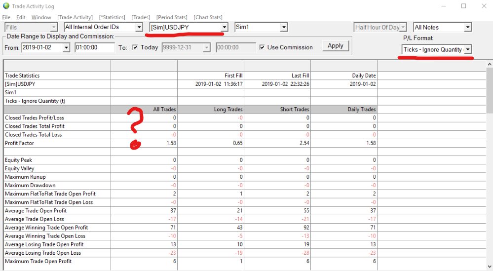

I'm not sure you do understand it. If you look at image "02.png" it shows the values in ticks only. These values are all wrong and is a result of the Common Profit Loss Currency being set to a value not equal to NONE and the symbol being quoted in JPY. This has nothing to do with the "Currency and Ticks" display options.
Note that when the symbol is quoted in USD the TAL shows the correct values in all cases even when using the "Currency and Ticks" display options! So it does work just not always - which suggests both a coding problem and a testing problem.
Note that I am also seeing inconsistent results between USDCAD and USDJPY
Below is a grid showing the very varied results I am seeing. Can you please review and confirm?

Common Profit Loss Currency = GBP
Symbol = USDJPY
TAL P/L Format = Ticks, Points, or Currency & Ticks/Points
RESULT = ALL VALUES INCORRECT

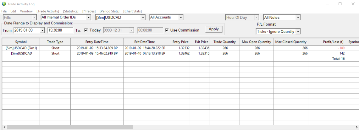

Symbol = USDCAD
TAL P/L Format = Ticks or Points
RESULT = ALL VALUES CORRECT

More problems with USDJPY this time on the Chart Stats Tab. I have attached screenshots.
Note that Common Profit Loss Currency is set to USD
When the P/L Format is set to "Currency Value" the values I think are being shown in JPY which is wrong. The total of the Open P/L column is shown in USD and is correct and matches that shown in the trade window.
When the P/L Format is set to "Currency Value and Ticks" the values are shown in USD which is correct and the tick values are correct too. Again the total of the Open P/L column is shown in USD and is correct and matches that shown in the trade window.
So this is almost the inverse of the problems found in the other tabs.

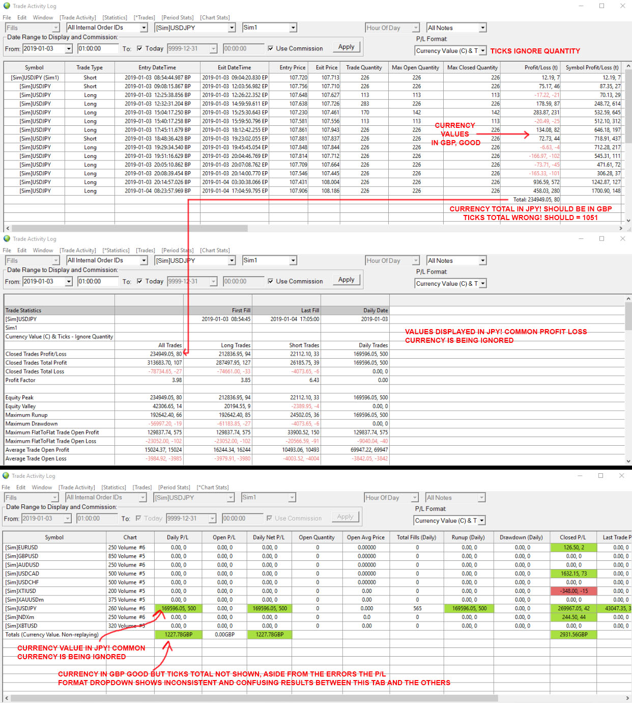

[2019-01-05 14:19:21]
User343901 - Posts: 66
I have re-reviewed these issues on 1856 and there are still obvious problems.
In brief:
1. "ticks or points ignore quantity" are being totalled incorrectly which I assume is throwing out all the values in the Statistics tab
2. on Trades tab "currency value & ticks or points" do now show correctly as common currency alonside Tick values which is great and directly contradicts your statement above. So you've proven it is possible to have converted currency alongside ticks/points. Bizarrely though the total is now shown in the symbol quote currency.
See the attached image where I have put together the different tabs in one image for clarity.
Aside from fixing the errors all I want as a user is a simple and consistent view of the data. Setting an option such as P/L Format should show the data absolutely consistently in all areas of the program without exception. There is no reason for this not to be the case. Sierra is a great package overall but the TAL falls well below the standard I would expect from professional software.
imageTAL v1856.jpg / V - Attached On 2019-01-05 14:19:12 UTC - Size: 528.76 KB - 485 views

Also the "ticks/points ignore quantity" totals on the trades tab are still being summed incorrectly. Can you please confirm? Will this be fixed? I have attached a screenshot.
