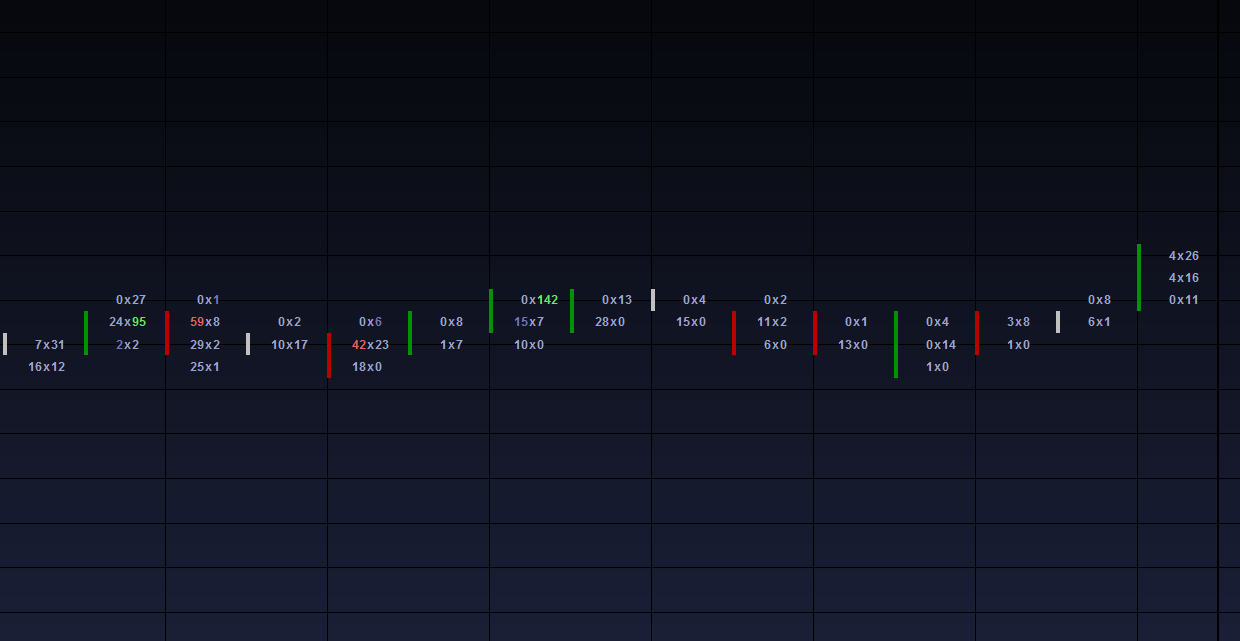

I currently use Market Delta for charting but really like Sierra, but the main thing I think is missing (unless I'm mistaken) is the equivalent to volume imbalance charts.
These are like the traditional bid versus ask numbers bars but are colour coded according to the imbalance between the diagonal bid/ask (i.e. how a numbers bar should be read) and if > x% (default being 140%) the number is shaded green or red to reflect strong imbalanced between lots transacted at the equivalent bid/ask.
I've shared an example chart below.
Is this possible to achieve in Sierra? If not is there plans too include?

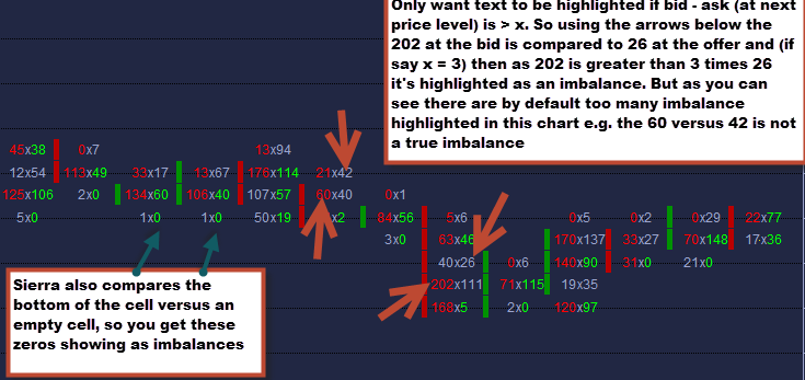

[2013-11-05 14:13:01]
User85153 - Posts: 7
@User62375 - well explained and totally correct, footprint charts are 'read' diagonally (in line with the real market) and not horizontally.
From what I can tell the 'Text On Dominant Side Auction' does this but there is no filter like there is in MD e.g. the 300% example you used above (unless I can't find it).
Also Sierra compares the top and bottom number to an empty cell resulting in a 1x50 at the top of for example an M1 TF bar showing an imbalance on the bid because 1 is greater than a zero it assumes is in the cell above (when in fact it's empty) - clearly that's incorrect usage of imbalance.
Date Time Of Last Edit: 2013-11-05 14:13:41
imageimbalance1.png / V - Attached On 2013-11-05 14:13:30 UTC - Size: 43.06 KB - 1879 views

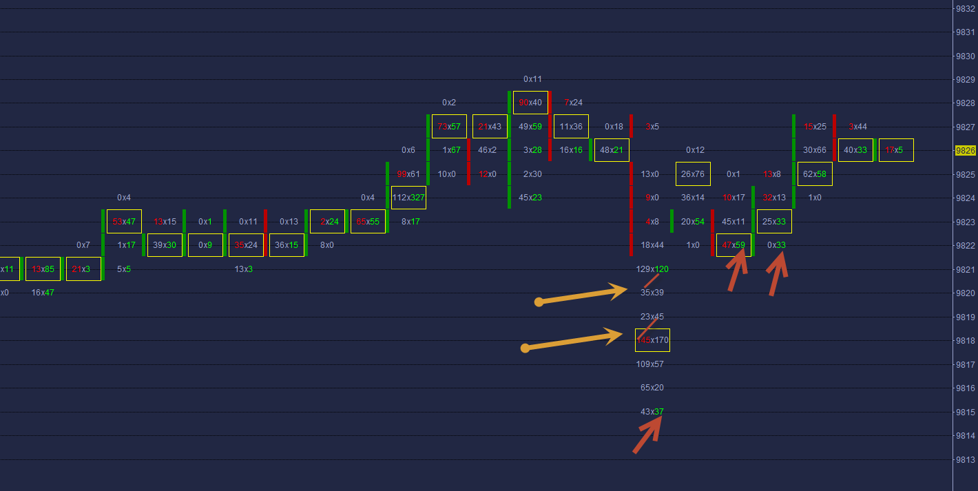

The update is good, it does the job outlined i.e. allows a diagonal comparison in accordance with % imbalances.
So for example the highlighted numbers in the attached are 300% imbalances as per the two yellow arrows.
However there is still the niggling issue of comparing top/bottom of bar against empty cells to create imbalances (which aren't real imbalances) as per the brown arrows.
imagenumbers bar1.png / V - Attached On 2013-11-27 13:48:55 UTC - Size: 49.72 KB - 4337 views

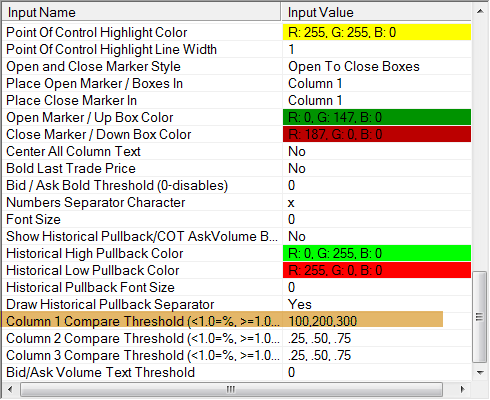

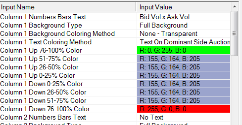

[2013-11-27 17:04:00]
Here are screenshots of the relevant settings
Date Time Of Last Edit: 2013-11-27 17:04:27
imagesettings1.png / V - Attached On 2013-11-27 17:04:15 UTC - Size: 24.73 KB - 2820 views
imagesettings 2.png / V - Attached On 2013-11-27 17:04:20 UTC - Size: 32.92 KB - 2383 views
