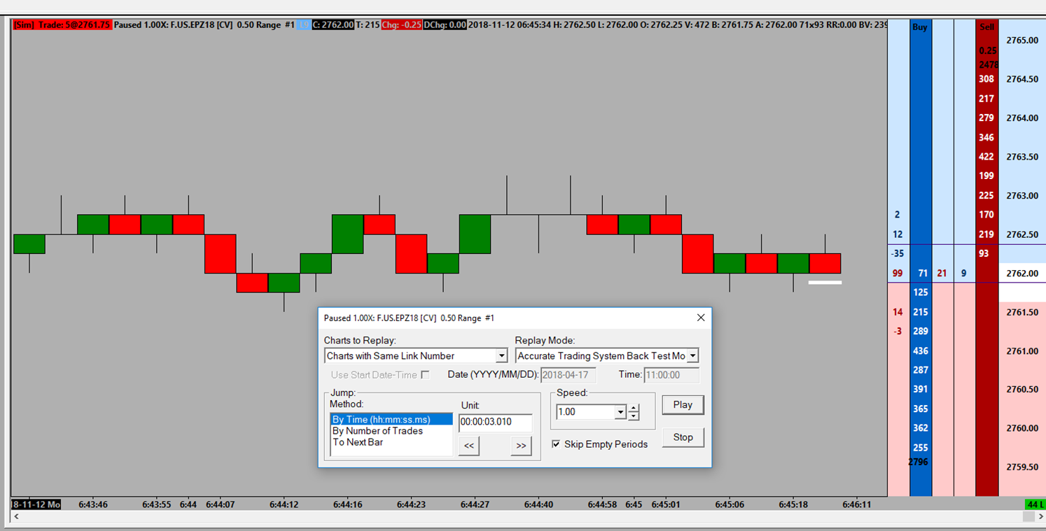

When I replay a chart, whether it's standard or accurate mode, the chart DOM bid and ask prices will lead the chart and they will not always be in sync. I'll typically see the DOM jump up with the bid/ask line on the chart staying where it is and then following it moments later. Is there a way to have them both be in sync? Thanks.

User104854 - Posts: 460
Here is an image with an example. At the time I paused this replay, the Chart DOM bid is at 2762.00 and the bid on the actual chart based on the bid/ask line is 2761.75.

You must use the Sierra Chart Exchange Data Feed to solve this:
Refer to:
Market Depth Historical Graph: Market Depth Data Time Stamping During Real Time Updates and Replays
We can assure you we are not going to respond further to this. This matter is final.

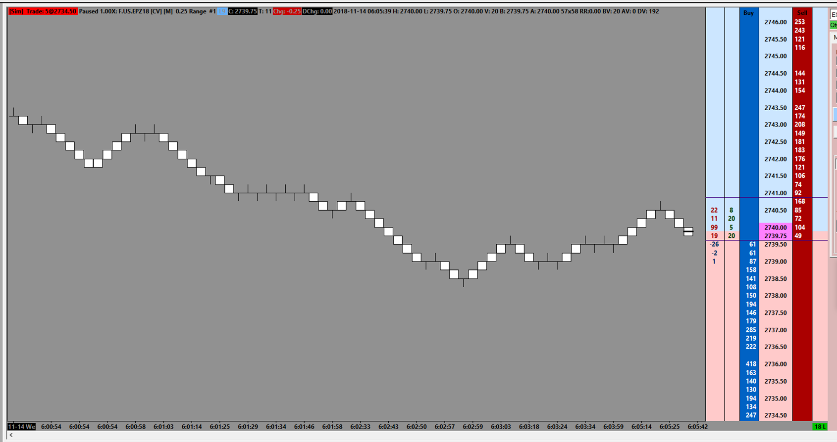

I recorded the data this morning and ran a replay and there is still a lag. I've provided 2 screenshots. I've highlighted the best bid/ask box in pink. You'll see in the first example that the bid/ask is off by a tick and in the second example it's off by 2 ticks. I ran the replay with a generic chart with no studies on accurate mode.
I assume that the data is correct as there are 30 prices of depth on each side which I did not have with CQG. I also deleted and reloaded the data on the chart. Thanks.

The individual best bid and ask prices are not going to always be in alignment with the market depth quantities because the best bid and ask only update at each trade. In order to ensure that those are completely in sync with the last trade price, this cannot change.
The main thing we look for is the market depth data being out of alignment with the last trade price. Anytime someone brings up an issue with that, then this will be a data feed specific issue.
However, we are seeing it in this case as well as we have done some testing. It is because there is not a millisecond level comparison with timestamps. We are going to fix that in the next release. But we realize, maintaining perfect synchronization is not so simple because the market depth data is only time stamped to the second and is that way for transmission efficiency reasons. So there will be some improvement but we cannot guarantee complete perfection.
