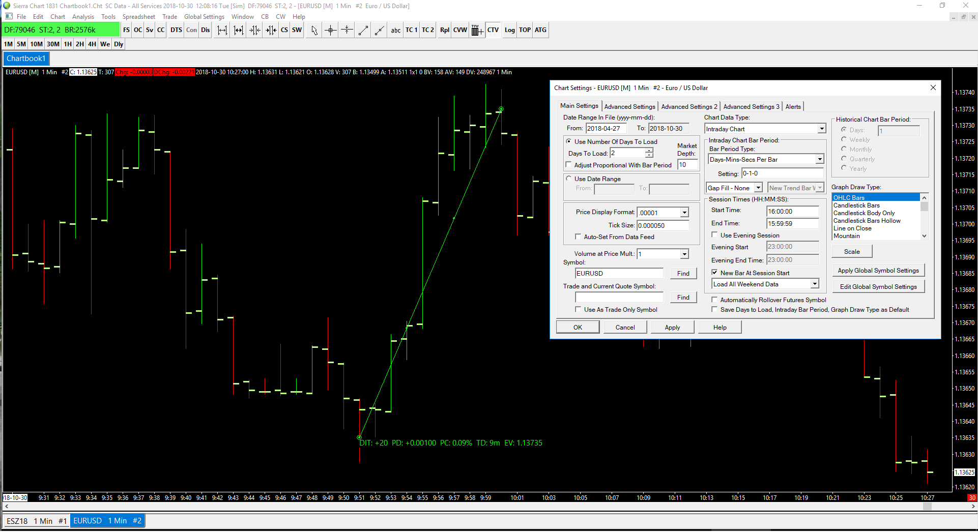

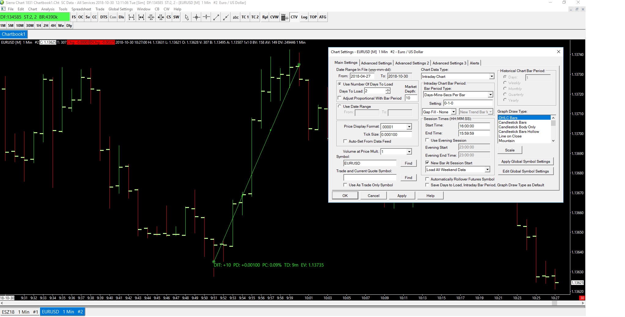

Attached are two images showing the Chart Calculator Tool displaying the Difference in Ticks (DIT) from before we make a change to the Tick Size from 0.00005 to 0.0001. You should have this same result.

Lovely, thanks John that now works. However, one other problem from doing this has come up. Now my P/L has changed (1/2). Is this just because I am doing it on a demo account? You may want to try it for yourself to see my issue.
