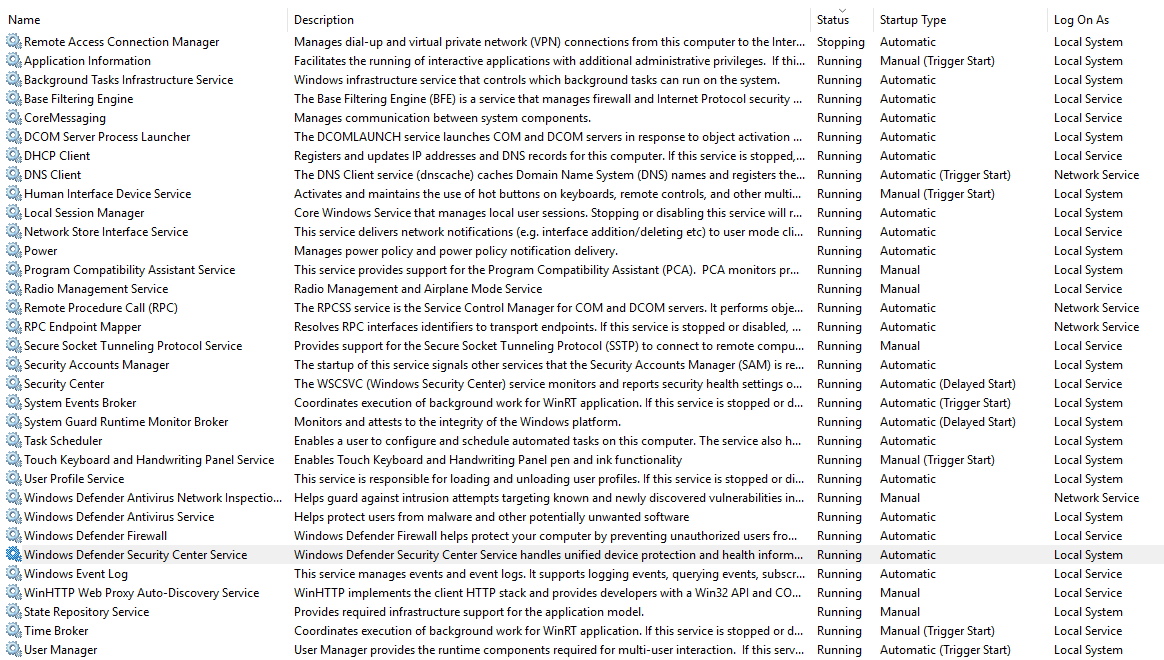

I closed all other programs, turned off Windows Defender and I continue to have a steady increasing memory usage when sc.FreeDLL is set to 1.
So as you suggested, I started disabling all non-Microsoft services and then the Microsoft services which the system would allow me to disable. All the while, shutting down, reopening and testing SC.
I disabled all services except 33 which could not be disabled (see attached screenshot). Unfortunately, the increasing memory issue never went away.
I'm at a loss of what else I can do to track down the issue. If you have any other ideas please let me know, otherwise I think we will have to leave it as an unsolved issue.
