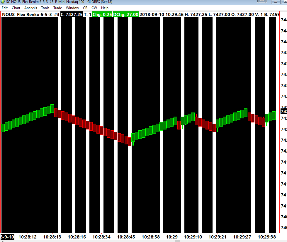

Ive attached a screen shot of how the stop lines appear on the chart.
I using a demo of ninja 7 and trying to get the atr stop completed before the demo expires.

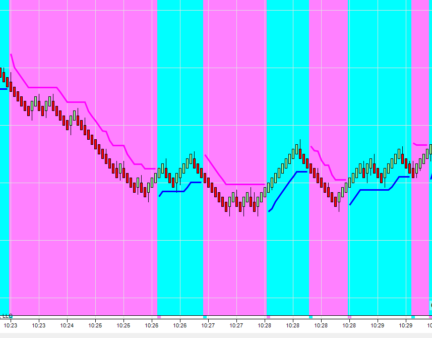

User701453 - Posts: 176
I`m still fighting this ninja code block..
Instead of trying to plot the lines.
I decided first to create a SC study that colors the background correctly first.
As the ninja ATR stop code long and short swings match up with the background color changes.
The background color and stop lines are contained within the same ninja code block.
Screenshots of ninja screen and my attempt to clone it to SC chart attached.
Pulling my hair out trying to figure out what I`m doing wrong.
imageninja chart.PNG / V - Attached On 2018-09-11 00:00:04 UTC - Size: 51.76 KB - 575 views
imagescChart.PNG / V - Attached On 2018-09-11 00:00:13 UTC - Size: 60.19 KB - 727 views

[2018-09-11 01:09:32]
Xfanman1 - Posts: 320
Looking at your recent images, I just wanted to make sure you realize the Renko bar type you're using with your new SC chart is not the same as your NT Renko chart. You probably changed it intentionally but if not and you need direction on the equivalent SC Renko let me know.
Also, I sent you the .cpp file via direct message.

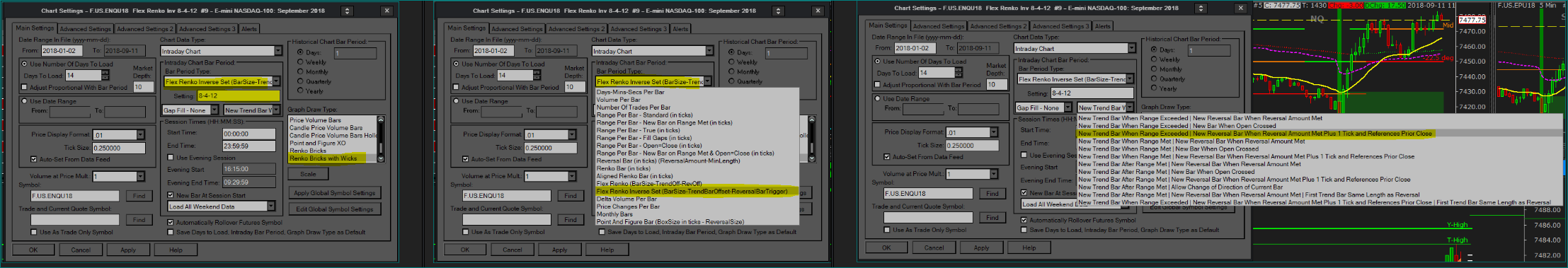

[2018-09-11 02:36:56]
It looks to me like your NT Renko bars are Mean Renko or Better Renko bars with an offset of 1/2 the bar length. Look at this link and select the third setting in the Renko bar type drop down window. (I’m on my phone again so can’t confirm with screenshots at the moment)
Renko Bar Charts: New Reversal Bar When Reversal Amount Met Plus 1 Tick and References Prior Close
You want a bar configuration of something like 6-3-9 or 8-4-12. This would mean you’ll have a 6 tick bar with a 3 tick offset and a 12 Tick reversal (you add the 2nd and 3rd numbers for the Reversal).
Make sure you select Renko Bars with wicks and I think that’s it. Play with those settings and
See If they get you closer than you were. I’ll send you the right settings via screenshots tomorrow afternoon if you can’t get the exact Renko look comparing it to NT.
Scott

[2018-09-11 15:51:52]
Here is what my Renko 8-4-12 settings look like on the chart. If you want a faster 6 tick bar than you'd use 6-3-9, a slower 12 tick bar, 12-6-18 and so on. Again this is an 8 tick bar with a 4 tick offset and a 16 tick reversal (the 12 + 4 = 16).
The other screen shots show the Chart Setting bar period and style settings to achieve what I've found to be closest to the NT Better Renko or Mean Renko settings. Enter your bar settings and play with it but this should be MUCH closer to your first chart than the SC chart you posted.
If you have any questions feel free to shoot me a DM also.
Scott

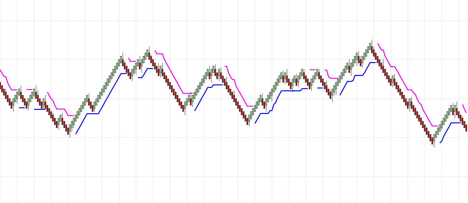

[2018-09-12 01:38:17]
JoseyWales - Posts: 67
You may never end up finding a perfect 1 to 1 match between SierraChart and NinjaTrader chart bars. A few reasons I can think of is different platforms may not use the same tick sizes. For example NT uses .00001 for non JPY Forex data, whereas SC uses .00005. Another reason is both SC and NT have their own interpretations of how to calculate Renko bars. If either NT or SC Renko bar logic differs from one another, then one may create a bar where the other does not. The last reason I can think of is NT uses "Break at end of day" and SC "New Bar on Season Start" settings and session times could be different. And the data providers may be different, therefore different raw tick data.
The biggest thing to learn/remember when programming SC ACSIL studies is variables and arrays that aren't a reference are destroyed at the end of the scope. And when AutoLoop = 1 this means it occurs at every update. Data assigned in a SCFloatArray will not be retained, whereas data in a SCFloatArrayRef will be. So the variables carryForward, result, and swing were being reset to 0 every iteration when they should have retained their value from the previous update. SC ACSIL is function like programming compared to NinjaScript's class based programming where a simple field stays in the scope of the class until the class is deleted, not on every update.
SierraChart has Persistent variables that solve this dilemma. If you don't need an entire SCFloatArrayRef and just need a variable to be carried over to the next update, use Persistent variables. It takes an int parameter as a key, so be sure to use different key values for persistent variables of the same type. And don't forget to make the type as a reference (double& name = sc.GetPersistentDouble(0), int& name = sc.GetPersistentInt(0)) so it is assignable. If you forget the reference operator, the code will compile fine but it will be confusing trying to debug until you realize you forgot to make it a reference type.
ACSIL Interface Members - Functions: sc.GetPersistentInt()
This is the code as seen in my attached pictures. Changing the input named Factor changes the output much more than Trend Length. It has another input named "Color Background or Color Bars?" if the user wants to paint the background or bars. If you want to have the stop level as a single subgraph, you can create a new subgraph and assign to it the variable "result" in the bottom if/else blocks like Bullish/Bearish Lines do. The subgraph named Trend assigns -1 for bearish and 1 for bullish conditions. Because it is a subgraph, it can be referenced in an alert condition (ID1.SG3[0] > 0).
Study/Chart Alerts And Scanning
Apparently you can't have a subgraph painting the background and another subgraph painting the bar colors within the same indicator. That's why the user has to choose either or neither, but not both. It might be a SierraChart bug.
Let me know what you think and if there's any improvements I can make for you.

imageSierraChart Color Background - Color Bar.png / V - Attached On 2018-09-12 01:22:06 UTC - Size: 404.92 KB - 727 views
imageSierraChart vs NinjaTrader 8 - Renko Comparison.png / V - Attached On 2018-09-12 01:23:21 UTC - Size: 550.33 KB - 751 views
