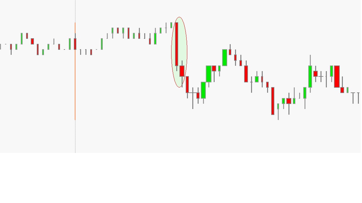

[2018-09-09 14:20:51]
User164231 - Posts: 281
Hi Tom,
I attach the image.
Thanks again.
imageAlert to trigger after last 2 bars 3 x greater than ATR.jpg / V - Attached On 2018-09-09 14:20:02 UTC - Size: 44.76 KB - 617 views

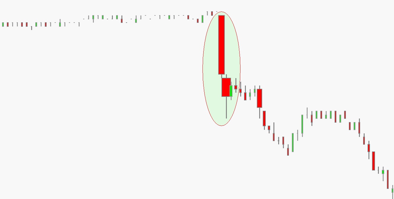

[2018-09-09 16:14:21]
Hi Tom,
It worked, but in random. This is intriguing! I was using color background with a bar whenever it is true. check out the orange bar.
See attached please.
Date Time Of Last Edit: 2018-09-09 16:15:31
imageRandom.jpg / V - Attached On 2018-09-09 16:13:44 UTC - Size: 42.39 KB - 657 views

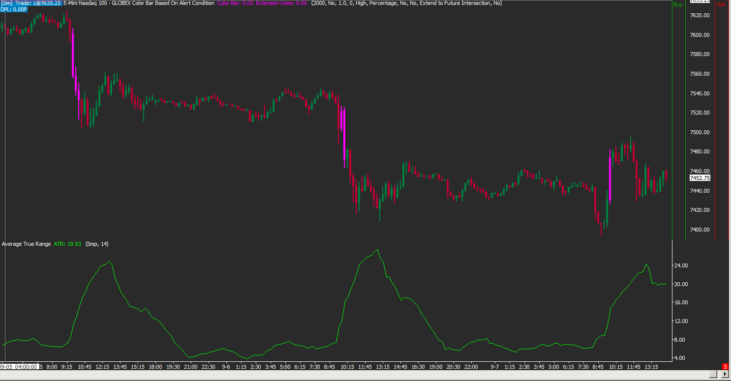

[2018-09-09 17:33:35]
Sawtooth - Posts: 4361
Sorry, formula should be:
=AND(H-L>2*ID2.SG1,H[-1]-L[-1]>2*ID2.SG1[-1])
The attached screenshot uses the above formula.
imageOpening ATR.PNG / V - Attached On 2018-09-09 17:33:23 UTC - Size: 42.08 KB - 576 views
