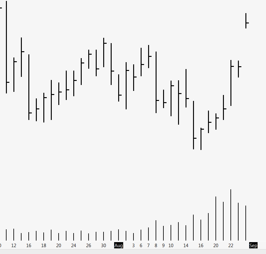

Hi. When I switch from 5min (intraday) into daily chart some bar anomaly appears. The last bar (today session) is incomplete also a bar before the last one coming from Aug 23. There are missing bars between Aug 23 and Aug 31. It looks like a download has failed. Attached the screenshot with the gap on the right. The instrument is F.US.CLEV18. The log has been sent for further analysis as well.
imageCL daily.png / V - Attached On 2018-08-31 19:38:56 UTC - Size: 16 KB - 432 views

This is the reason for the problem:
HTTPS connection to historicaldata.sierrachart.com:443 (45) | Creating socket. Using TLS 1.2. | 2018-08-31 21:44:46
HTTPS connection to historicaldata.sierrachart.com:443 (45) | Connecting to IP: 88.99.0.216. | 2018-08-31 21:44:46
HTTPS connection to historicaldata.sierrachart.com:443 (45) | Encryption stream error encountered when processing received data. Failed to read incoming decrypted data from the incoming binary I/O stream. error:14094410:SSL routines:ssl3_read_bytes:sslv3 alert handshake failure; error:140940E5:SSL routines:ssl3_read_bytes:ssl handshake failure | 2018-08-31 21:44:50
HTTPS connection to historicaldata.sierrachart.com:443 (45) | Initiating close of socket by core. | 2018-08-31 21:44:50
HD Request # 6 | Error downloading historical Daily data for F.US.CLEV18. HTTP error when downloading from SC Historical Data service | 2018-08-31 21:44:50
This is very unusual. It looks like something is interfering with the Internet connection from your location.
Try again by re-downloading the data in the chart by going to the chart and selecting "Edit >> Delete All Data and Download".

At this point we do not have an answer. We have never seen this before. It would appear as though there is something about your Internet connection which is causing a problem.
We need to look into this on Monday and see if there is anything we can determine from our side.

Make sure that you run Windows Updates and install the updates. Let us know if that solves the issue for you.
We think the issue has to do with certificate validation and there may be some dependency on the operating system store of certificate authority information.
