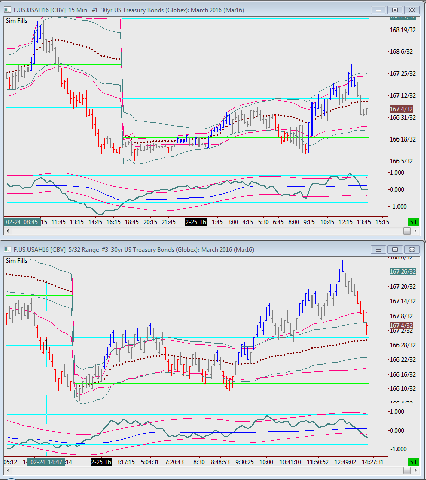

User83814 - Posts: 26
Hi I noticed inconsistency in ECIVWAP study. Please see attached screen shot. It shows bond futures charts on 15 min and 5 range, with brown dots as VWAP. From my understanding, VWAP should be the same regardless of time frame. Yet 15 min is above VWAP, and 5 range is below. Quite large difference. Can you please look into it?
Thank you
imageECIVWAP inconsistency.PNG / V - Attached On 2016-02-25 19:19:21 UTC - Size: 75.28 KB - 503 views

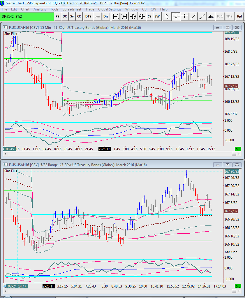

[2016-02-25 20:17:56]
Hi thanks for the quick the check. I checked again on my own, and still get a 10 tick difference. I'm using CQG feed and the 2 charts are duplicate of each other, except for the time frame difference.
I understand a little difference is expected, and everything is approximate. But 10 ticks off is alarming. That's why I asked.
Date Time Of Last Edit: 2016-02-25 20:23:03
imageECIVWAP inconsistency 2.PNG / V - Attached On 2016-02-25 20:22:28 UTC - Size: 108.4 KB - 507 views
[2016-02-25 20:30:06]
wwwingman - Posts: 185
I use IQFeed. And never saw such a difference of 10 ticks, even on much bigger time frames.
I suggest making a test with the Sierra Vwap. If it does the same thing, it probably mean
* your data feed volume per price is wrong.
Or,
* that something is wrong in the charts (for ex, session don't start at the same time, or that you don't have a new bar open on session start etc...).
-- W.
[2016-02-26 13:18:28]
I checked on my home PC last night. Everything worked fine. This morning I rolled bond futures to June contract, and it's working as expected. Strange though what I saw yesterday.
