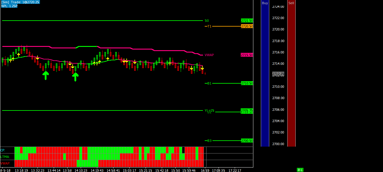

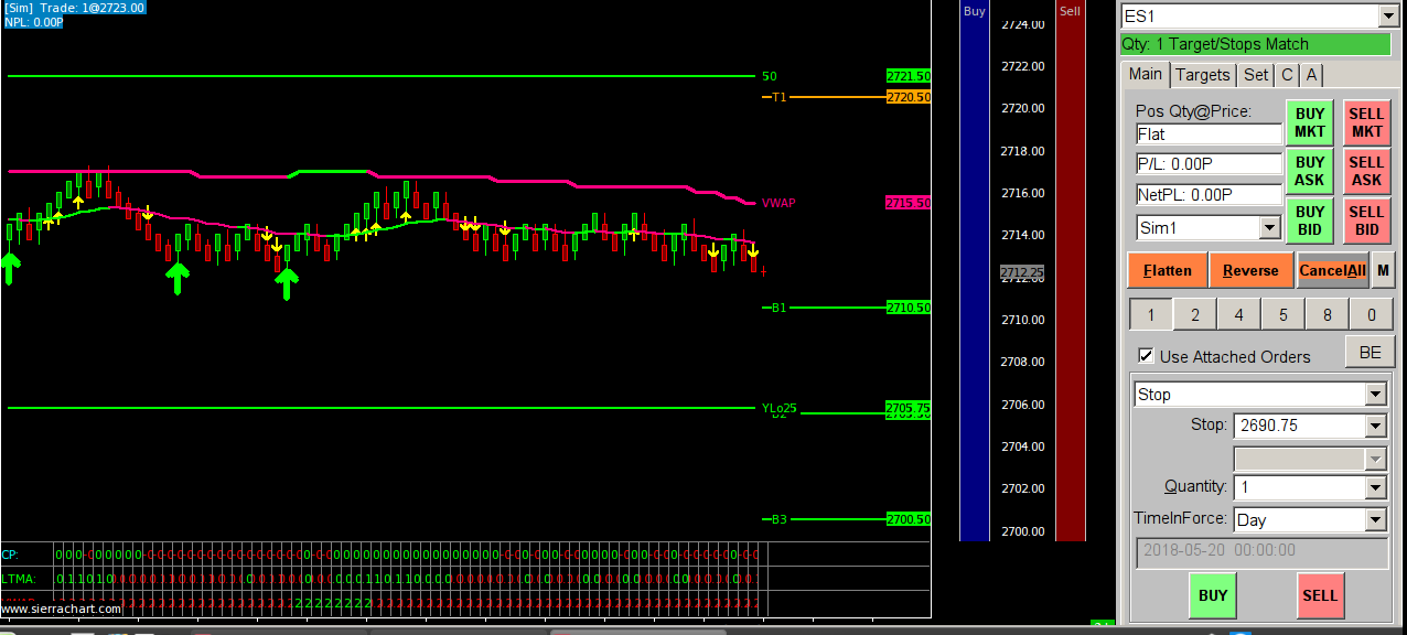

What would cause identical code for 64bit version to display the table differently than the 32 bit version? They were both remotely compiled minutes apart with the same code.
64 bit:
http://www.sierrachart.com/image.php?Image=1526736692301.png
32 bit
http://www.sierrachart.com/image.php?Image=1526736918235.png
Date Time Of Last Edit: 2018-05-19 14:20:14

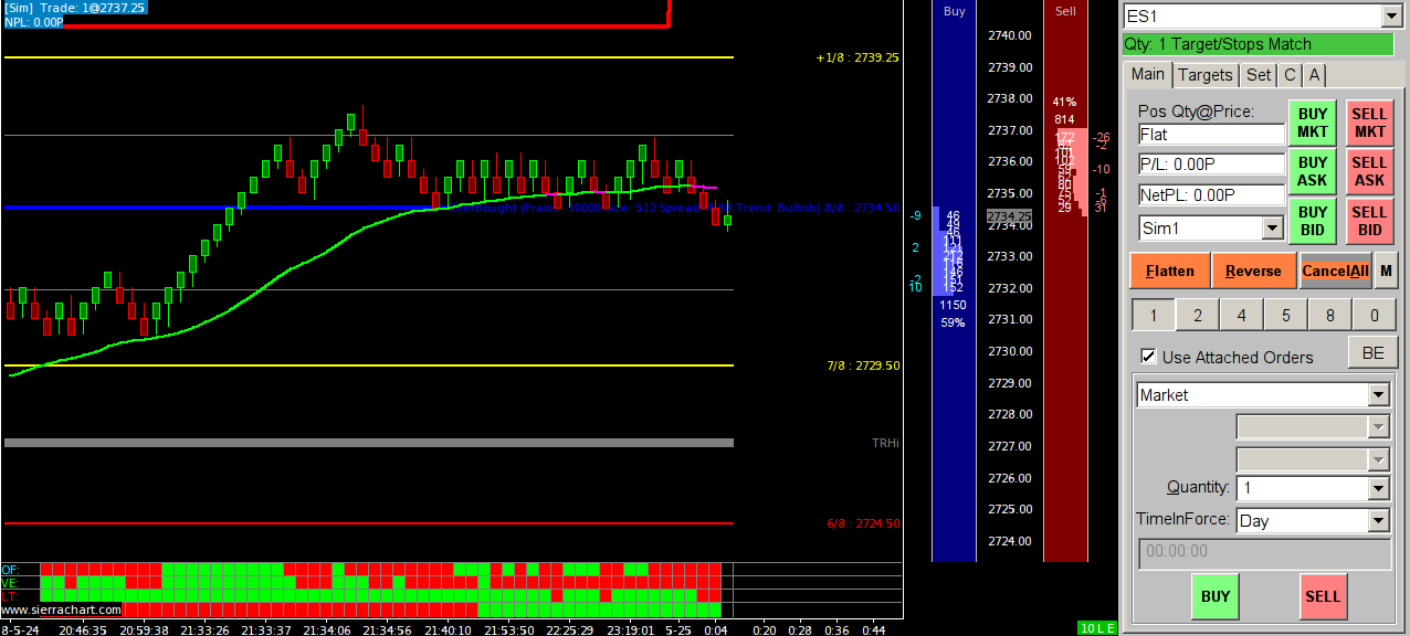

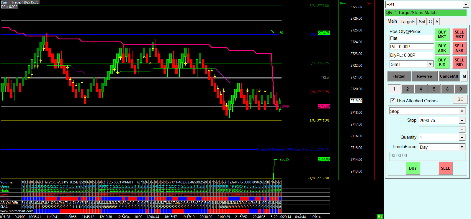

[2018-05-25 04:35:10]
ertrader - Posts: 701

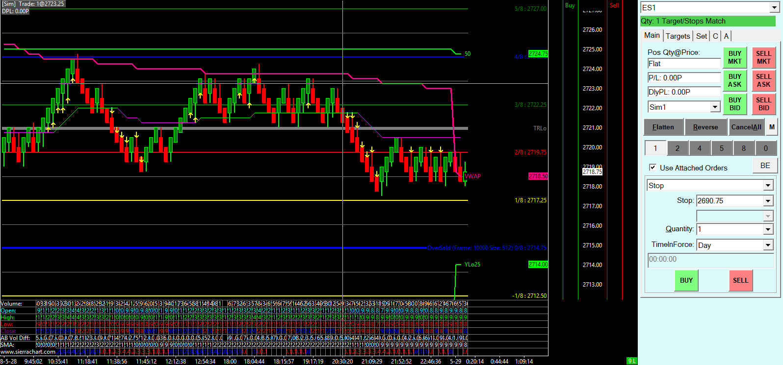

64 bit
http://www.sierrachart.com/image.php?Image=1527222826646.png
32 bit
http://www.sierrachart.com/image.php?Image=1527222896339.png

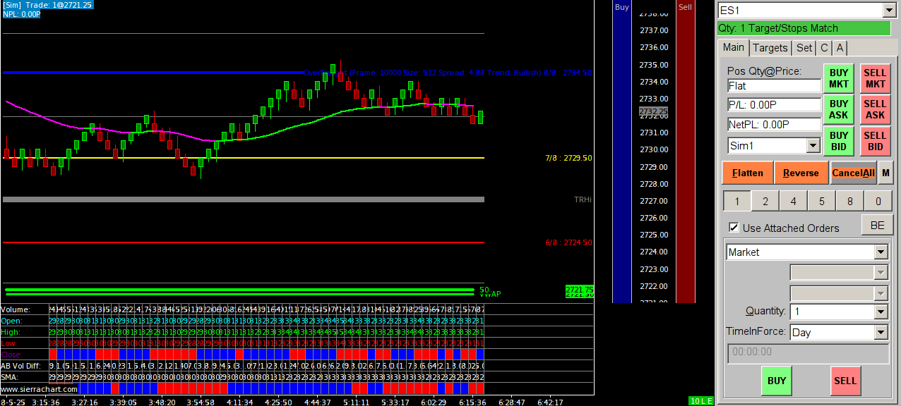

[2018-05-25 10:23:51]
Thank you, I will test. Just a few notes:
1) Attached is a version that is right from studies8.cpp with an added SMA slope to also demonstrate. This example version does not need to reference another study like my prior example.
2) Note the background issue on lines for close and SMA Slope in the 64 bit version. 32 bit looks good.
3) I have tested this issue on Windows 10 and under Mint Linux Wine. It is identical across OSs and on completely different computers.
4) This has been consistent across all 64 bit versions since you began offering a 64 bit version earlier this year. I just did not have time to follow up till now.

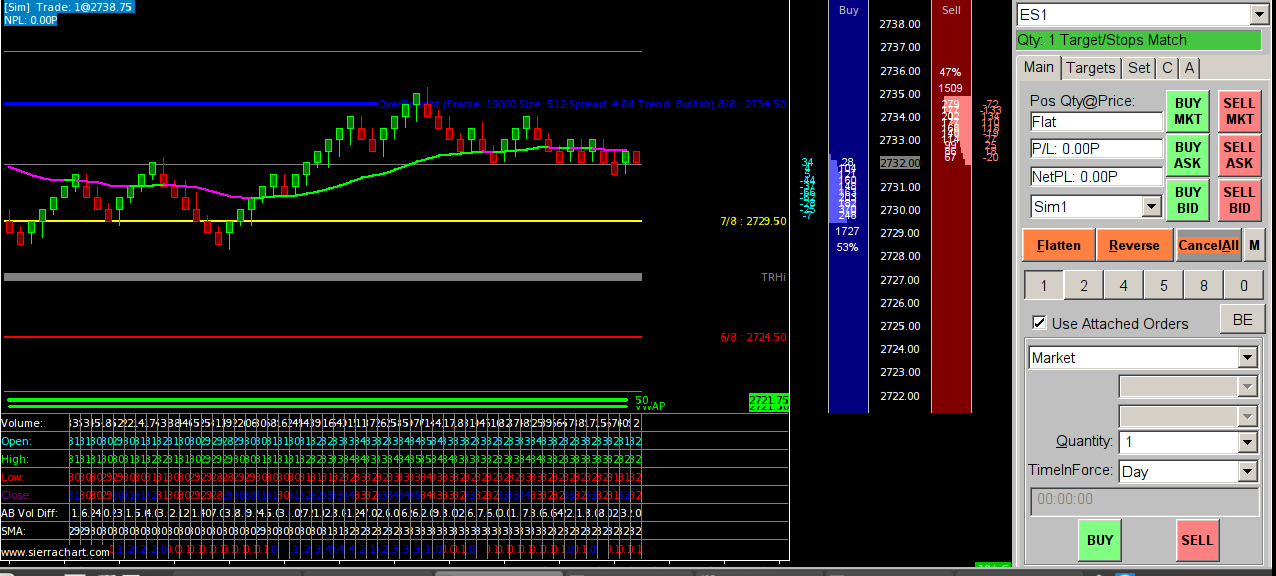

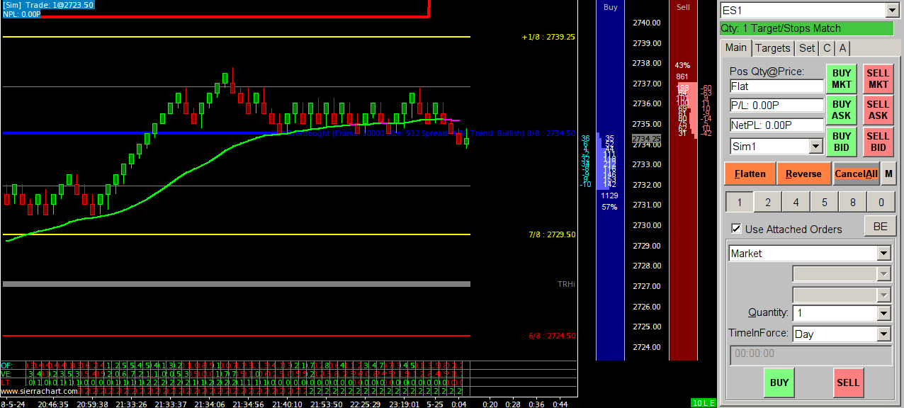

32 bit
http://www.sierrachart.com/image.php?Image=1527243624632.png
64 bit
http://www.sierrachart.com/image.php?Image=1527243747622.png
Date Time Of Last Edit: 2018-05-25 10:33:04
attachmentGrid.cpp - Attached On 2018-05-25 10:23:47 UTC - Size: 4.04 KB - 585 views

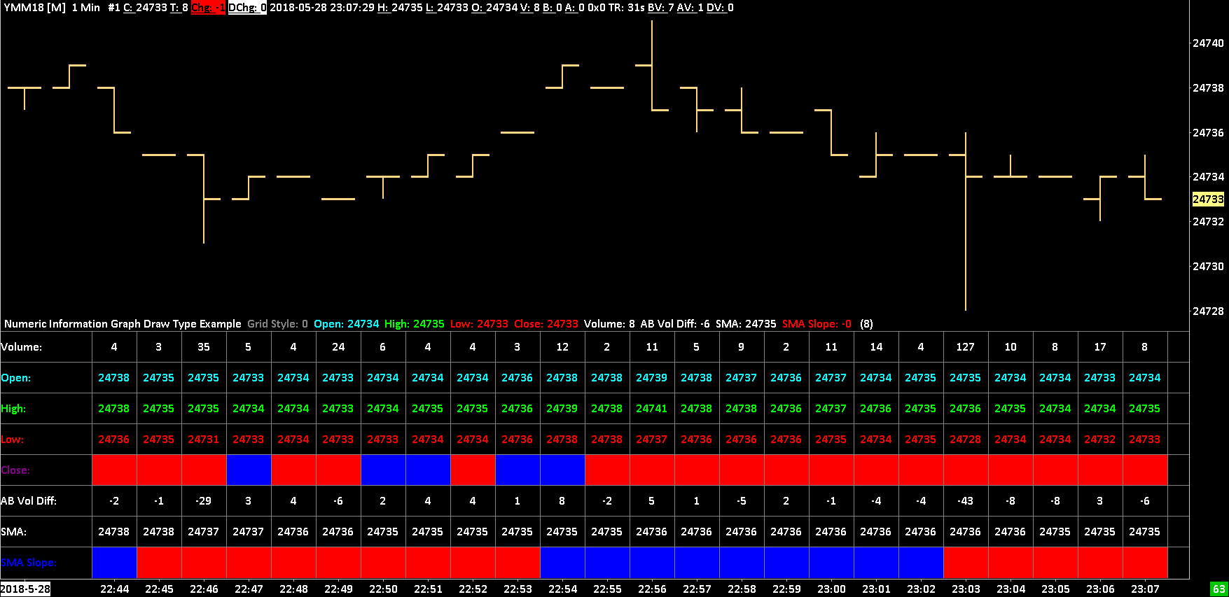

Thank you and appreciate you looking into this. A few additional pieces of information that may help:
1) I've compiled on 3 computers. All with the same result on 64 bit
2) 1 Windows 10 new Lenovo 920 with Intel 620 graphics, 1 Asus Older laptop with Nvidia, 1 Mint Linux 18.3 with AMD graphics and Wine 3.01 (also occurred with 3.0)
3) All three computers are clean installs of SC, NO local compiler had ever been installed
4) All are using remote rebuild
5) Another user has the same background issue
Numeric Information Graph Draw Type 32 vs 64
Date Time Of Last Edit: 2018-05-29 04:47:44
