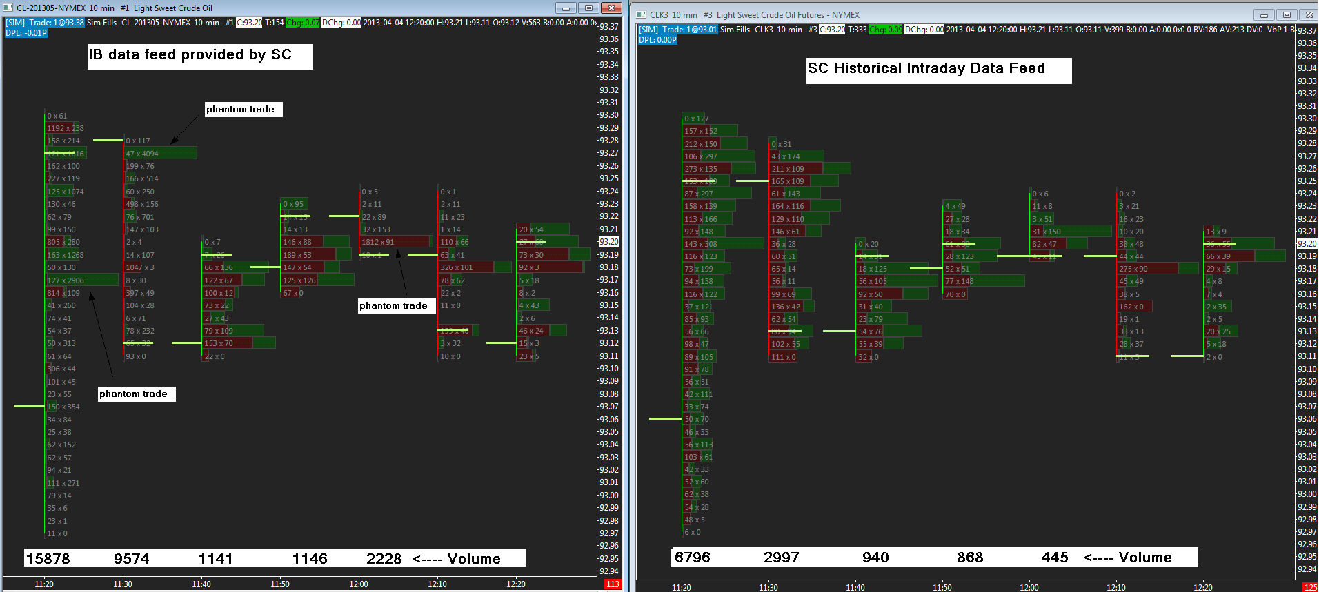

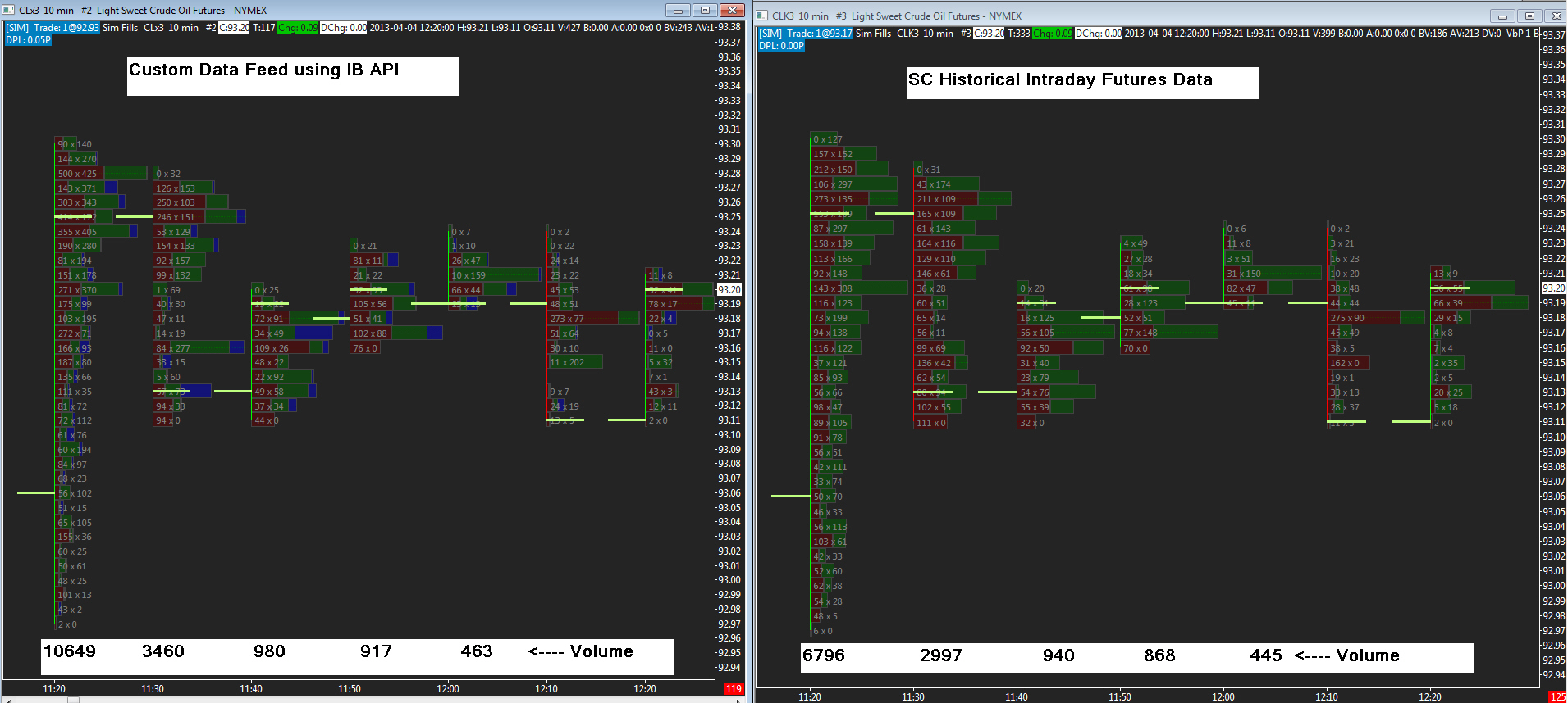

To measure the accuracy of the data feed, I have compared the feed to Sierra Chart's two data feed backfill services: SC Historical Data & SC Futures Backfill Data. Using the crude oil futures symbol, CL, I created 10 minute bars using the four different data feeds, and compared their volumes:
11:10am 11:20am 11:30am 11:40am 11:50am
SC real-time feed using IB data 15878 9574 1141 1146 2228
My custom real-time data feed using IB data 10649 3460 980 917 463
SC Historical Data (backfill) 10572 3462 979 908 463
SC Futures Backfill Data (backfill) 6796 3997 940 868 445
I found that none of the data feed matched exactly, including Sierra Chart's two historical data feeds. However the closest match is my custom data feed and SC historical data. Sierra Chart's r/t feed using IB data does not come close to matching any of the other feeds, and is consistently overstated. I believe the addition of phantom trades by SC is the cause of the large volume numbers.
I have attached two screen shots of the 10 minutes charts using the various data feed, showing the market profiles of the bars. The shots show that my custom data feed matches SC futures backfill data fairly closely, while Sierra Charts data feed using IB data does not.
I hope this information illustrates my point that a better data feed using Interactive Broker's data feed and API can be created. My programming skills as rather crude, so I am sure the SC developers would have not problem improving upon my attempt. I can submit details about the coding of the custom data feed if anyone is interested.

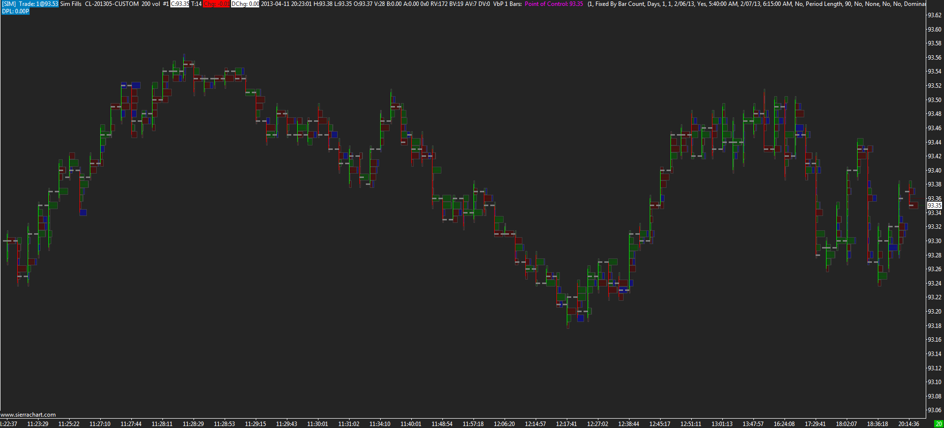

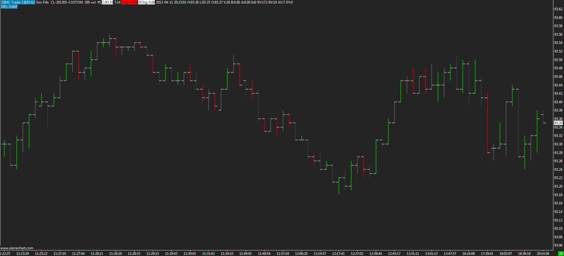

200V CL-201305-NYMEX chart for 4/11/13 as requested.
Pacific Std Time
http://www.sierrachart.com/image.php?l=1365746113917.png
http://www.sierrachart.com/image.php?l=1365745766150.png
-BD

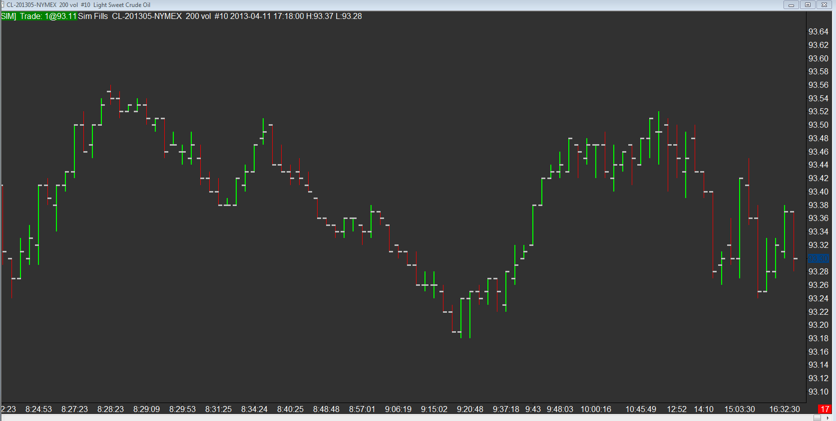

Tonkadad - Posts: 235
Thanks BD.
I attached a pic of my 200v chart.
imagetonkadad 200v CL.PNG / V - Attached On 2013-04-12 07:32:21 UTC - Size: 46.18 KB - 819 views
[2013-04-12 14:21:51]
Bad Dog - Posts: 17
RTVolume returns a string containing the following information:
Last trade price
Last trade size
Last trade time
Total volume
VWAP
Single trade flag (true or false).
See link for further info and example:
http://www.interactivebrokers.com/en/software/api/apiguide/tables/rtvolume.htm
