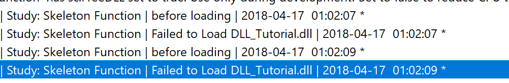

Andy Sureway - Posts: 93
Also I notice that the Log messages are generated twice each time the study is added.
For example the attached figure showed the messages were repeated by 2 seconds apart.
imageScreen Shot 2018-04-16 at 10.06.28 PM.png / V - Attached On 2018-04-17 05:08:10 UTC - Size: 30.92 KB - 700 views
[2018-04-17 05:23:35]
You must look at the return error from LoadLibrary and see what the problem is. That is not something we can help with.
[2018-04-17 05:59:55]
Thanks a lot! I just got the error code, which is 193 (0xC1) %1 is not a valid Win32 application. Looks like that there is something wrong with the dll file.
