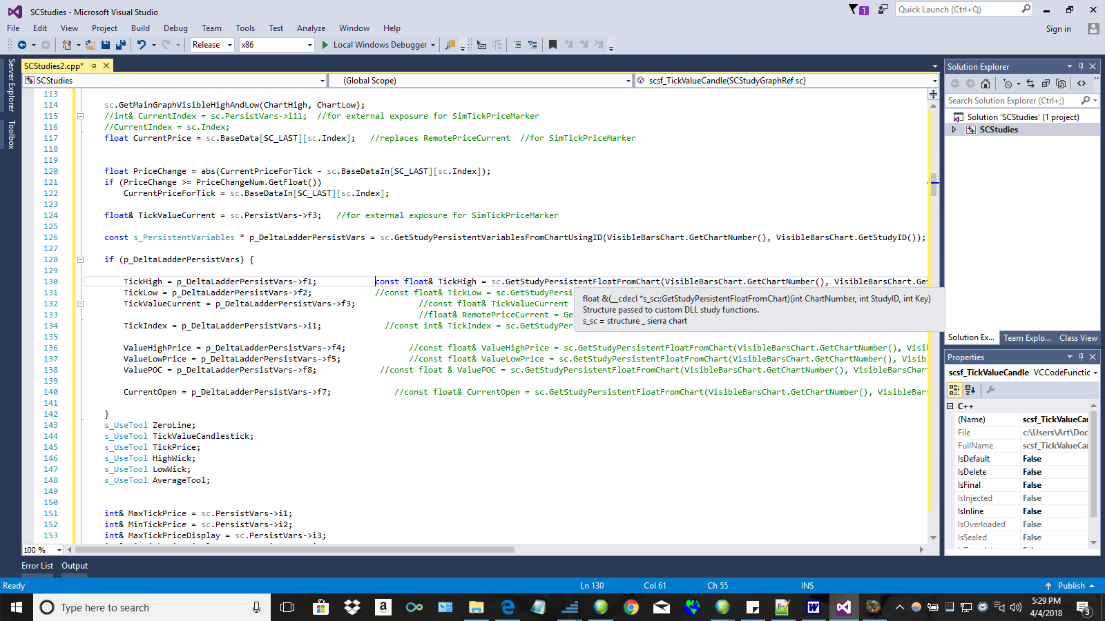

[2018-04-04 22:03:13]
WarriorTrader - Posts: 259
I have reverted back to how the old function and everything is working fine. It is time for me to move on. Please keep sc.GetStudyPersistentVariablesFromChartUsingID available even if it is not documented.
  const s_PersistentVariables * p_DeltaLadderPersistVars = sc.GetStudyPersistentVariablesFromChartUsingID(VisibleBarsChart.GetChartNumber(), VisibleBarsChart.GetStudyID()); //ChartStudyInput.GetStudyID() Delta Ladder
  if (p_DeltaLadderPersistVars) {
    TickHigh = p_DeltaLadderPersistVars->f1; //const float& TickHigh = sc.GetStudyPersistentFloatFromChart(VisibleBarsChart.GetChartNumber(), VisibleBarsChart.GetStudyID(), 1); //TickHigh = p_DeltaLadderPersistVars->f1;
    TickLow = p_DeltaLadderPersistVars->f2; //const float& TickLow = sc.GetStudyPersistentFloatFromChart(VisibleBarsChart.GetChartNumber(), VisibleBarsChart.GetStudyID(), 2); //TickLow = p_DeltaLadderPersistVars->f2;
    TickValueCurrent = p_DeltaLadderPersistVars->f3; //const float& TickValueCurrent = sc.GetStudyPersistentFloatFromChart(VisibleBarsChart.GetChartNumber(), VisibleBarsChart.GetStudyID(), 3); //TickValueCurrent = p_DeltaLadderPersistVars->f3;
                                   //float& RemotePriceCurrent = GetStudyPersistentFloatFromChart(VisibleBarsChart.GetChartNumber(), VisibleBarsChart.GetStudyID(), 4); //RemotePriceCurrent=p_DeltaLadderPersistVars->f4;
    TickIndex = p_DeltaLadderPersistVars->i1; //const int& TickIndex = sc.GetStudyPersistentIntFromChart(VisibleBarsChart.GetChartNumber(), VisibleBarsChart.GetStudyID(), 1); //TickIndex = p_DeltaLadderPersistVars->i1; //will be replaced with sc.Index //for SimTickPriceMarker
    ValueHighPrice = p_DeltaLadderPersistVars->f4; //const float& ValueHighPrice = sc.GetStudyPersistentFloatFromChart(VisibleBarsChart.GetChartNumber(), VisibleBarsChart.GetStudyID(), 4);
    ValueLowPrice = p_DeltaLadderPersistVars->f5; //const float& ValueLowPrice = sc.GetStudyPersistentFloatFromChart(VisibleBarsChart.GetChartNumber(), VisibleBarsChart.GetStudyID(), 5);
    ValuePOC = p_DeltaLadderPersistVars->f8; //const float & ValuePOC = sc.GetStudyPersistentFloatFromChart(VisibleBarsChart.GetChartNumber(), VisibleBarsChart.GetStudyID(), 6);
    CurrentOpen = p_DeltaLadderPersistVars->f7; //const float& CurrentOpen = sc.GetStudyPersistentFloatFromChart(VisibleBarsChart.GetChartNumber(), VisibleBarsChart.GetStudyID(), 7);
const float PersistentValue = sc.GetStudyPersistentFloatFromChartStudy(ChartStudyReference.GetChartNumber(), ChartStudyReference.GetStudyID(), 1);
The code you just posted could NOT possibly compile. The function in question has a return type of a reference to a float – float & - not a return type of float. I included a screen shot of my Visual Studio
showing the return type of the function.
Anyway, looks like I am the only one using this advanced feature since it has been years since this function was developed but no one complained.
The thing is if someone else who is new to SC tries the function, instead of posting a message on support, they will just move on to something else.
SC is on the cutting edge of trading software, making things like bid/ask data availably 10 years before other popular trading software (Ninja).
The new version is very fast and responsive. Keep up the good work.

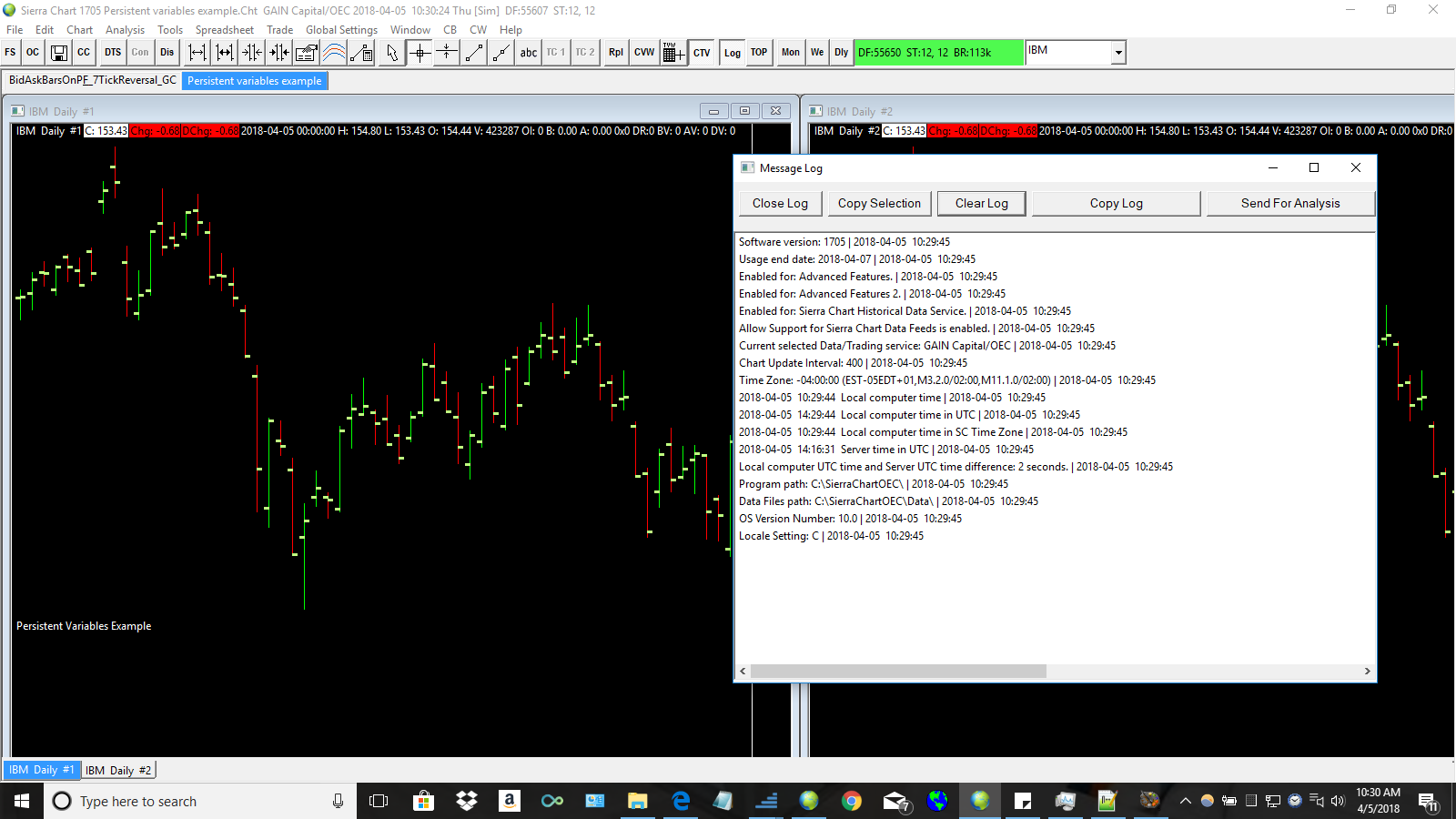

[2018-04-05 04:01:45]
Yes it does compile and the reference does not have to be placed into a reference. A copy is just fine. There was no need for a reference in the example.
Hopefully you really do not think there is a genuine problem, and that we are releasing functionality that just does not work. The way this functionality works internally is very simple and well-established and does work properly.
Attached is a test chart book demonstrating this.
In chart #1, go to Chart >> Recalculate and after you do that look at the Message Log. You will see Chart #2 automatically calculate and display the value of the persistent variable each time.
In the next release the example has been updated to use sc.UpdateAlways and increment the persistent variable.

[2018-04-05 14:46:14]
Here are my screen shots before and after following your directions.
Using v1705
It does recalculate but there is no output.
Thx,
--WT
imagePersisVarType2.png / V - Attached On 2018-04-05 14:43:09 UTC - Size: 98.53 KB - 508 views
imagePersisVarType3..png / V - Attached On 2018-04-05 14:43:24 UTC - Size: 104.97 KB - 520 views
[2018-04-05 15:52:50]
It is possible that the particular test functions we used might have been renamed in the latest version and are not going to work in the version you are running. Although we do not see any evidence of that in the Message Log unless it were cleared. Update to the latest prerelease and test again.
However, still the ACSIL (sc.) functions being used for getting persistent variables from another chart and study, internally have not changed and have always worked properly.

[2018-04-05 20:09:21]
Can you post the code for the example? Still getting zeros with sc.GetStudyPersistentFloatFromChartStudy. Should I replace sc.PersistVars?
const float TickHigh = sc.GetStudyPersistentFloatFromChartStudy(VisibleBarsChart.GetChartNumber(), VisibleBarsChart.GetStudyID(), 1);
Source:
  float& TickHigh = sc.PersistVars->f1;
  float& TickLow = sc.PersistVars->f2;
  //float& PriceForTickCandle=sc.PersistVars->f3;
  float& PriceForTickCandleCurrent = sc.PersistVars->f3;
  int& TickIndex = sc.PersistVars->i1;
  float& ValueHigh = sc.PersistVars->f4;
  float& ValueLow = sc.PersistVars->f5;
  float& ValuePOC = sc.PersistVars->f6;
  float& CurrentOpen = sc.PersistVars->f7;
  if (CandleType.GetIndex() == 1) {
Thx,
WT
[2018-04-05 20:31:53]
OK getting rid of sc.PersistVars did the trick. Thanks for your help.
