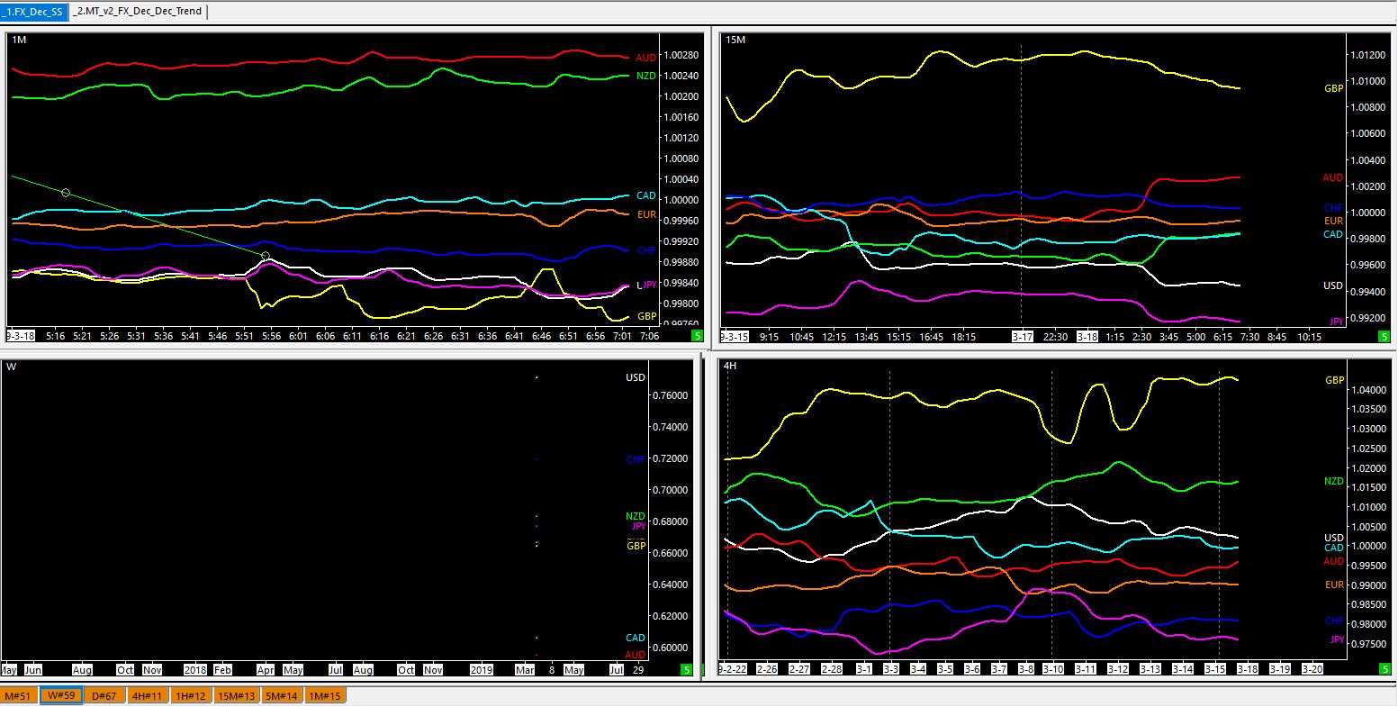

ILIM KIRGIZ - Posts: 187
Hi Kiwi,
I'm using this study because I have an issue with historical charts(attached screenshot shows it) when I put my computer into sleep mode and wake it up.
I tried to compile this code with version 1882 32bit but I've got below error.
What would be your suggestion to overcome this?
Thanks.

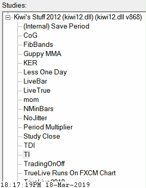

Willson - Posts: 176
Ok The Study is named TI, not T1, It slices part of a signal and displays it. I use it to slice certain portions of $Tick and then use the sliced out amplitude in other charts. I cant seem to get images to display in this reply. (never done it before) Internal parameters to set are CutOff1, and CutOff2. That is all. I could send images thru email if feasible. OK now that I posted, I see the image.
Date Time Of Last Edit: 2019-03-18 23:56:05

Kiwi - Posts: 375
OK. I found it here
Kiwi Resync Study - Memory leak?
I added it to kiwi_test.cpp & compiled it for 64 bit. I would imagine it should behave the same way as it used to but its years since I looked at it so you'll need to test it.
