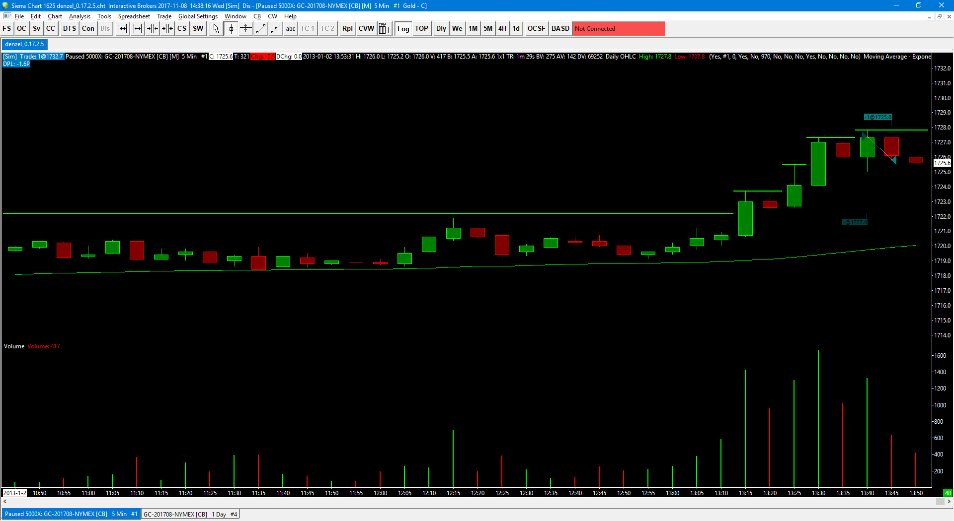

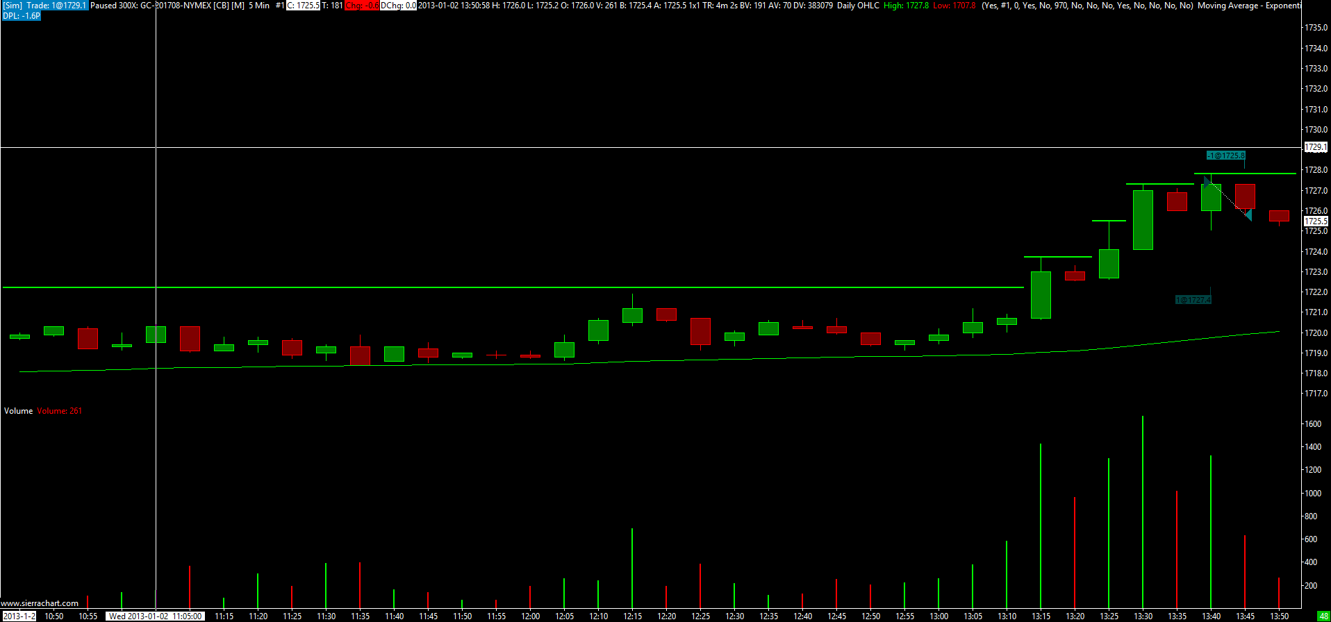

I have StopLimit order with TriggeredTrailingStop order attached with trigger price offset set, but Stop order starts to trail immediately. Strategies built on v1614 and before worked well with same code (at the moment using version 1635)
s_SCNewOrder NewOrder;
NewOrder.OrderQuantity = (unsigned int) OrderAmount;
NewOrder.OrderType = SCT_ORDERTYPE_STOP_LIMIT;
NewOrder.AttachedOrderStop1Type = SCT_ORDERTYPE_TRIGGERED_TRAILING_STOP_3_OFFSETS;
NewOrder.TriggeredTrailStopTriggerPriceOffset = TicksForTrailingStopLoss * sc.TickSize;
NewOrder.TriggeredTrailStopTrailPriceOffset = TrailingStopTickDistance * sc.TickSize;
NewOrder.TimeInForce = SCT_TIF_GTC;
NewOrder.Price1 = HighData[sc.Index-1] + OrderHighLowOffset * sc.TickSize;
NewOrder.Price2 = NewOrder.Price1;
NewOrder.Stop1Price = NewOrder.Price1 - StopLoss * sc.TickSize;
Result = sc.BuyEntry(NewOrder);
Attached order has following parameters set:
Price1: 1727.4, Price2: 1727.4
Type: 9, TriggerOffset: 2.000000, TrailOffset: 0.200000, StopPrice: 1725.40
It starts trailing immediately, even before fullfilling the Offset (it should trail after hitting 1729.4)
imagePaused 300X GC-201708-NYMEX [CB] [M] 5 Min #1 2017-11-07 .png / V - Attached On 2017-11-07 12:19:12 UTC - Size: 48.37 KB - 572 views
attachmentTradeActivityLog.txt - Attached On 2017-11-07 12:21:33 UTC - Size: 3.79 KB - 577 views

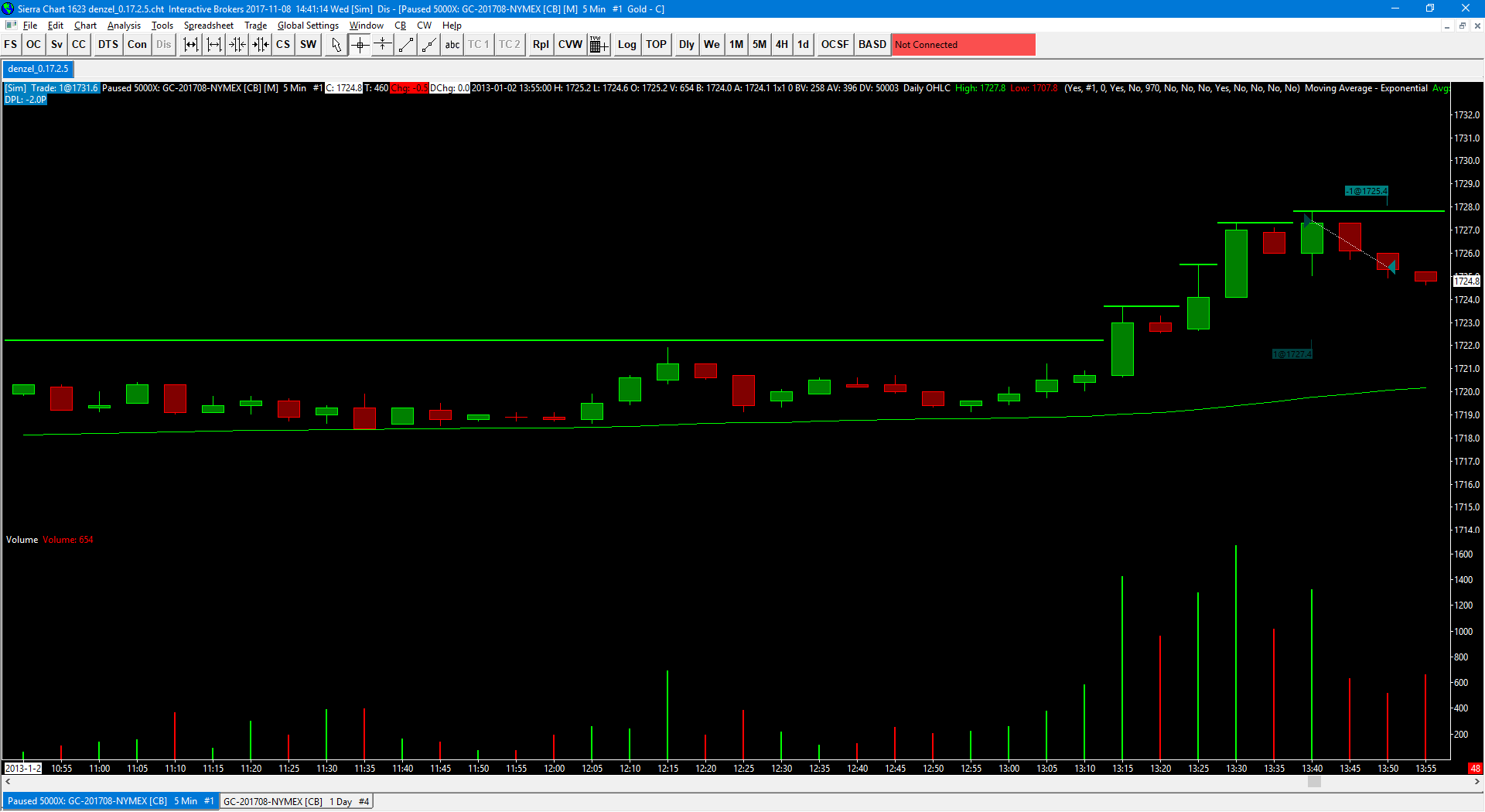

[2017-11-08 13:44:13]
User287992 - Posts: 51
Neither we did any changes. We didnt even rebuilt the strategy.
I have run one chart (study in there is built on 1608) unchanged between SC versions and there is behavior change between versions 1623 and 1625
1623 - works
1625 - incorrect trailing behavior
Date Time Of Last Edit: 2017-11-08 13:44:46
imageSC_1623.png / V - Attached On 2017-11-08 13:43:40 UTC - Size: 53.78 KB - 602 views
imageSC_1625.png / V - Attached On 2017-11-08 13:43:43 UTC - Size: 54.74 KB - 481 views
