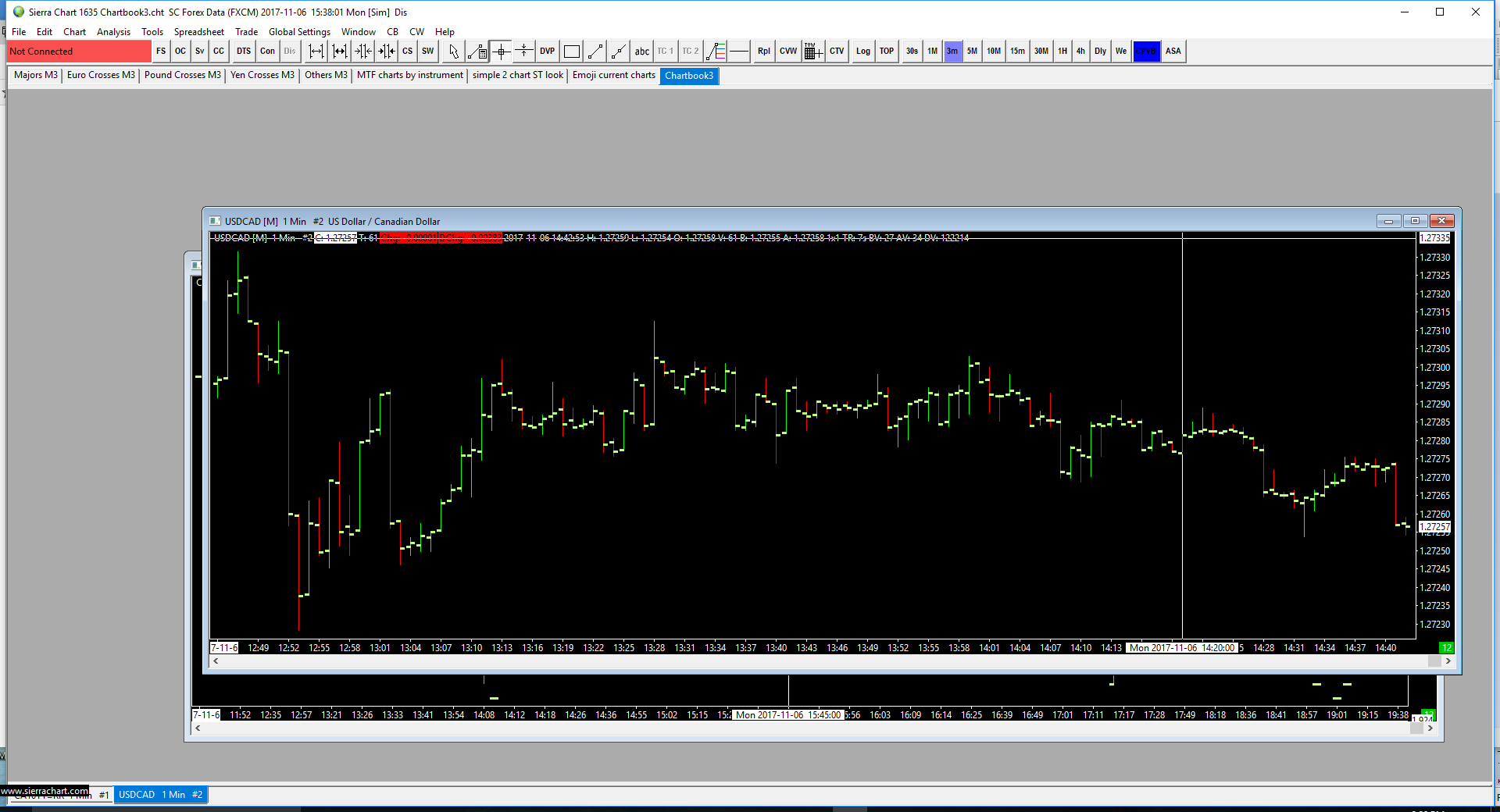

http://www.sierrachart.com/image.php?Image=1510000683404.png
I double-checked the format and time settings that you mention. I even did an update of the import, so I have "new" data to confirm that I continue to get the same type of result. I also confirmed that the standard charts use global time setting and the chart produced from the imported csv data also uses global time setting. But while my standard charts properly show current New York time zone time which matches my PC time, the chart for the csv data shows 5 hours ahead.
The data from the csv file seems to be represented perfectly with all data charted against the time for the record. The only problem is that the chart for imported data all so times 5 hours ahead of all my other charts.
