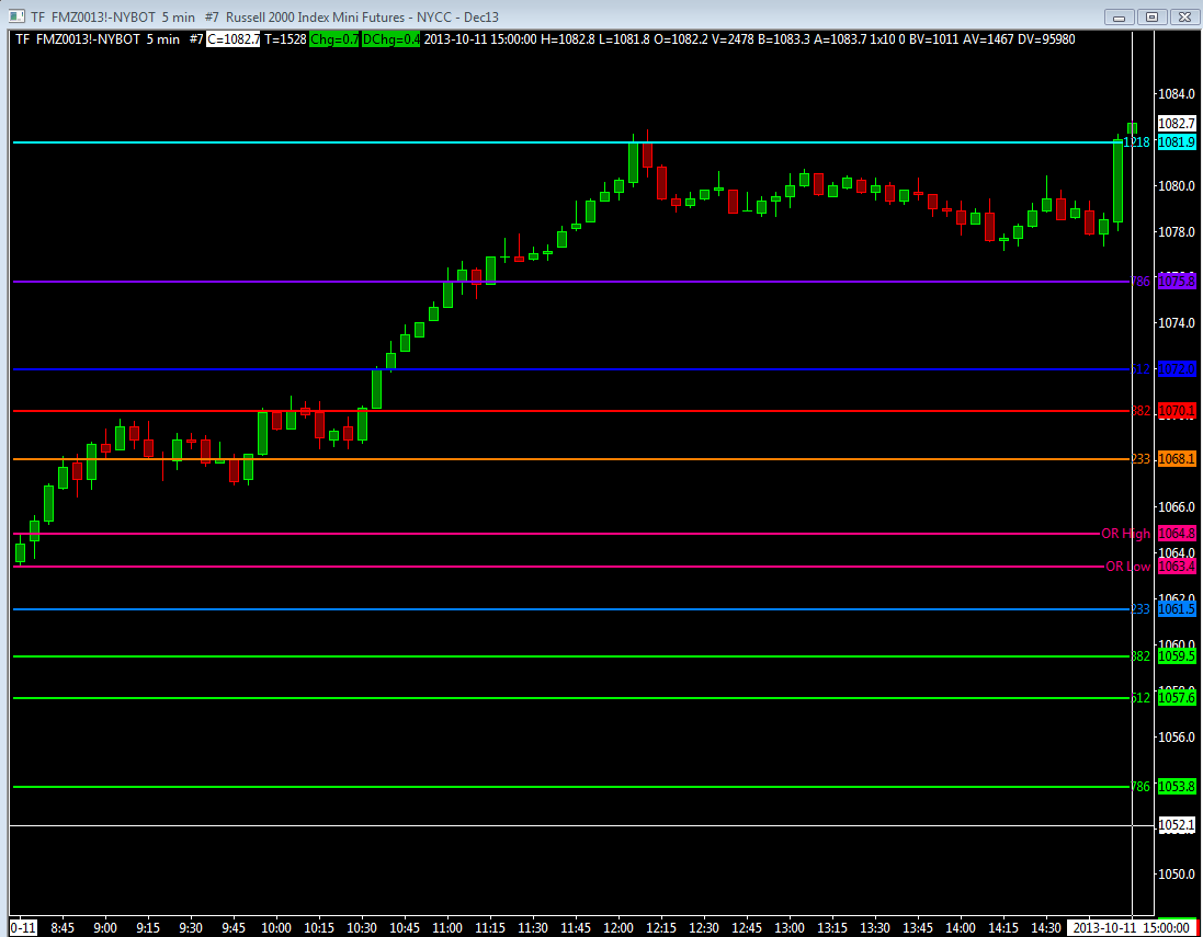

http://www.sierrachart.com/image.php?l=1381517057292.png = ganz open range
http://www.sierrachart.com/image.php?l=1381517238592.png = Fibonacci grid
http://www.sierrachart.com/image.php?l=1381517660399.png = color coded grid to see easier
i got it working, a few things though
1) i cant figure out at all how to make the extensions (study subgraph multiply/add/divide/std dev none of those work correctly).. the extensions in the initial balance study would work if they knew which side to plot on.. i could use 1.33, 2.82, etc for positive side and -2.33, -3.82, etc. for negative side
2) it looks like if the extensions did work, they wouldn't be able to differentiate between a positive/negative 5 min open range to know which side they should plot on.. if i am wrong plz explain to me what to do
thanks again for your patience
[2013-10-11 19:19:23]
ganz - Posts: 1048
Trade2day1
thnx 4 the explanation. now i can see as it should be.
i'm interested to get it working and i'll be back w the >beta 3<
[2013-10-11 19:23:20]
M5amhan - Posts: 468
haha ok, you're awesome
it is a great tool to use for targets and trend bias, even support/resistance sometimes

[2013-10-12 20:06:44]
User76055 - Posts: 18
Trade2day1
Got it working! I've also looked at NQ for these setups and has done well, knowing my luck it will fail when I go live lol...cheers!
Date Time Of Last Edit: 2013-10-12 20:08:02
imageTF 5min Open Range Chart.png / V - Attached On 2013-10-12 20:07:56 UTC - Size: 40.04 KB - 986 views
[2013-10-12 20:13:03]
well thanks to ganz for being so awesome, i was able to run statistics on the probabilities of price hitting these extensions during the pit session. they are very compelling, of course you still need an entry system to compliment these targets.
http://www.sierrachart.com/image.php?l=1381542568892.png = crude oil
http://www.sierrachart.com/image.php?l=1381542885143.png = russell 2000
http://www.sierrachart.com/image.php?l=1381543389587.png = S&P 500
i knew how high the probability was of hitting these targets already just from using it for a while, but seeing it visually like this really should hold you accountable to hold your winners and trail stops in a way to give price a chance to hit the targets
a tip on the time frame, if you are using tick charts it will only calculate correctly using 1000t or less.. i don't know why, but that's what i found out
Date Time Of Last Edit: 2015-04-20 16:49:07
