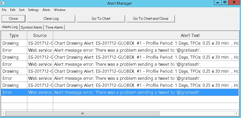

Hi, the first picture is my account enable for twitter handle and the second picture is the alert log showing error with the twitter handle i previously successfully registered. Please see attached photos:
imagesc_tweet1.jpg / V - Attached On 2017-09-21 16:59:57 UTC - Size: 67.69 KB - 597 views
imagesc_tweet2.jpg / V - Attached On 2017-09-21 17:00:05 UTC - Size: 166.03 KB - 617 views

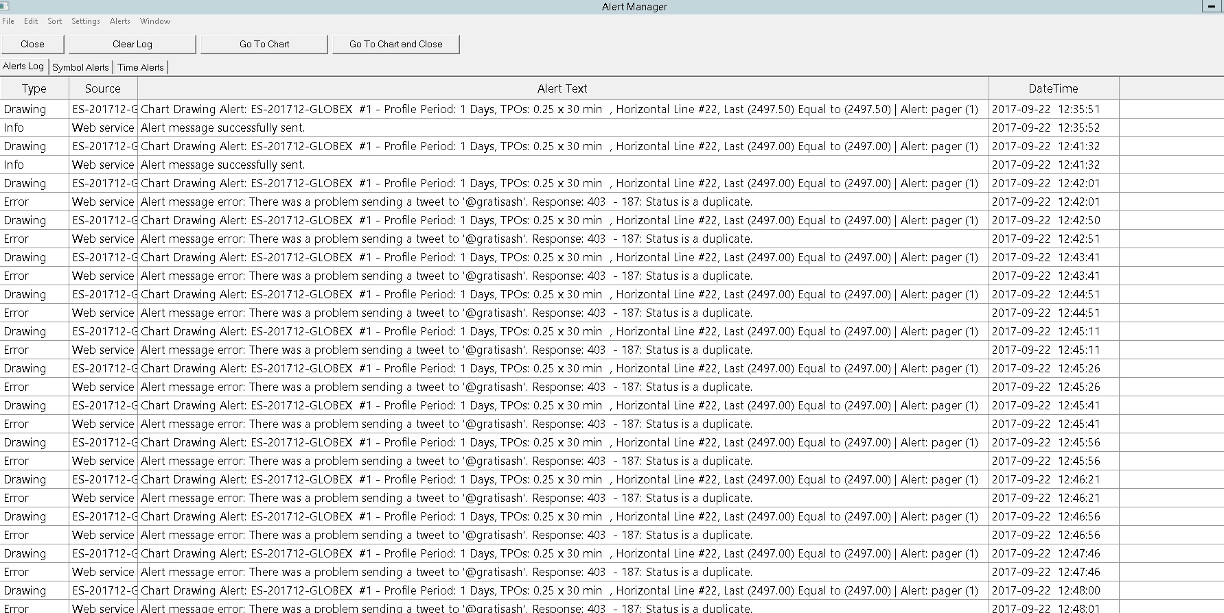

Ok, I just did a test with a horizontal line "equal to" alert. The first and second were successful but the rest had fail with some duplicate error seen in picture attached. Normally I would NOT set a line alert that triggers a lot, so if there is a duplicate or time limited, I need to know so that it makes sense. For example, after 1 minutes, the duplicate should reset. In the picture I let it run from 12:35 to 12:48 and there was no duplicat reset. Or if duplicate is base on the alert text pattern, then the type of horizontal line always send the same text, so maybe include timestap in the alert text?
imagesc_tweet3.jpg / V - Attached On 2017-09-22 16:53:36 UTC - Size: 759.32 KB - 563 views

Got ver 1616, still same twitter duplicate issue that began this thread, see attached picture, I marked in RED, the 20 mins apart of the two alerts and yet still duplicate. Perhaps, Twitter checks only for first 160 characters for duplicate text pattern. Also notice what you added "Bar Date-Time" of Text Alert pattern IS NOT the actual date-time of the alert that I marked in RED at the far right!!!
imagesc_twitter4.png / V - Attached On 2017-09-29 17:29:56 UTC - Size: 36.05 KB - 508 views

Hi, who asked for Bar Date-Time? The issue was a date stamp was needed so twitter doesn't give duplicate as seen in this thread. You proposed Bar Date-Time as a possible solution and it doesn't work. You can see from last picture, my chart is 30 minutes TPO daily chart and the Bar Date-time gives only that 9:30am start of the whole TPO chart and not the 30 minutes bar. So you propose Bar Date-time as a solution and it has nothing to do with the solution! Twitter is seeing duplicate alert message when the first 160 character of alert text pattern is the same. Why can't you just think of the big picture of implementing the Twitter alert correctly instead of getting stuck with defending the Bar Date-time, which has nothing to do with the issue I raised since the beginning! Surely you saw some value with the Twitter alert so included it in the first place! Please make it work correctly. Thank you.
