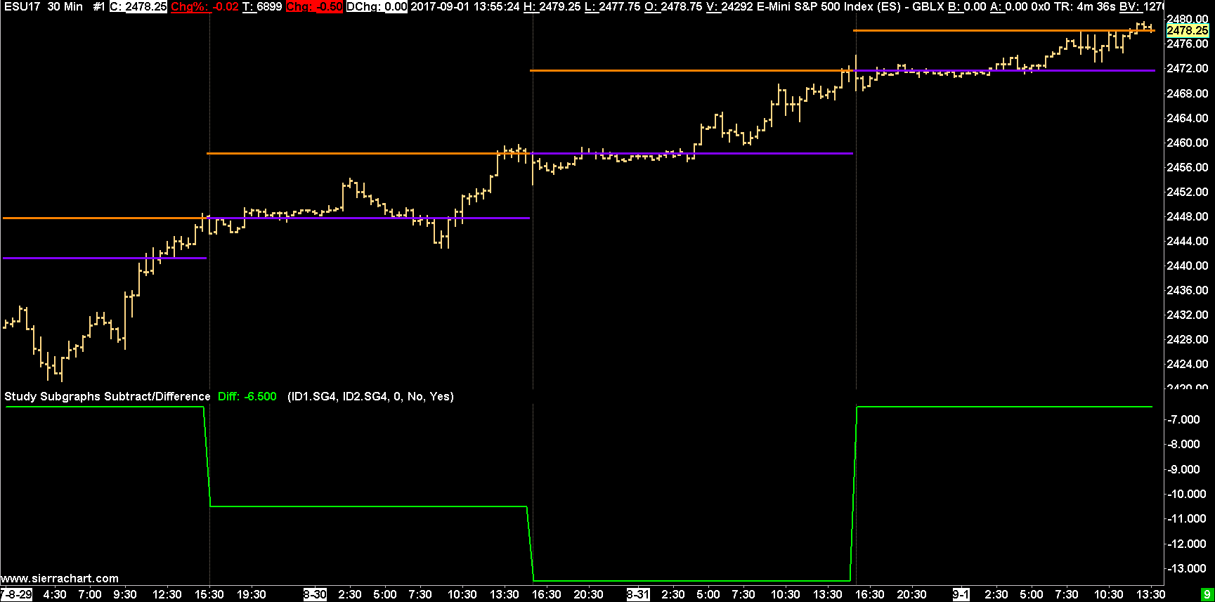

[2017-09-01 18:41:38]
We have prepared a Study Collection to accomplish what you want:
http://www.sierrachart.com/image.php?Image=1504290339783.png
It is attached.
Here are the instructions to use it:
http://www.sierrachart.com/index.php?page=doc/StudyCollections.html#UsingStudyCollectionProvidedBySierraChartSupport
Also you have the ability to edit a post by clicking the "Edit" link at the lower right of the post.

[2017-09-07 18:53:16]
When posting an image of a chart, always use this method here:
For the Daily OHLC study which displays the current price, set the study Input Graph Open and Close Historically to Yes.
Date Time Of Last Edit: 2017-09-07 18:54:38
